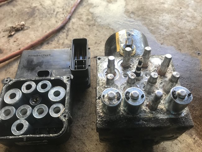

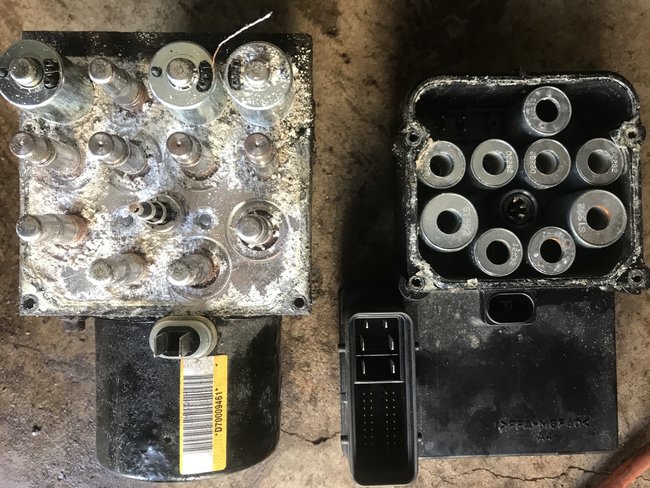

Since the entire system was opened, you likely need to do an automated bleed on the unit.
There are two different system. One with StabiliTrak and without. I need you to do the following. Look at the RPO sticker on the underside of the spare tire cover. You are looking for a JL4 rpo. If it's there, you have stabilitrak.
I will provide the directions for both. First is with JL4.

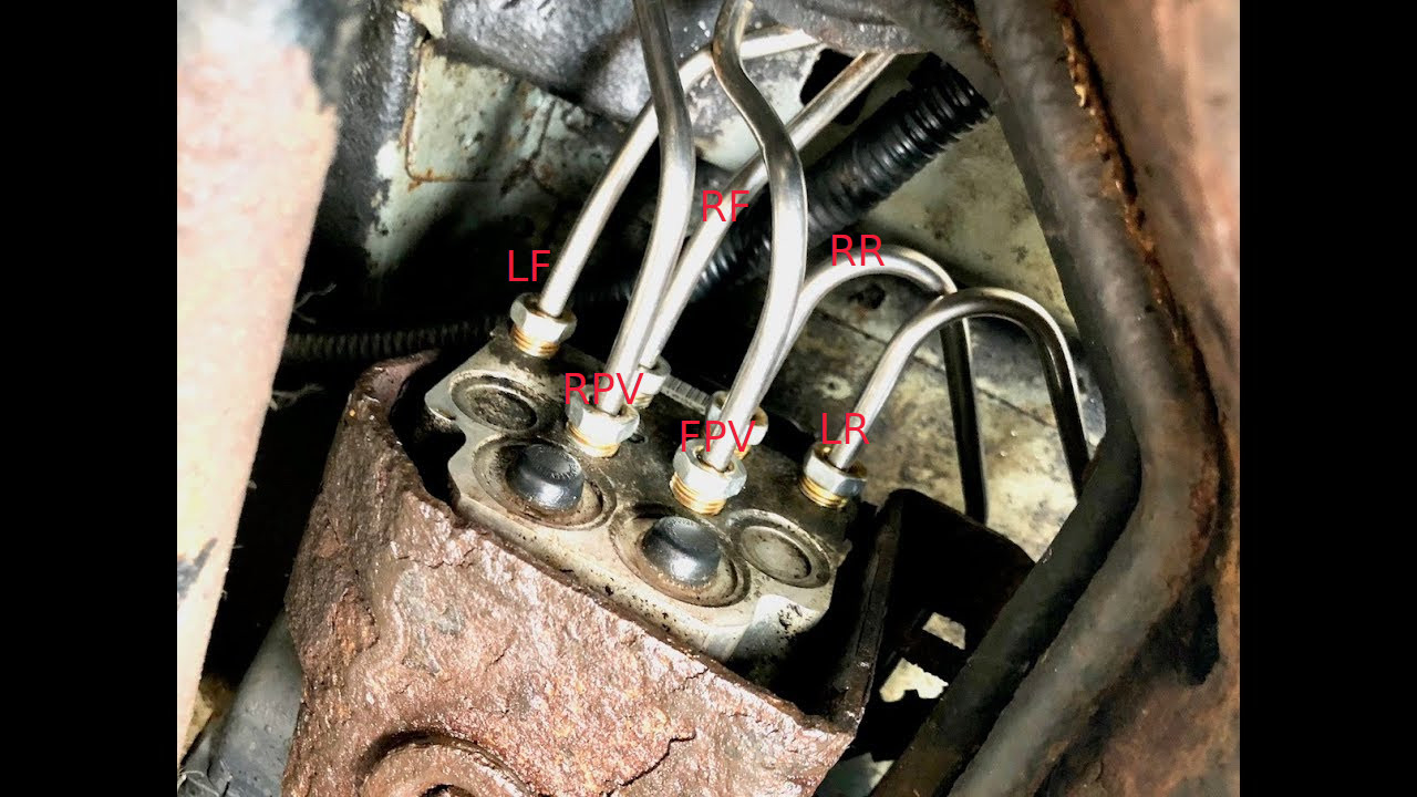

I have one more thought. When bleeding the brakes, make sure to start at the wheel furthest from the master cylinder. That would be the right rear. Then, go to the left rear, right front, and last is the left front. Here is a link that discusses the basic procedures.
https://www.2carpros.com/articles/how-to-bleed-or-flush-a-car-brake-system
I wish I had an easier answer, but I feel this is likely what will fix the issue.
Let me know if this helps.
