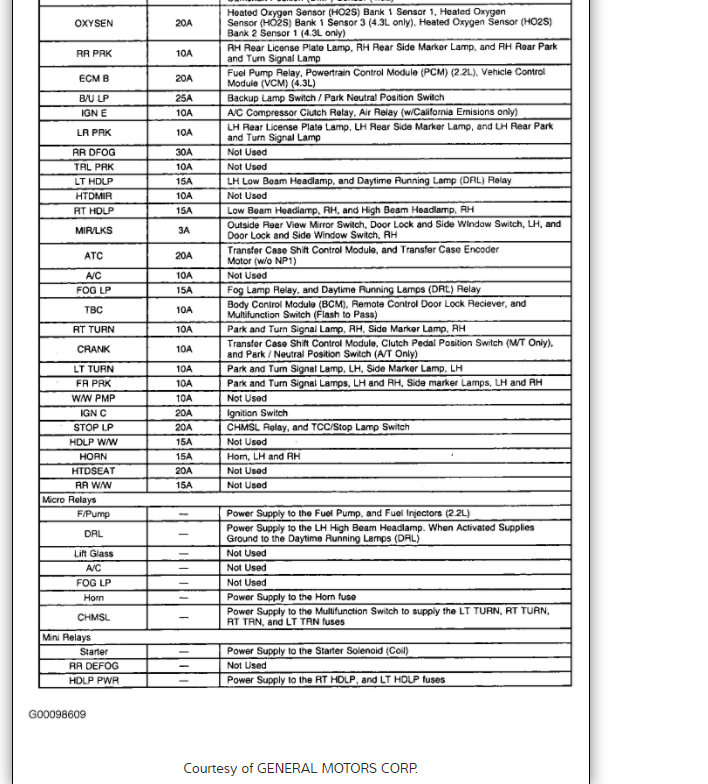

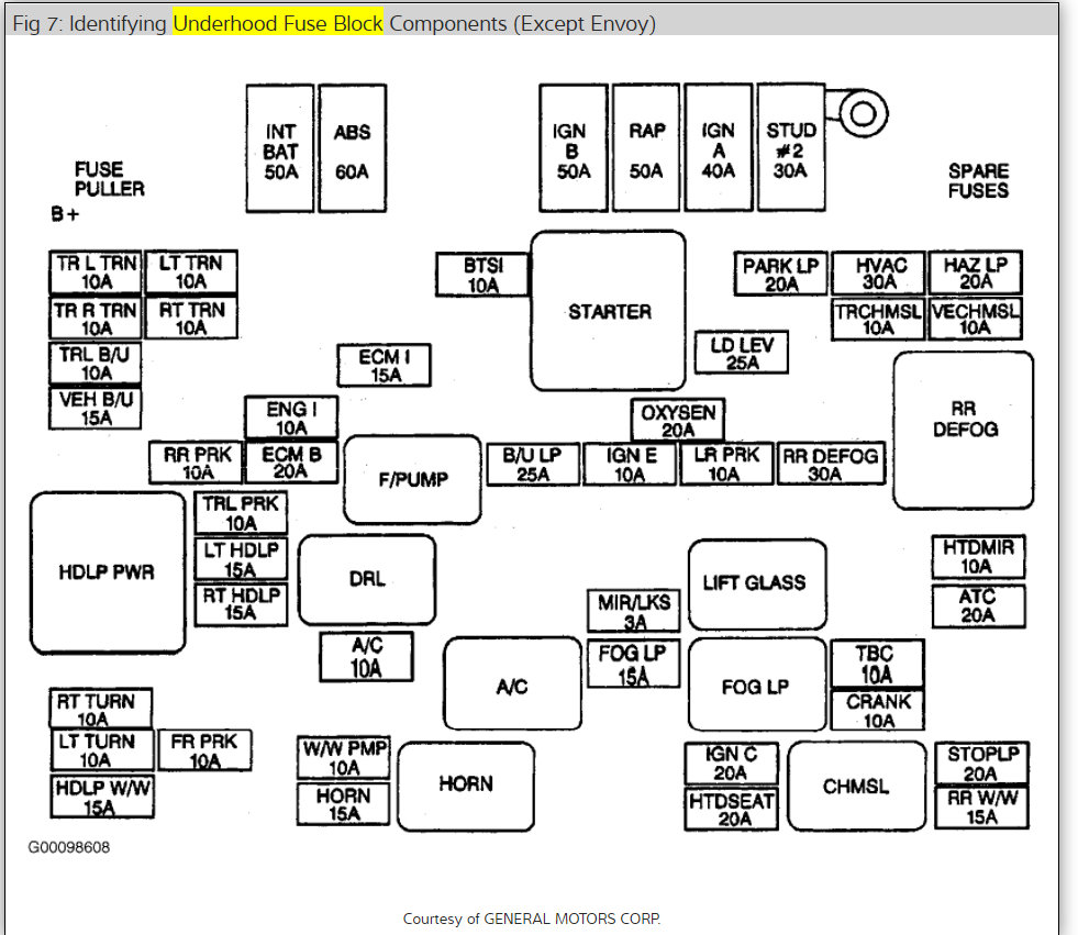

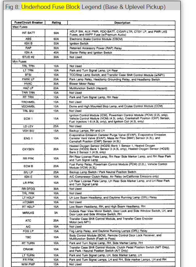

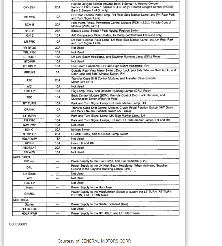

The first thing we need to do is check the fuses under the hood, B/U LMP #25 and BTSI with the key on to see if they have power. here is a guide to help and the fuse location in the images below:
Aug 27, 2022 at 10:25 AM

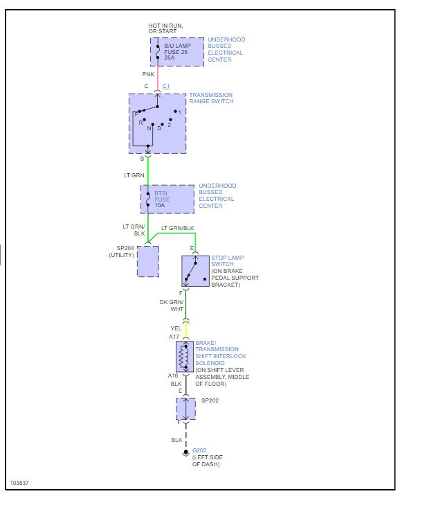

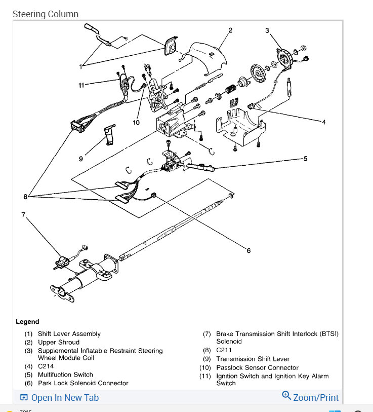

This leaves the shift lock solenoid being bad.
Here is the location so you can see if it is getting power and a guide to help you test it.
