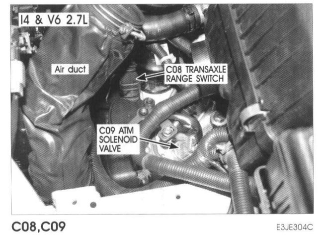

So the engine has low power or? If the power is okay I have seen the transmission range switch or control solenoid cause this problem. Here is a diagram to help you check it out with wiring diagrams to help you see how it works with a guide to help test it:
https://www.2carpros.com/articles/how-a-neutral-safety-switch-works

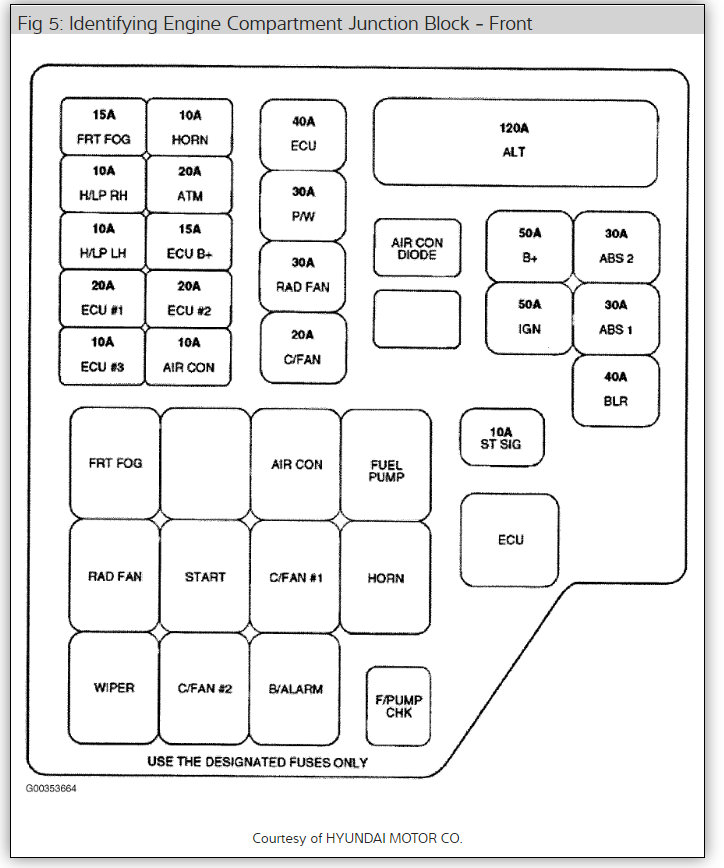

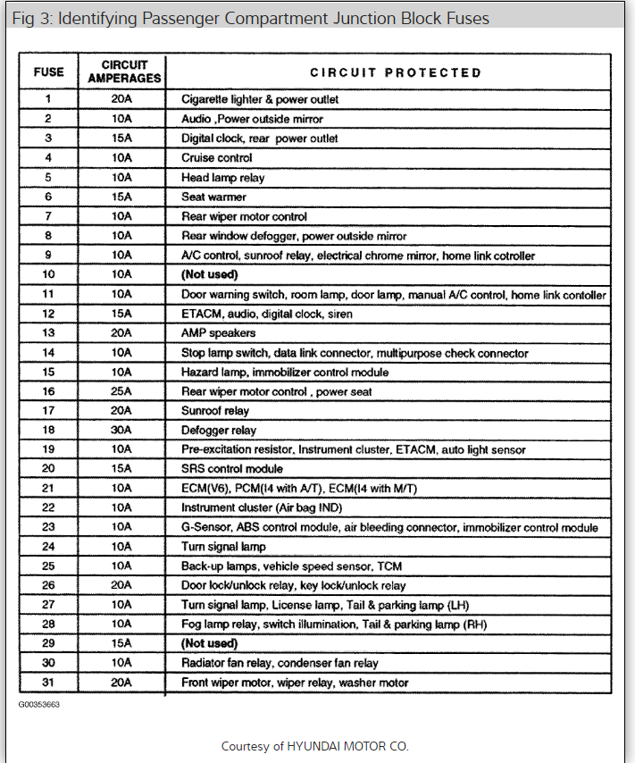

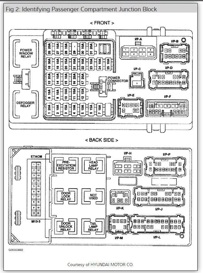

Can we also test fuse # 14, 25, ECU and ATM. Here is a guide and the fuse location as well:
Check out the diagrams (below). Please let us know what you find.
