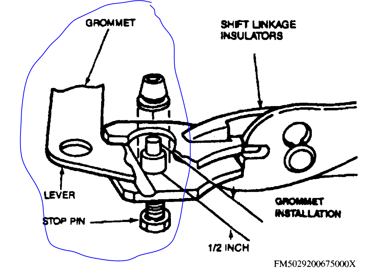

The first thing we need to confirm is if the shift lever on the transmission is actually moving. Have a helper shift the transmission through the gears while you watch the linkage where it is attached to the transmission to confirm it is fully moving.
I attached a pic below and circled the area I have of possible concern. There are plastic grommets that can fail. Just check to make sure everything is still attached and moving properly.
