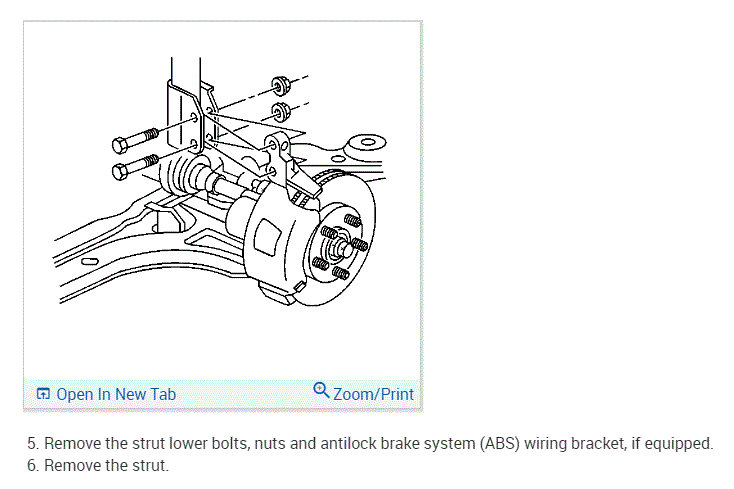

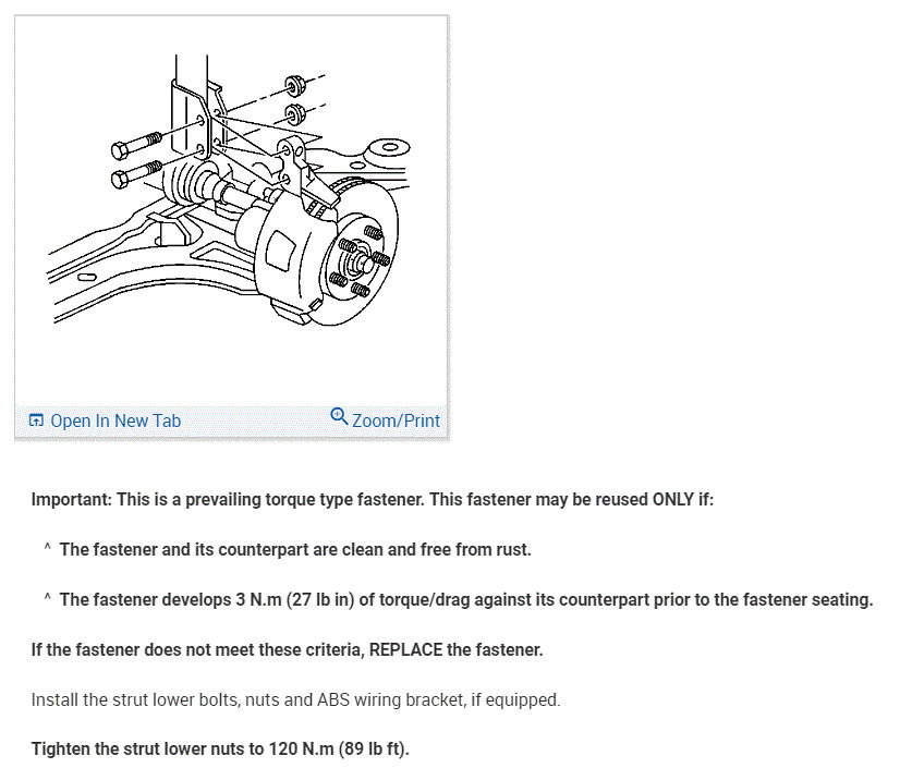

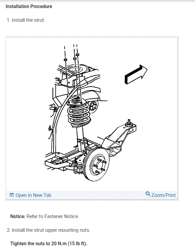

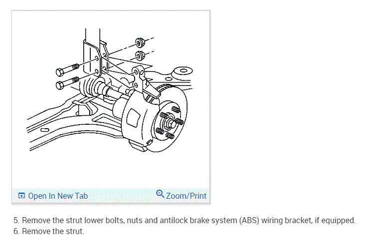

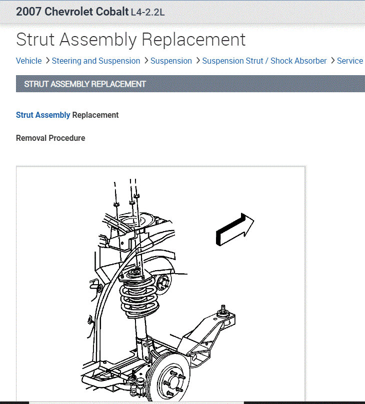

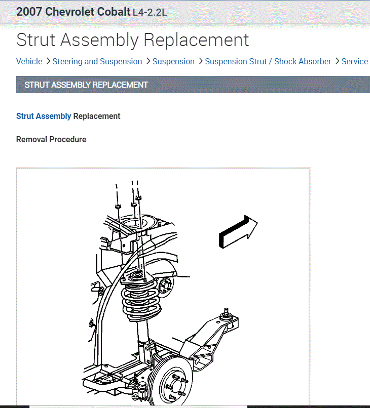

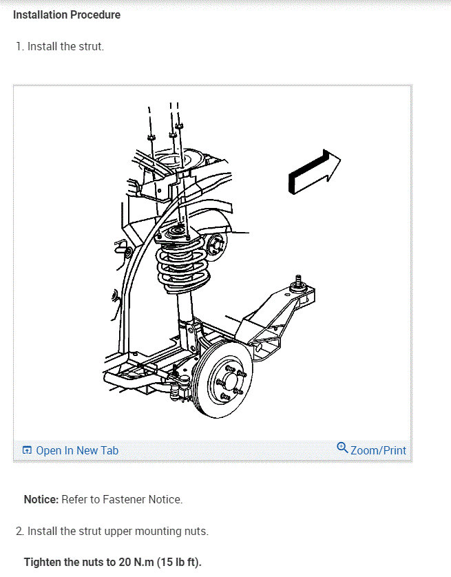

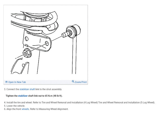

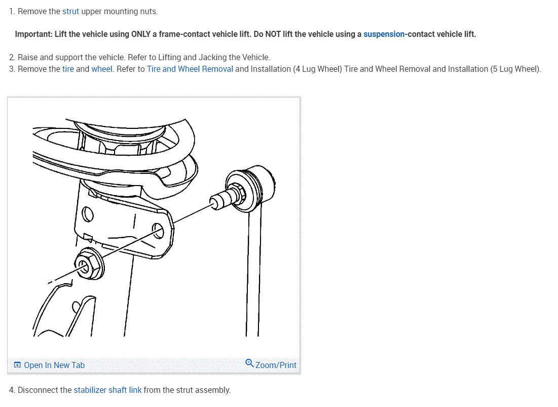

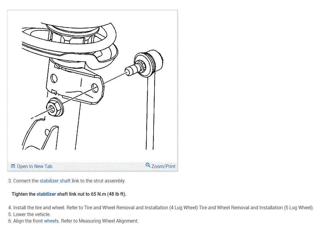

If you look at the attachments below, I included the directions specific to this vehicle for front strut removal and installation. The torque specs are included in the directions.
Note: The vehicle should be aligned after strut replacement.
Let me know if this helps.
See pics below.
