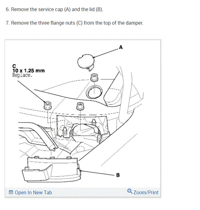

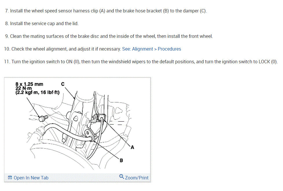

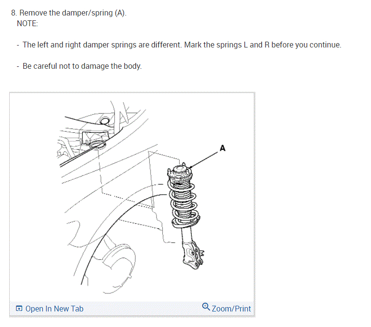

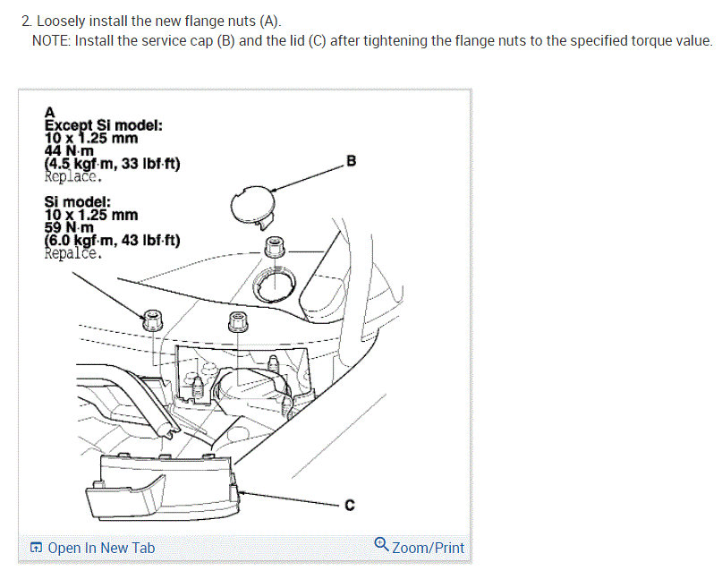

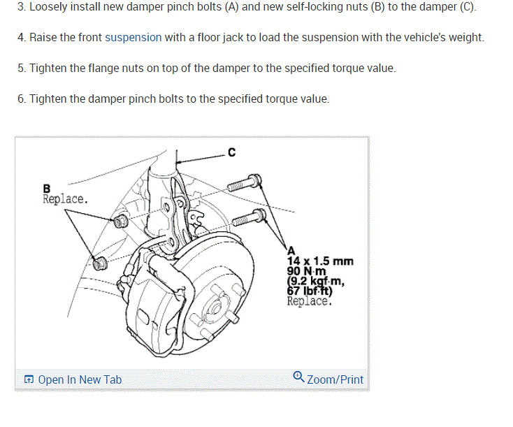

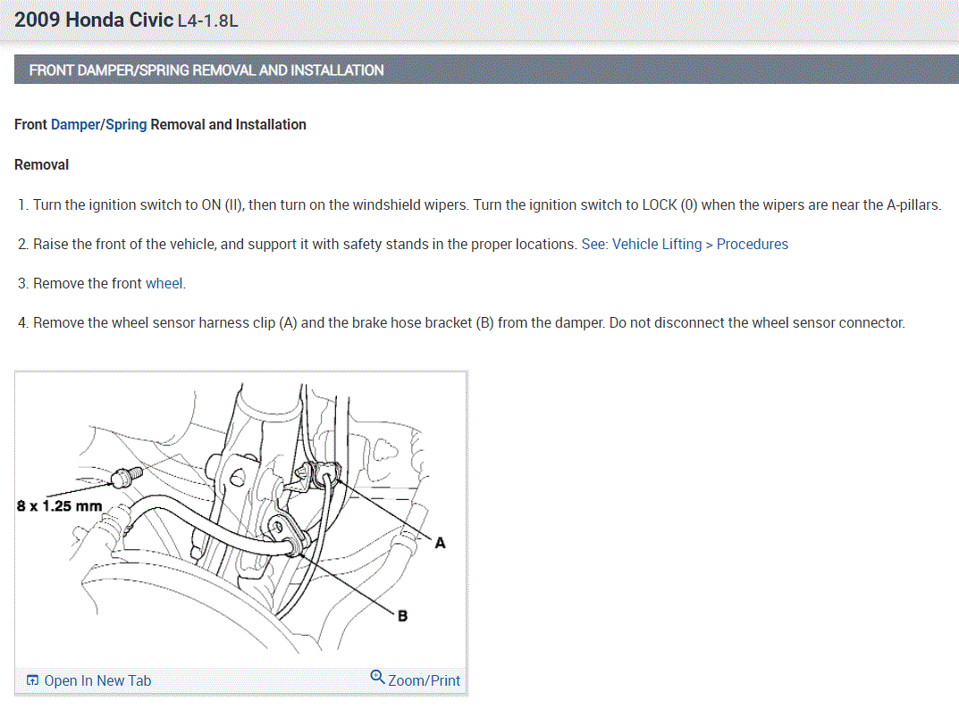

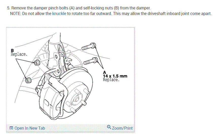

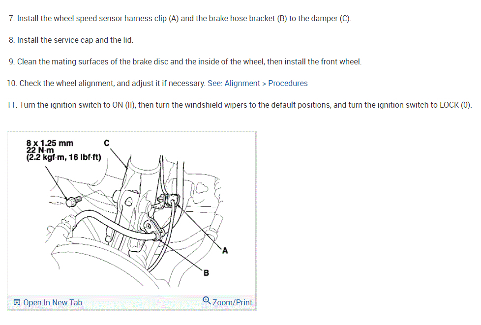

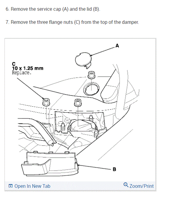

I attached the directions for the removal and installation procedures. Take a look through them to make sure nothing was missed.
See pics below.
