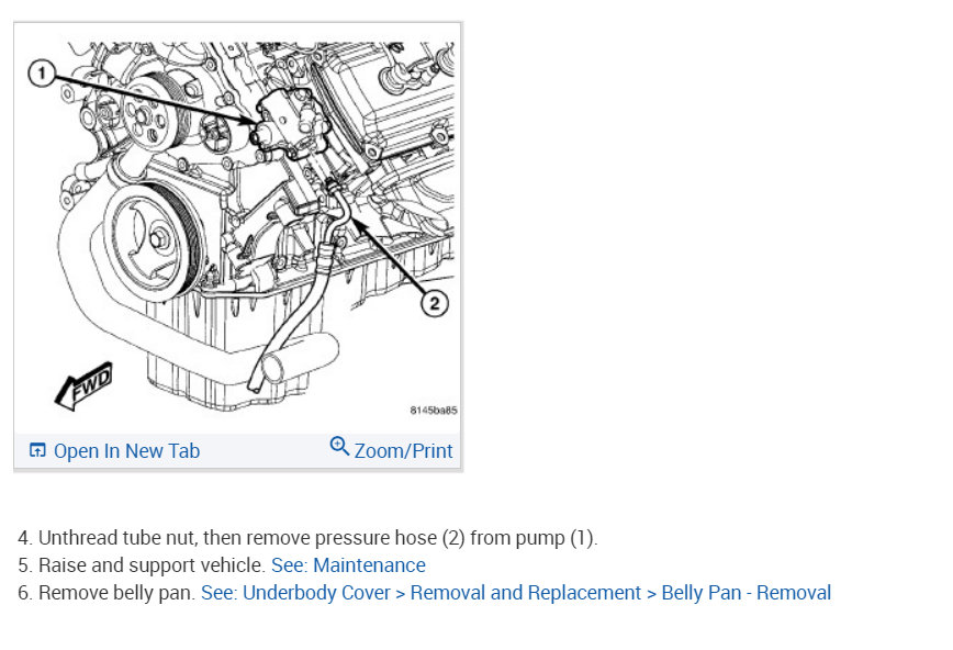

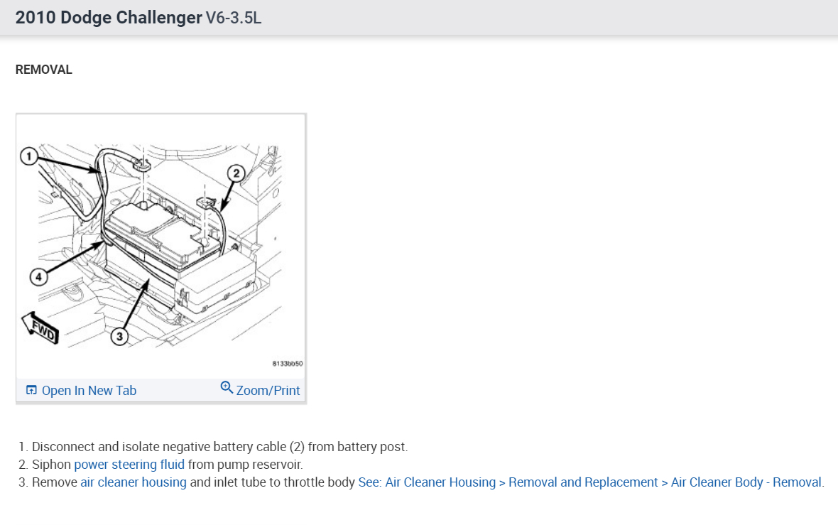

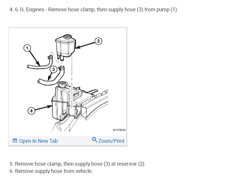

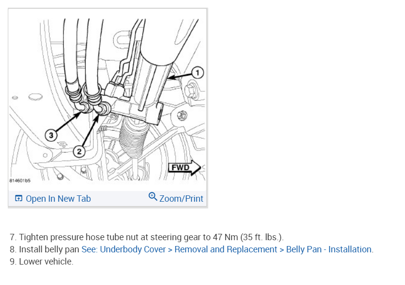

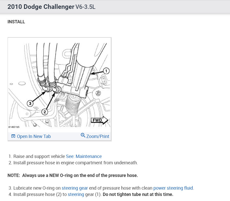

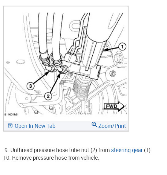

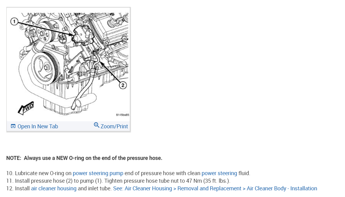

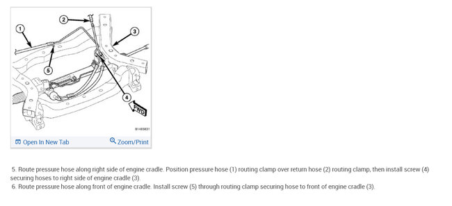

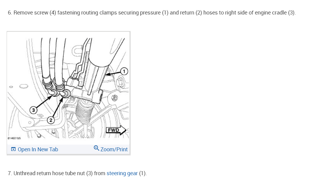

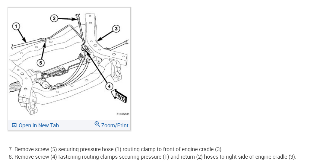

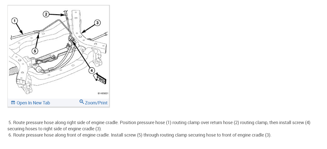

Yep, if the high-pressure hose has a leak, it will allow the fluid to leak out. Here is a video to help you change the high side hose out with instructions below to help you with your car:
https://youtu.be/BGBUv5r9fk0

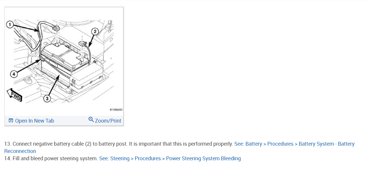

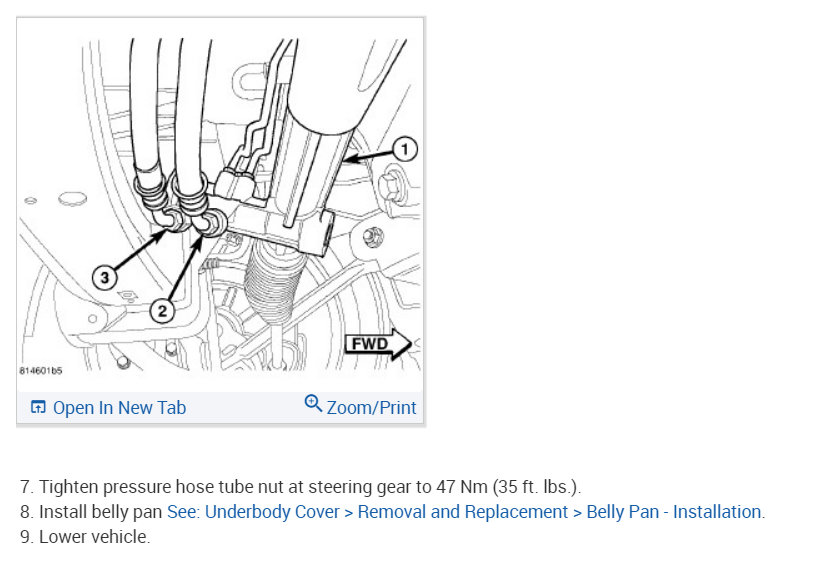

Here are the removal and installation instructions for the high side hose in the images below. Let me know if you need help.
Aug 24, 2022 at 8:25 AM

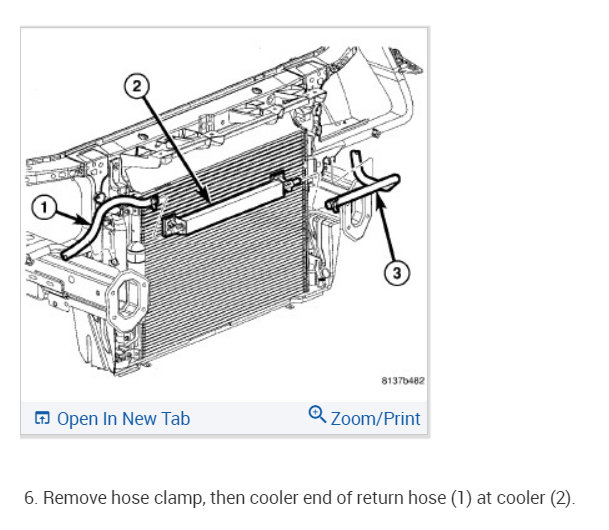

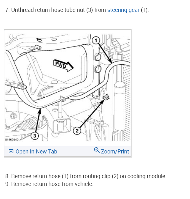

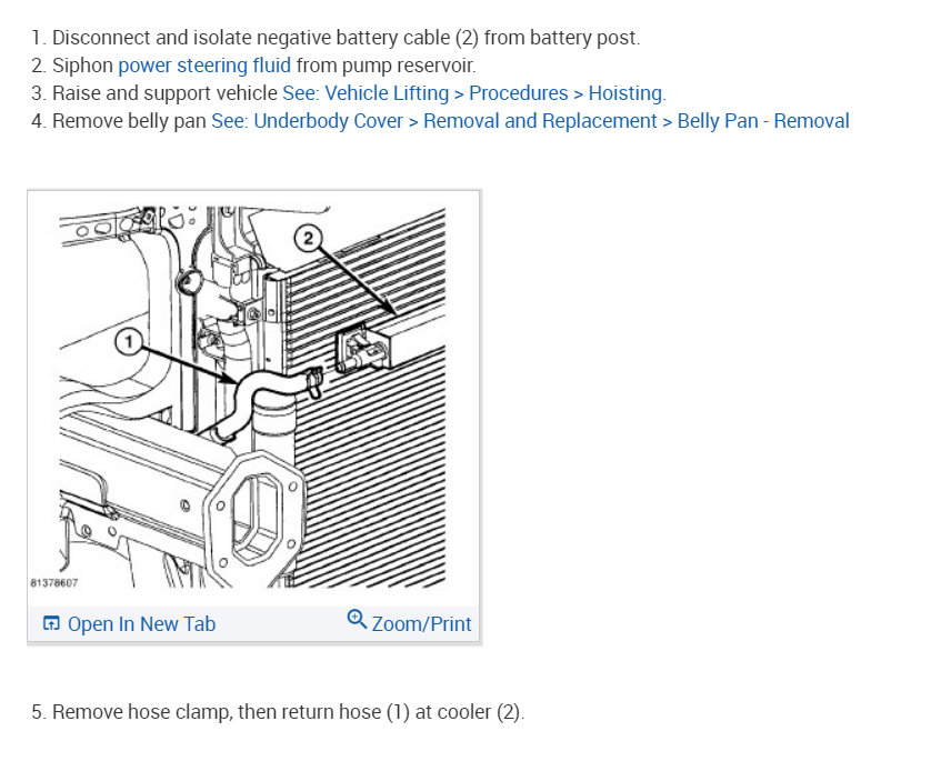

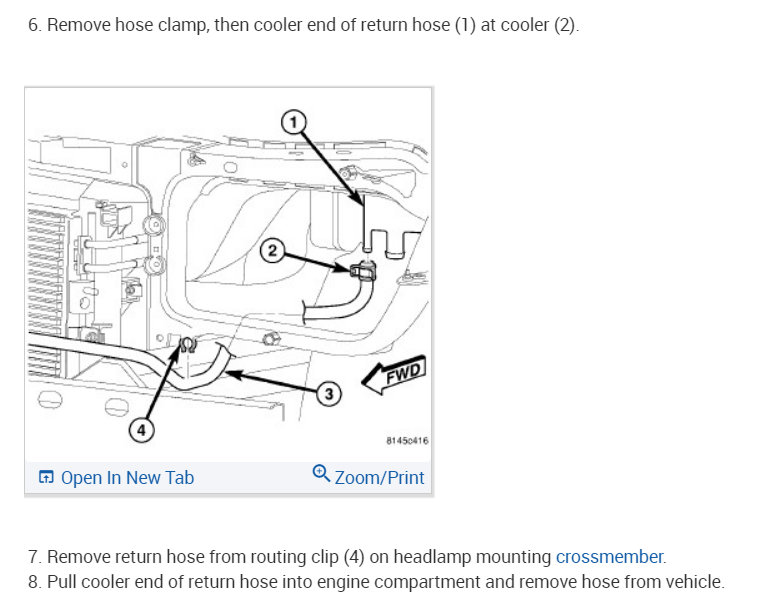

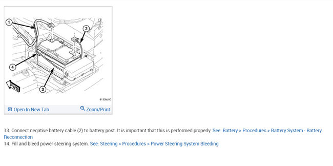

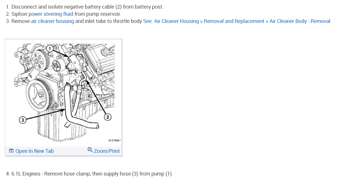

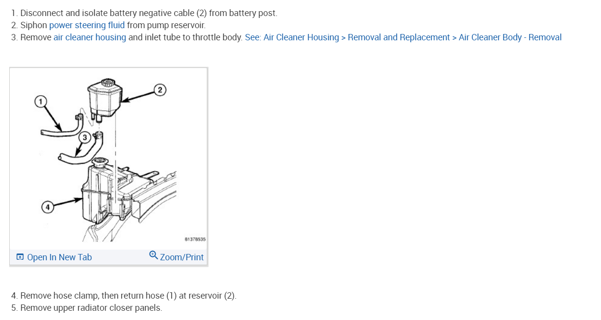

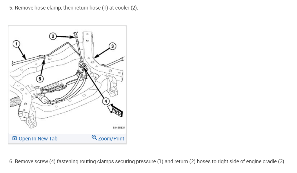

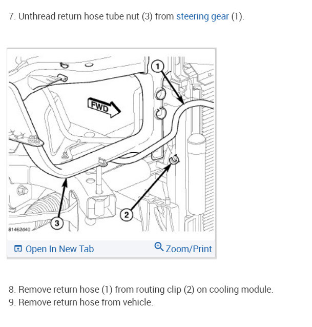

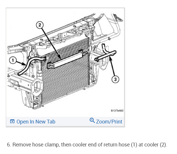

There is a cooler in the front of the car. here is how you can replace the low pressure and supply line as well.
Aug 26, 2022 at 12:31 PM
