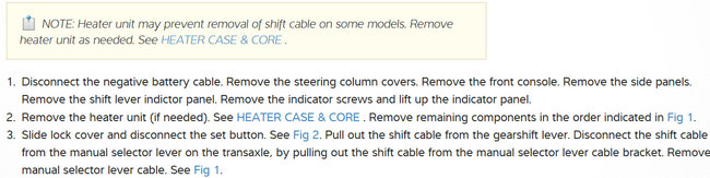

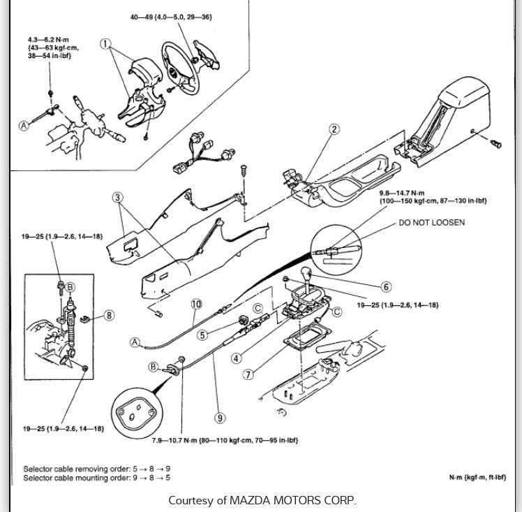

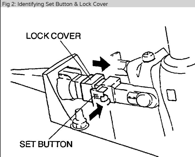

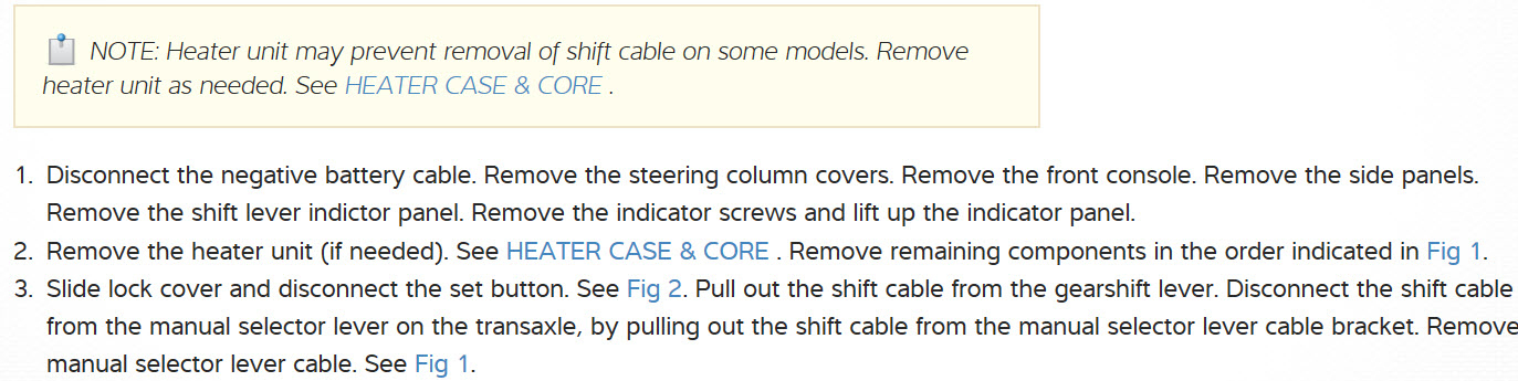

you may need to center console to access this. instructions are for Mx6 and 626 Protégé not covered. so may be similar. See pictures below
