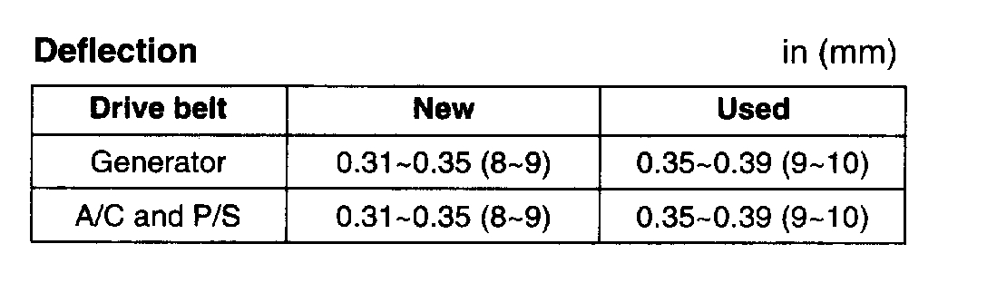

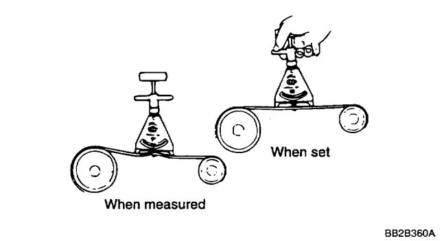

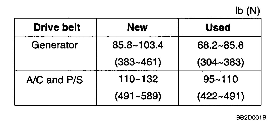

2. Measure drive belt tension with a tension gauge.
Deflection
picture 3
3. Measure deflection by applying moderate pressure (22 lb [98 N]) midway between pulleys. Adjust if necessary.

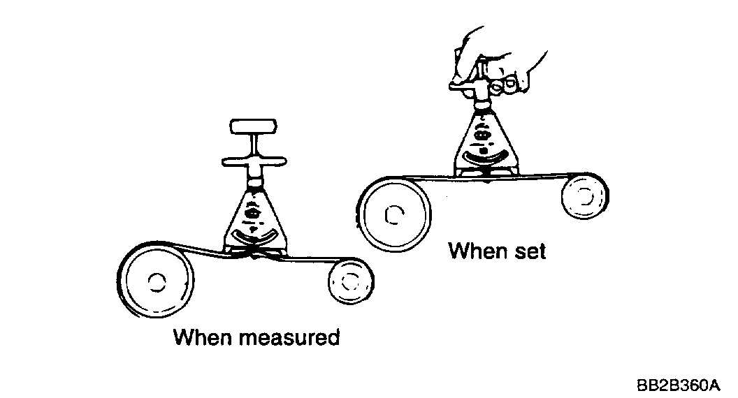

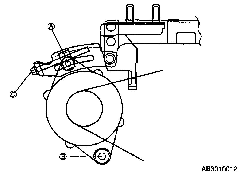

If you find that the tensioner needs adjusted to tighten the belt, here are the directions. The 4th picture shows bolt orientation as well as which one adjusts the belt.
Loosen pivot bolt B and tensioner mounting bolt A. Do not remove.
Relieve or add tension on drive belt by rotating adjustment bolt C.
