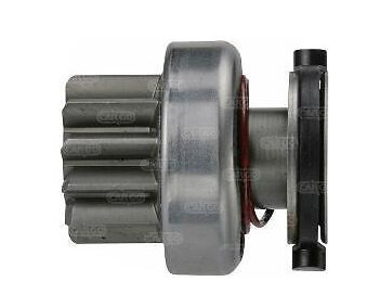

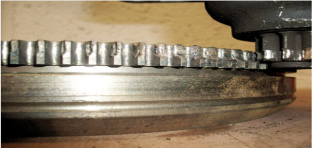

From what you describe the noise could be a starter Bendix gear staying engaged.
See images below of Bendix gear and ring gear.
