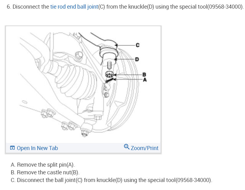

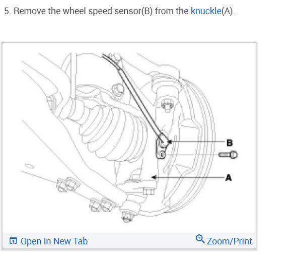

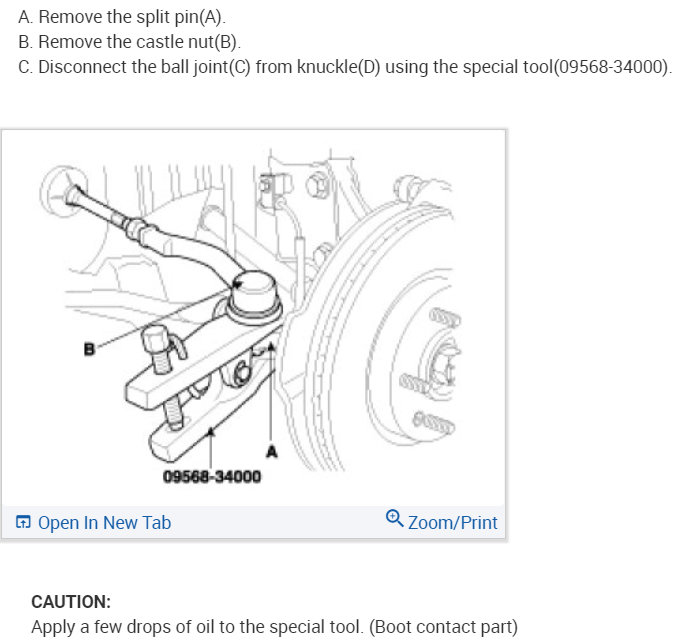

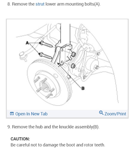

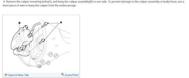

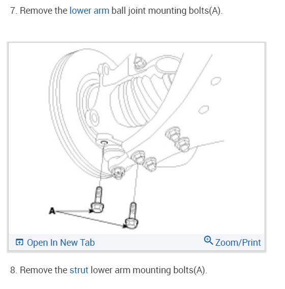

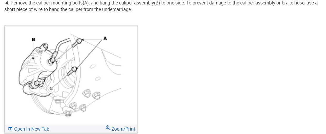

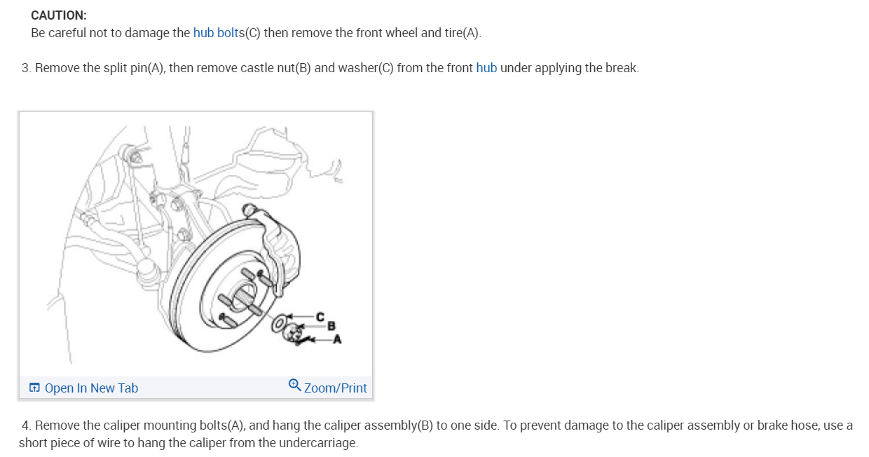

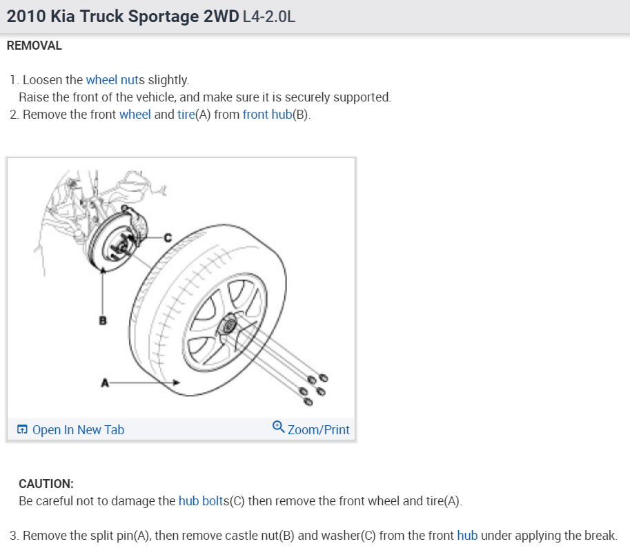

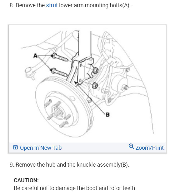

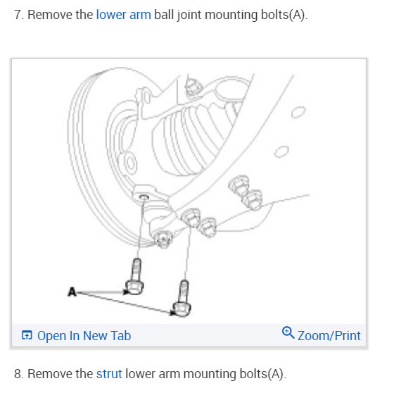

Good here is a video of what they need to do for the repair. This is rear but the front is the same. Can you please let us know how much it cost to get fixed?
https://youtu.be/_FzmmBoa4Tg
Check out the diagrams below of the job being done on your car. Check out the diagrams (Below). Please let us know if you need anything else to get the problem fixed.
