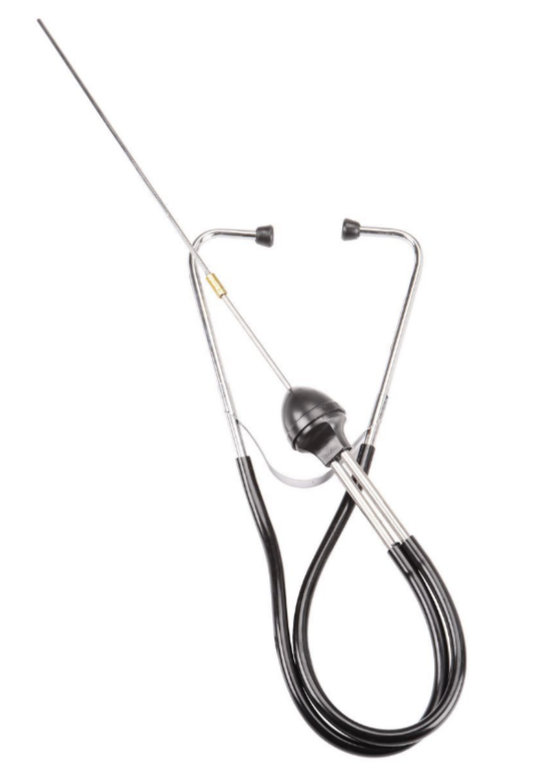

Typically humming noises are due to worn bearings inside a pulley.
It can be helpful to use an automotive stethoscope (see picture below) to find the noise.
You can put it on the hub of the pulley as it spins and most of the time it is easy to detect which pulley is making the noise.
