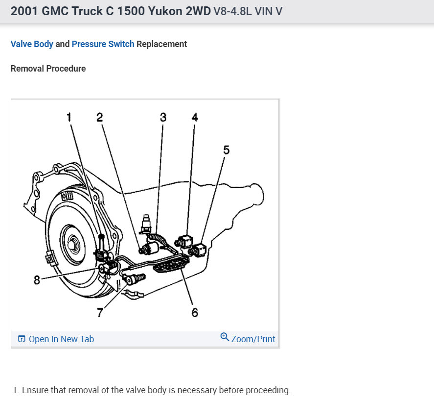

The first thing we need to do is check the transmission fluid level and run the codes.
Here is a guide to help you with the codes:
Here is how to check the fluid level:
https://www.2carpros.com/articles/how-to-check-and-add-transmission-fluid

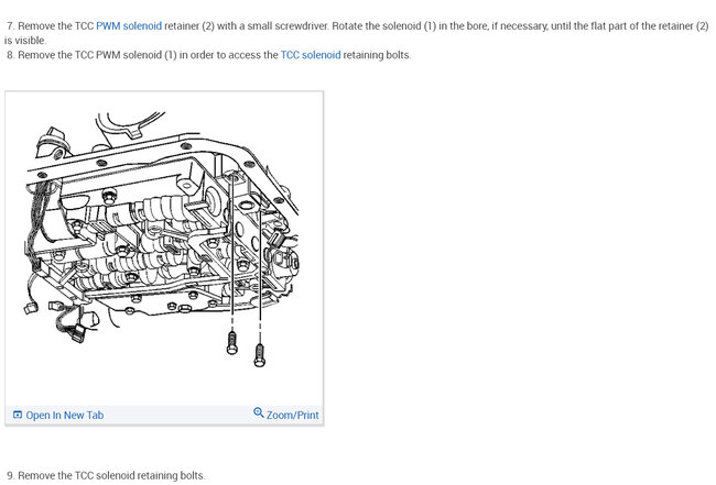

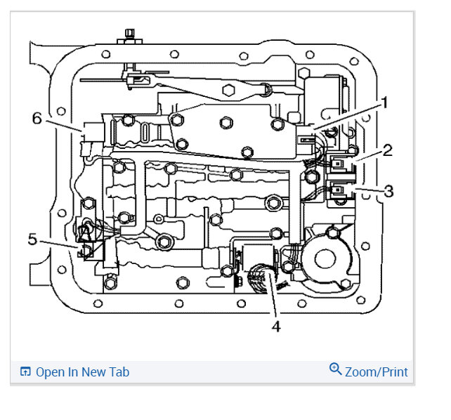

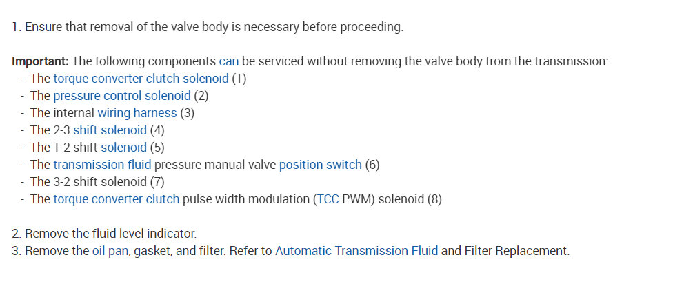

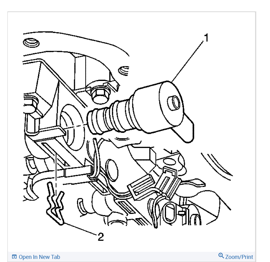

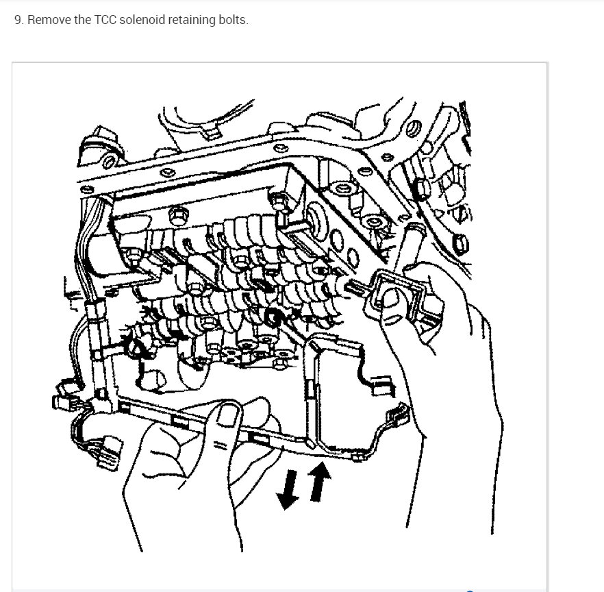

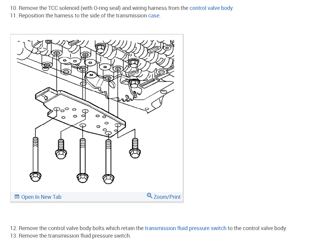

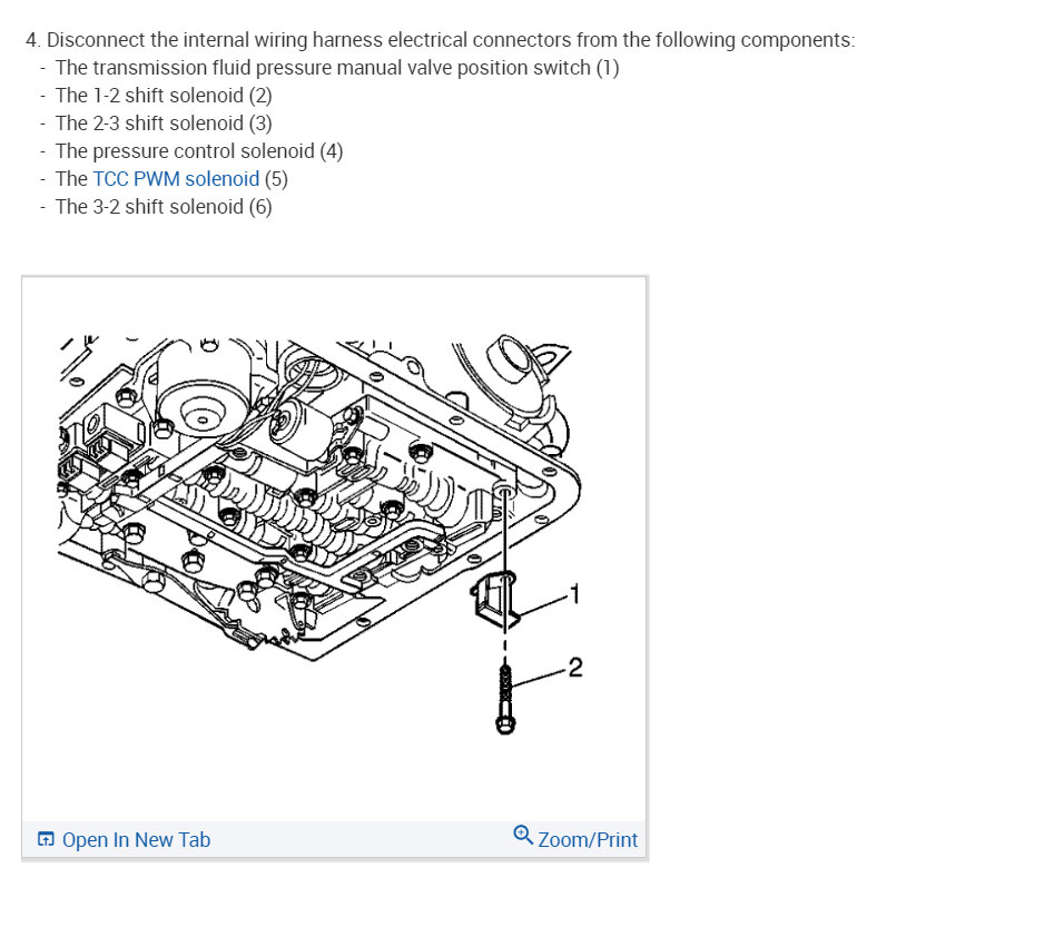

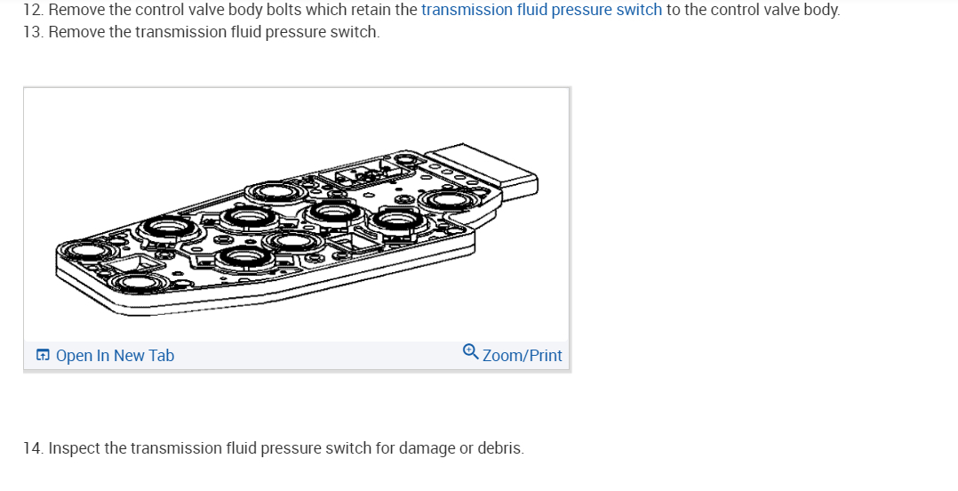

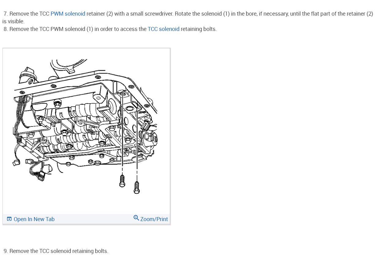

I have seen the Valve Body Pressure Switch go bad and will cause this issue as well. Check out the images (below). Please let us know what happens.
