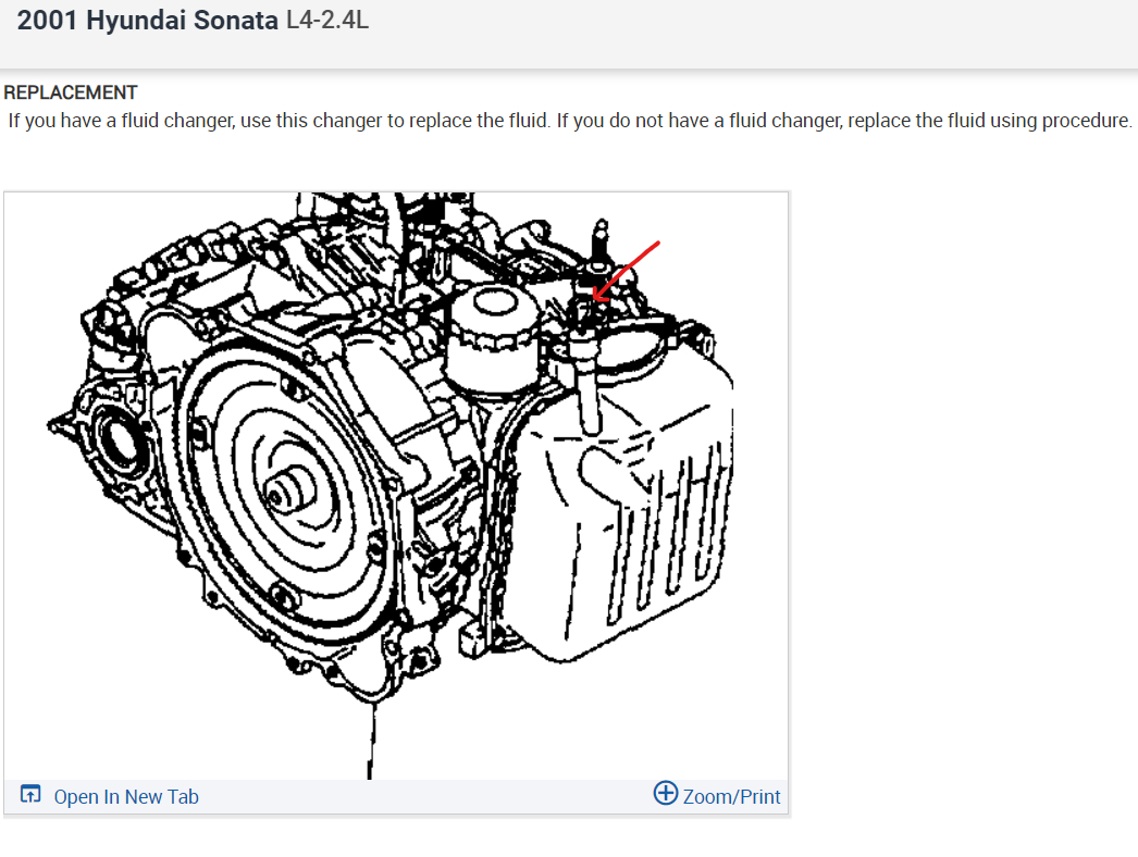

Sure, I can help you, the first thing I would do is check the transmission fluid level. here is a guide to help and I have included instructions in the images below for your car.
https://www.2carpros.com/articles/how-to-check-and-add-transmission-fluid
Fluid Types
Updated by TSB 13-AT-011
Fluid .................... SP-III
Capacities
Transmission Fluid .................... 7.8L (8.2 Qt)
Check out the images (below). Please upload pictures or videos in your response of any problems so we can see what to help you with.
