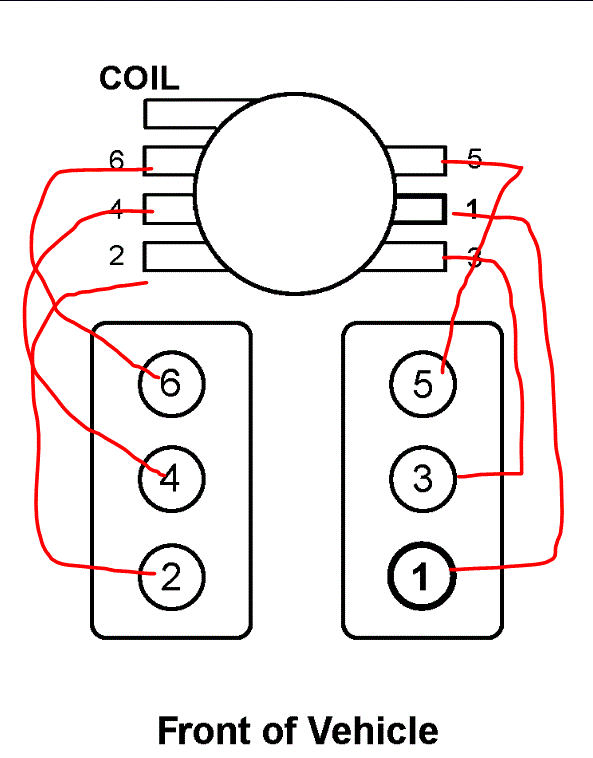

Okay, that is where one of the plug wires goes, so you got spark. By any chance could the plug wires been reinstalled incorrectly for firing order purposes?
I attached a pic of where the spark plug wire order per cylinder. Please confirm.
Jun 14, 2020 at 8:22 PM
DAVIDKAZEE
  • 21 POSTS
The wires are in the correct places. When I replaced the distributor cap I removed and replaced one wire at a time so I wouldn’t get them confused.

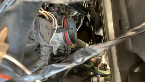

Okay, here’s the video. We sprayed starting fluid directly into the intake and it just turns over still. Exactly like in the video.

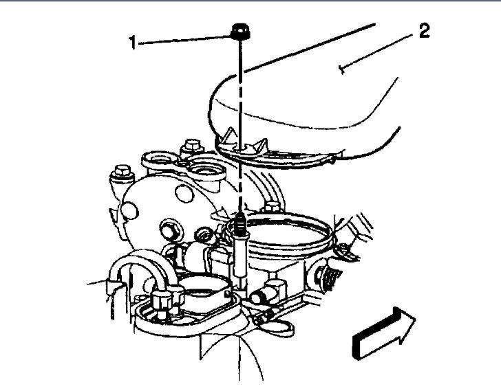

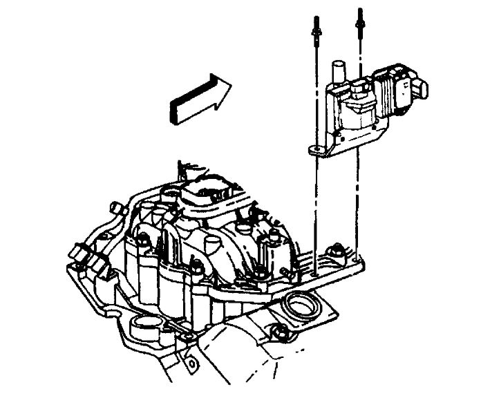

Jun 28, 2020 at 10:28 AM
This sounds like the ignition coil is not putting out too much spark.
How old is the coil?
I attached pictures of the replacement.

That would be a good start. I would replace it and see if it is a brighter spark.
