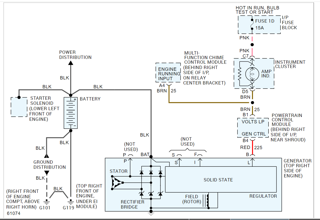

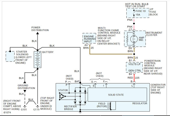

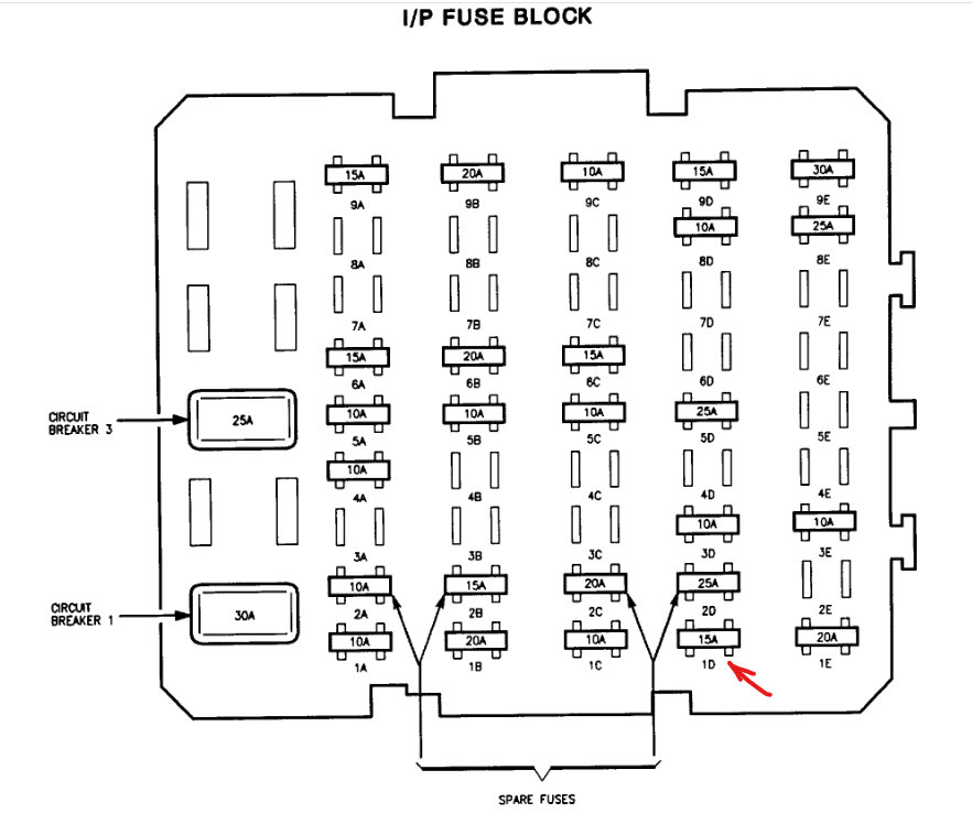

Replace alternator and battery, and the vehicle is still not charging. I heard there was an alternator maxi fuse on the front firewall. There are indeed ten or more maxi fuses and none labeled. Nor is there a diagram on the cover like the owner's manual says.
