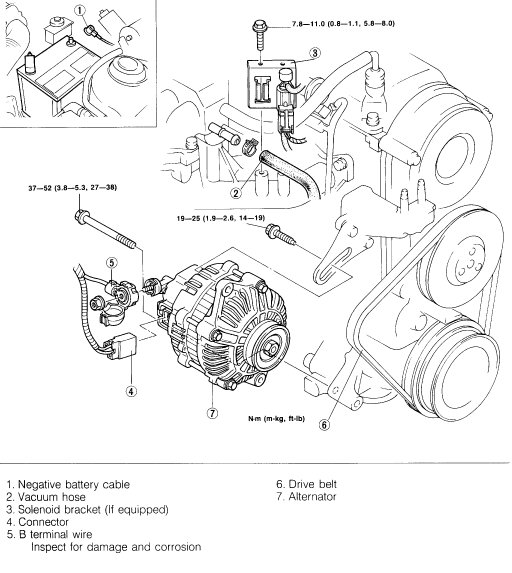

After the test, check to make sure all connections and wiring to the alternator are clean and tight. If everything looks good, I recommend removing the alternator and having it bench tested. Most parts stores will do it for free. Here are the directions for removal and replacement.
ALTERNATOR
Removal/Installation
Caution:
Be sure the battery connections are not reversed, because this will damage the rectifier.
Do not use high-voltage testers such as a megger, because they will damage the rectifier.
Remember that battery voltage is always applied to the alternator B terminal.
Do not ground the L terminal while the engine is running.
Do not start the engine while the connector is disconnected from the L and S terminals.
Remove in the order shown in the figure.
Inspect all parts and repair or replace as necessary.
Install in the reverse order of removal.
