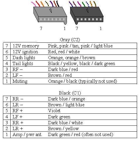

This drawing shows your old plugs. The wire colors could be different in different years, but the terminal location was the same since the early '80s. The last one on the list is for the amplifier's turn-on circuit. That wire must be connected to the "power antenna" wire on your new radio.
When downgrading to an aftermarket radio, if it doesn't sound right, the amp will have to be bypassed. There might be an aftermarket plug to do that, otherwise you'll have to cut and splice the input and output wires together. With the old radio, and usually with aftermarket radios, none of the speakers wires can be grounded. There's six volts on them all the time.

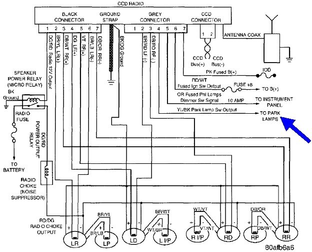

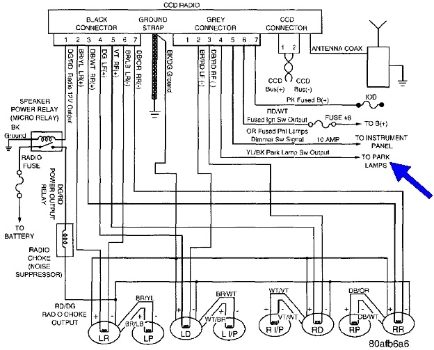

I think you just listed the problem. You used the yellow / black wire for the ground. I mentioned previously there is no ground wire in those two plugs. You have to use the braided strap that's bolted on the back, or the ground wire that's clipped onto a terminal on the back. The wire you used is for the tail lights. When you turn on the head lights at night, 12 volts shows up on that wire to tell the display to dim. By connecting it to your new radio's ground, the tail light wire is shorted to ground through the outer shield on the antenna cable.

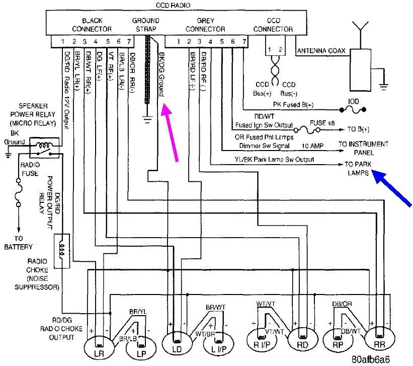

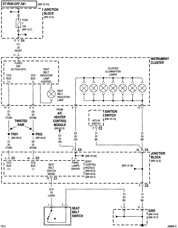

I see where you found that yellow / black wire. It's shown on this first diagram. This is the wire I drew as the black / yellow wire, but as I said, the colors can change from year to year.

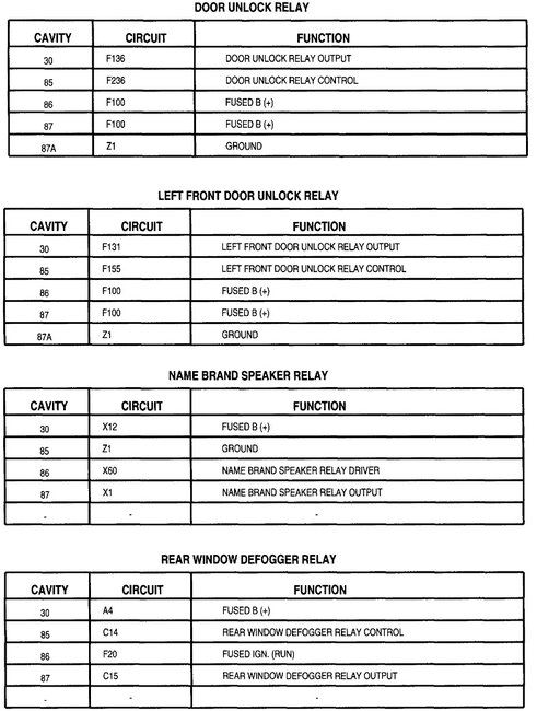

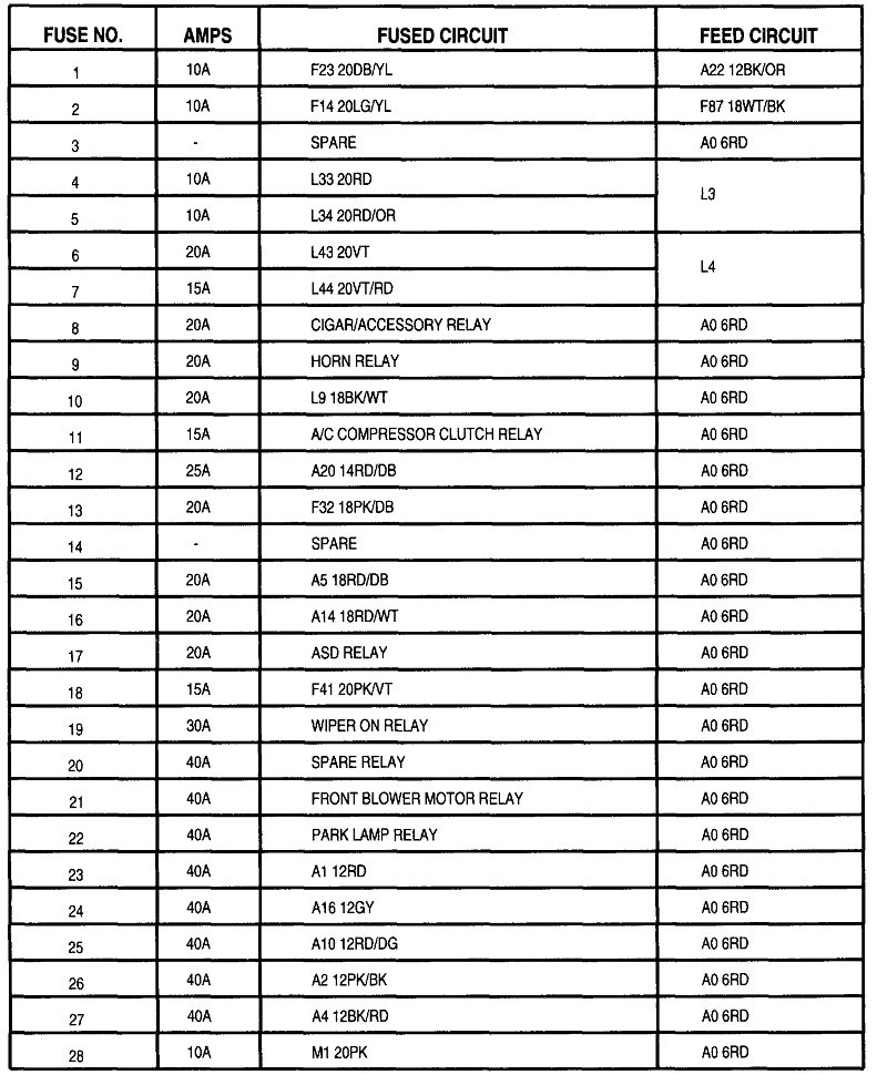

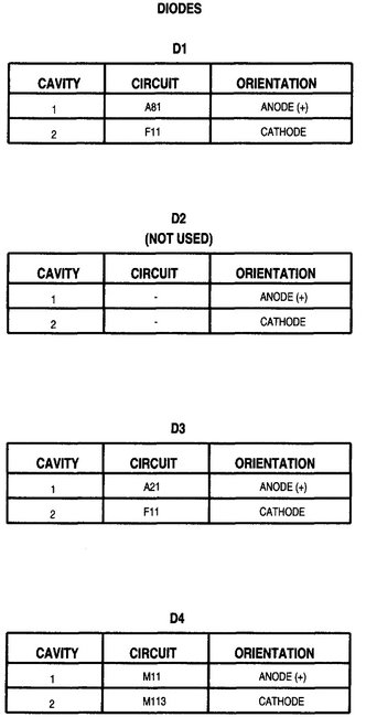

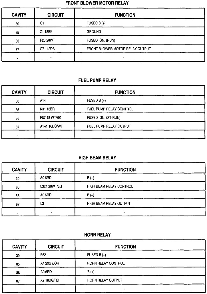

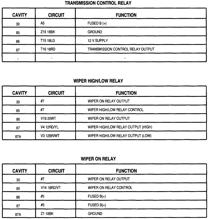

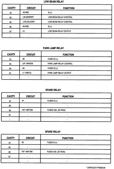

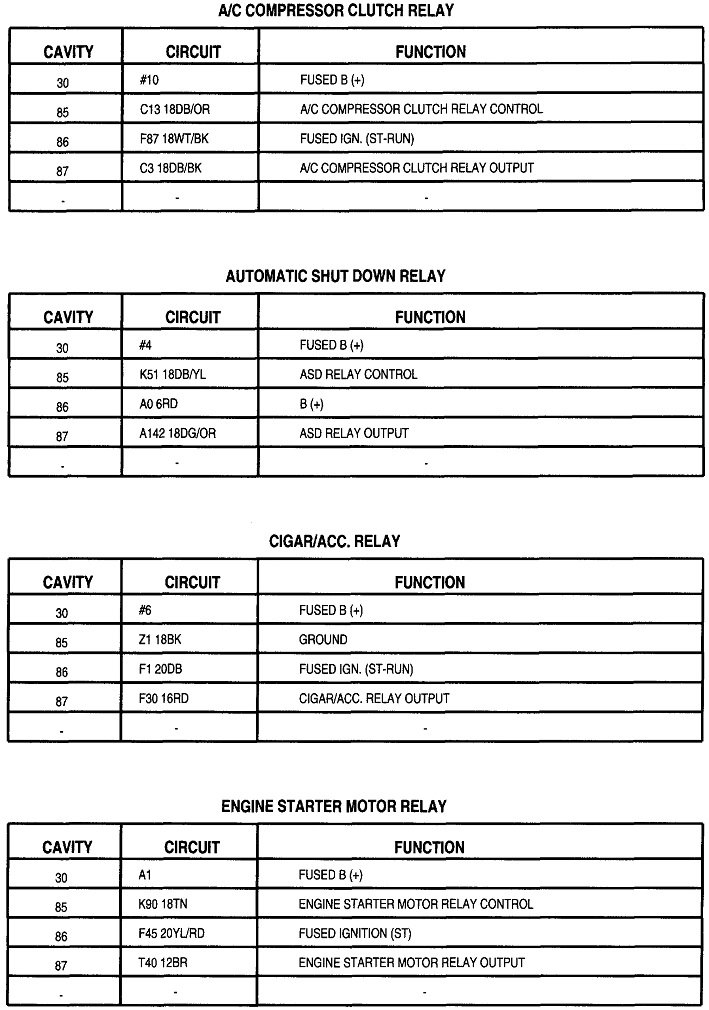

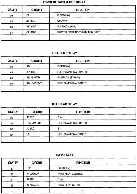

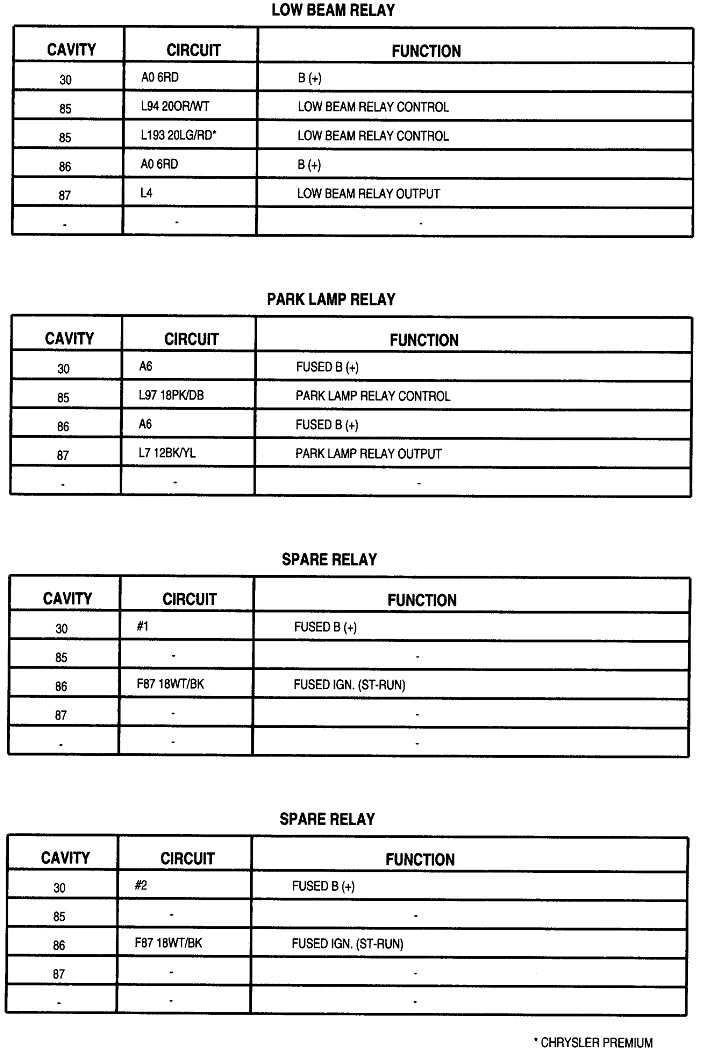

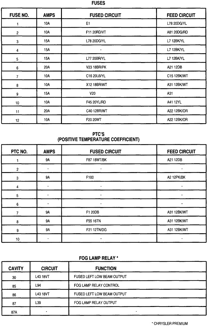

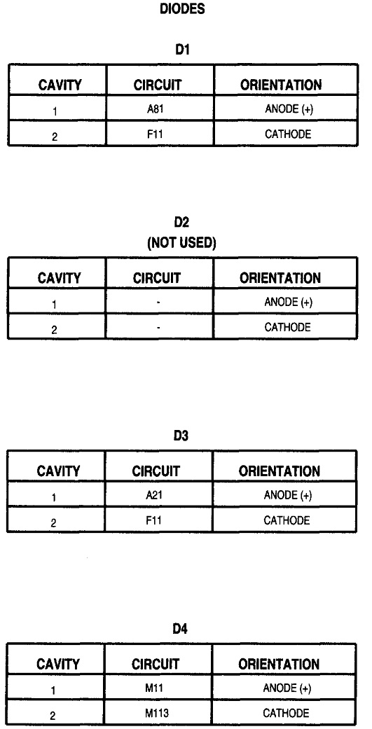

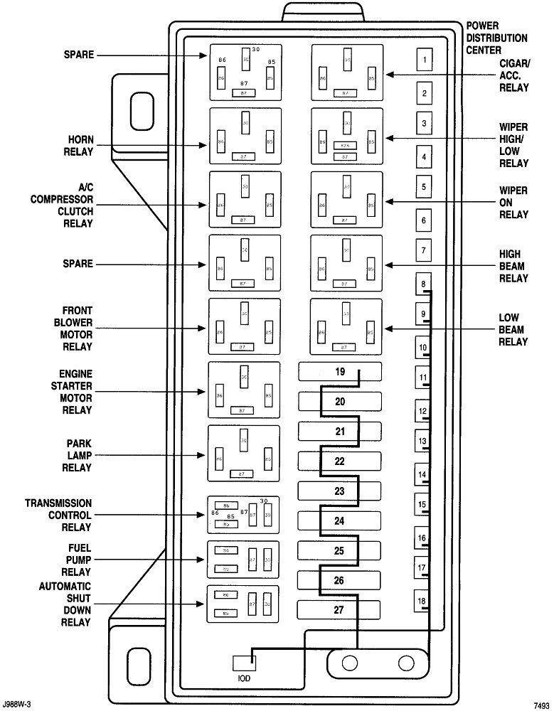

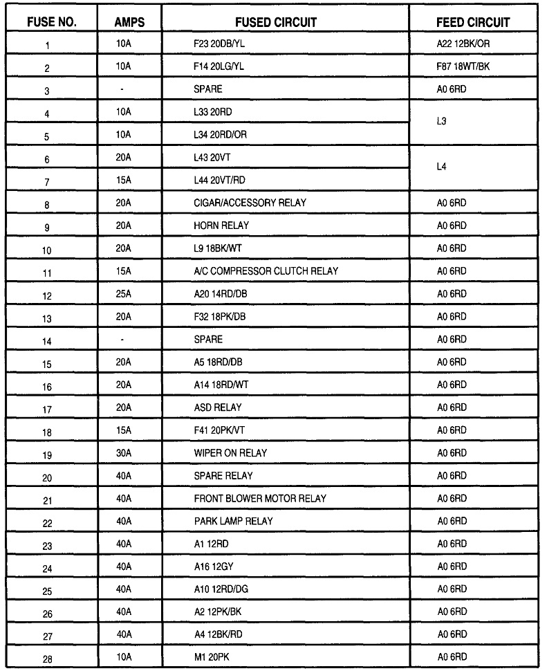

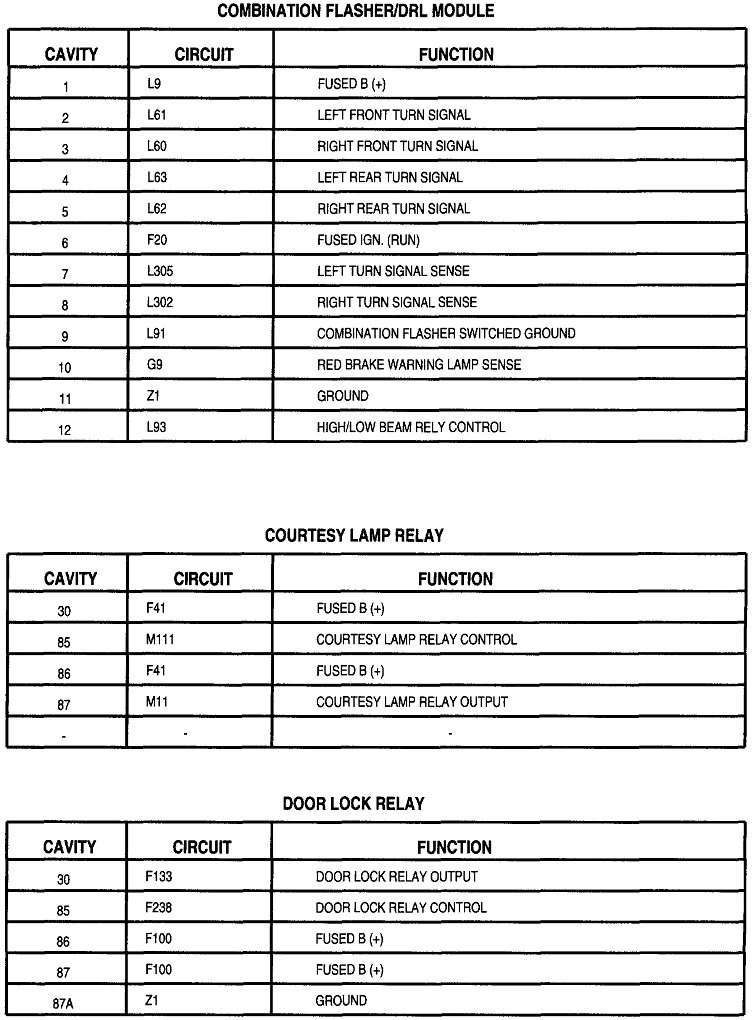

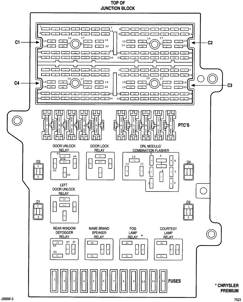

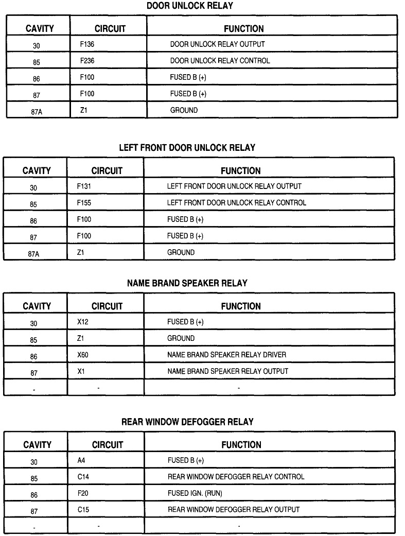

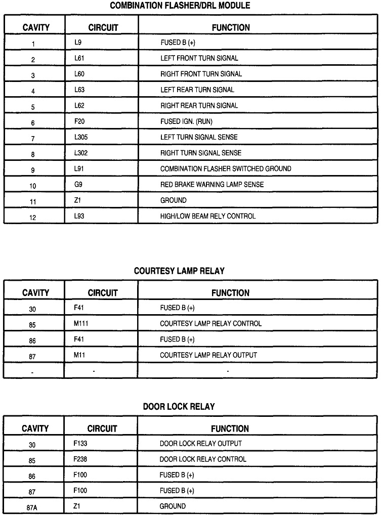

The second diagram shows the dash lights. As for blown fuses, I don't see any dedicated just for the instrument cluster lights, but I think I know why they're dead. For reference, the third through seventh drawings are for the Junction Box. That's the inside fuse box in front of the brake pedal. Drawings 8 through 13 are for the Power Distribution Center, (PDC). That's the fuse box under the hood.
Starting with the '96 models, Chrysler started using a two-terminal semiconductor circuit breaker called a "positive temperature coefficient", or "PTC". They have a current rating like a fuse, but the instant current exceeds that rating, the device instantly goes open circuit, the same as if a fuse were to blow. The difference is when the short is removed, it goes right back to acting like a piece of wire and the circuit goes back to working normally.
There's also a lot of stuff being run by a Body Computer. On some circuits, if they detect a short, they won't turn that circuit on.
The first thing to do is disconnect the yellow / black wire and cap the end of it. That wire, and the orange wire, aren't used with aftermarket radios. Now check if the instrument cluster lights are working. If they are, they are protected by a PTC, so no further repairs are needed for that problem. If they still aren't working, start by checking the lower row of fuses in the Junction block. To make that easier, they all have two small holes on top for test points. Use a test light to check each test point. Here's links to articles that explain this better, if you need it:
If you find 12 volts on both sides of a fuse, that one is okay. If you find 0 volts on both sides, that circuit is turned off. The lights have to be turned on during this test. You're looking for any fuse that has 12 volts on one side and 0 volts on the other test point.

Looking at this diagram jogged my memory. Rather than using a remote amplifier, the minivans used very expensive speakers with little amplifiers built onto them. You'll see they have four wires in their connectors. Besides the two speaker wires, there's a 12-volt supply and a ground wire to run those amps. Where the "12-volt output" wire in the black plug provides the turn-on signal for the remote amplifier, here it turns on a relay that switches the 12 volts on for the speakers.
This diagram is not from Chrysler and at first is confusing. It looks like they're sending 12 volts from the relay to the ground terminals on the speakers. It took me a minute to realize they're showing the plus and minus symbols for the two speaker wires, not the power and ground wires. Technically there aren't positive and negative speaker wires. They're both basically the same. They just use the plus and minus signs to be sure they're wired the same so they're all "in phase". That means when one speaker cone is moving out, they all are at that time, and when one is vibrating in, they all are again. If one or more are wired "out-of-phase" you and I are never going to tell the difference. It's the placement of those polarity signs that confuse the issue because you can't tell at first which wires they're for.
The other thing I overlooked is all the speakers' ground wires are spliced together, then they go back to the case of the original radio, then to ground through the braided strap. I added the purple arrow to show that ground wire. If you forget to connect that wire to the metal case of your new radio, you'll have very little sound.
You'll notice they show eight speakers at the bottom of this diagram, but in the van you'll only find four. The tweeters are mounted onto the front of the main speakers. The amplifiers only run the main speakers. The two speaker wires pass through the amp to the tweeters. Being not powered, or amplified, if the 12 volts or ground are missing, the amps won't work, but you'll still get sound from the tweeters. Often you have to listen very carefully to hear them.

Basically it sounds like you wired up the eight speaker wires and the two power wires to your new radio, but these speakers also need their own ground and power wires. That ground wire clipped onto the back of the old radio. It doesn't matter how you do it, but that wire has to be grounded all the time. The easiest is to attach it to one of the screws on the new radio's case. You had it connected to the tail light wire.
The 12-volt feed for the amps on the speakers has to be switched on and off along with the radio so they don't drain the battery when the ignition switch is off. That's the purpose of the "power antenna/amp" wire coming out of the new radio.
