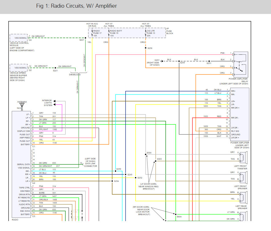

How do I connect my factory harness to a after market stereo wiring with no illumination wire to dim face plate?

All radios have illumination. If you go to a store like BestBuy, they have wiring kits for your specific vehicle to wire it properly. If they do not have it they will order it for you.

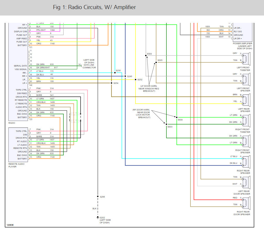

Here is the radio wiring diagrams so you can see if you have installed the radio correctly. Check out the diagrams (below). Please let us know what you find. We are interested to see what it is.
