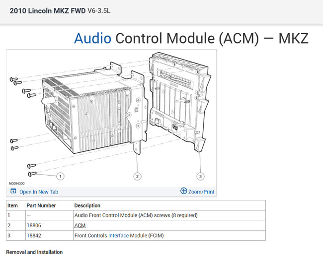

Hmm, bummer, 9 times out of 10 it will be the head unit itself. We can try doing a CAN scan to see if any cods are stored which can help confirm the issue.
CAN SCAN - https://youtu.be/u-4syLc-ifQ

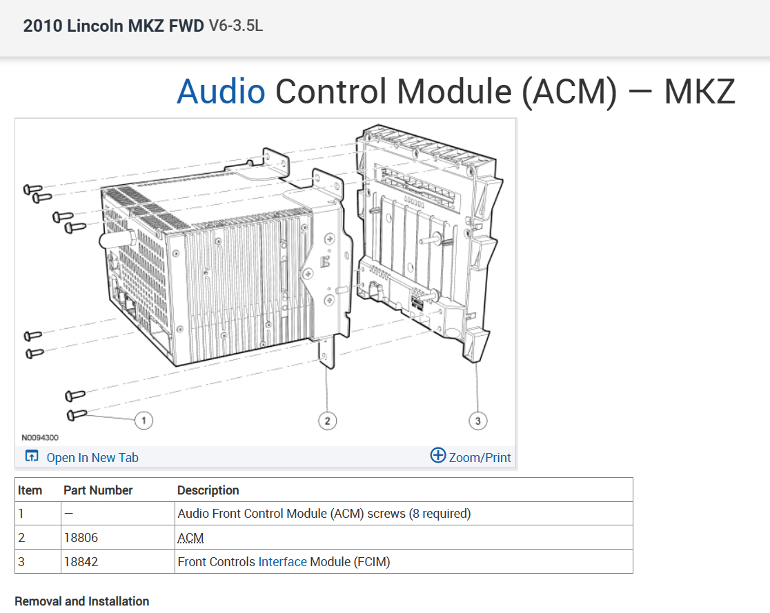

Here is how to change the radio out and I will email you the images as well if they don't show up here.
It is not necessary to remove the Audio Front Control Module (ACM) to retrieve the part number. For additional information, refer to Audio Control Module (ACM) Self Diagnostic Mode
Module configuration is required when a new ACM is being installed.
Upload the ACM configuration information to the scan tool. For additional information, refer to Programmable Module Installation (PMI) in Section 418 01.
Remove the Front Controls Interface Module (FCIM) .
Remove the 8 screws and the ACM .
To install, reverse the removal procedure.
Download the ACM configuration information from the scan tool.
