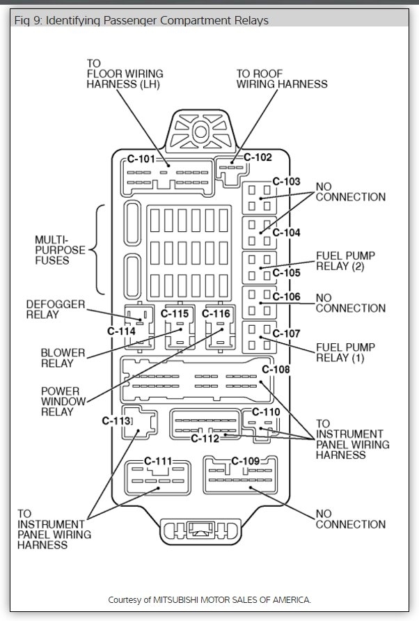

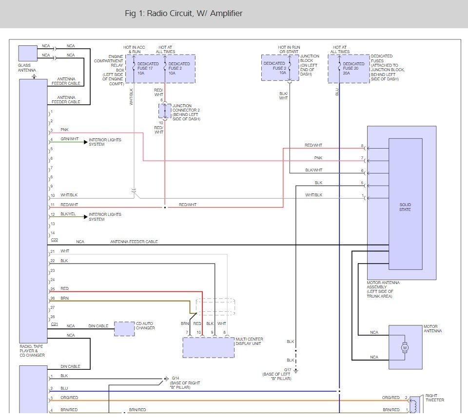

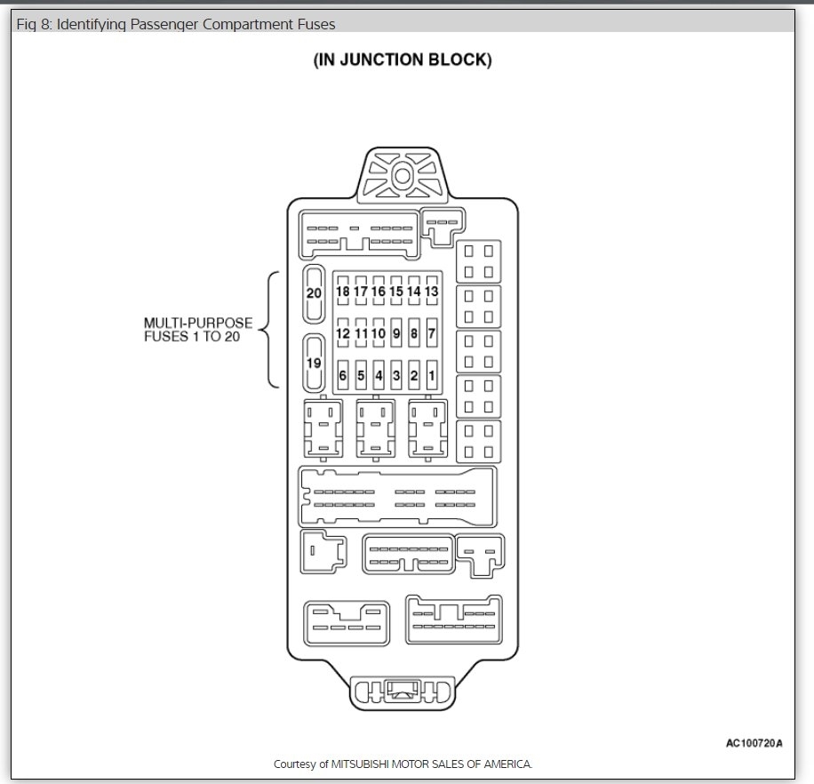

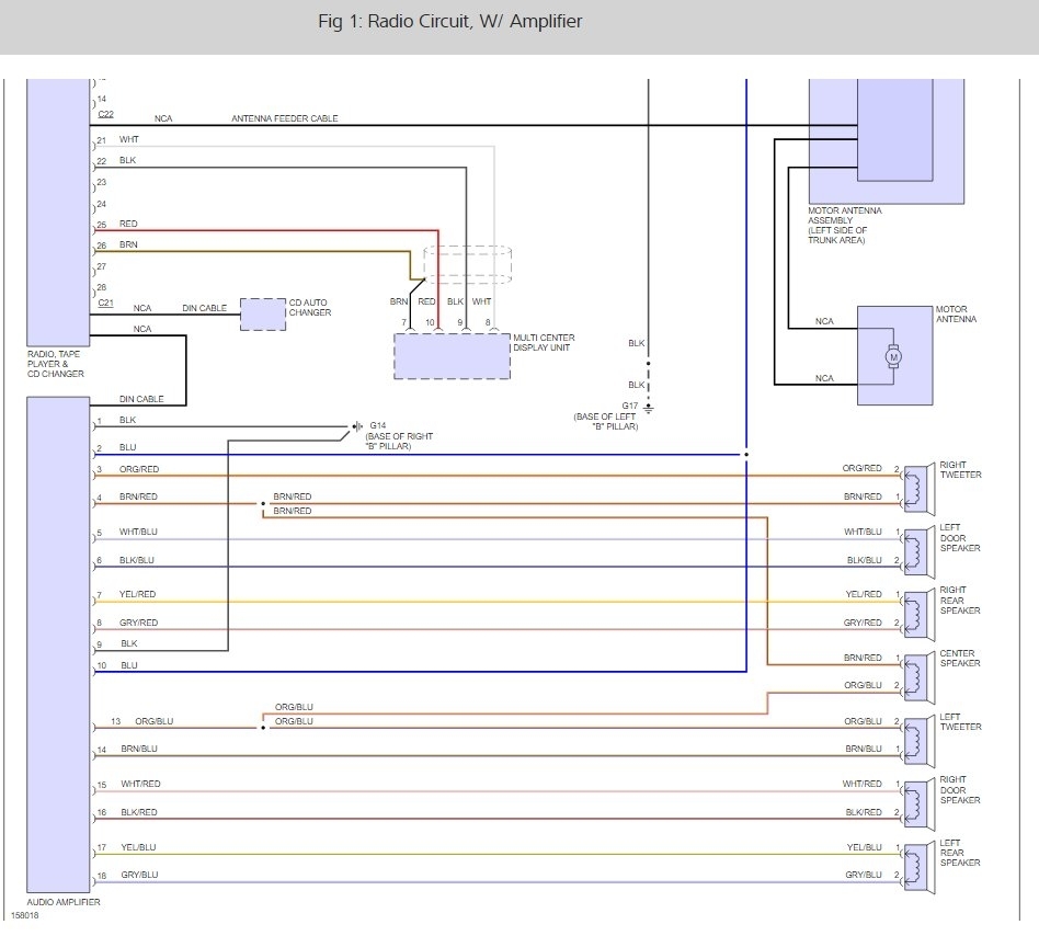

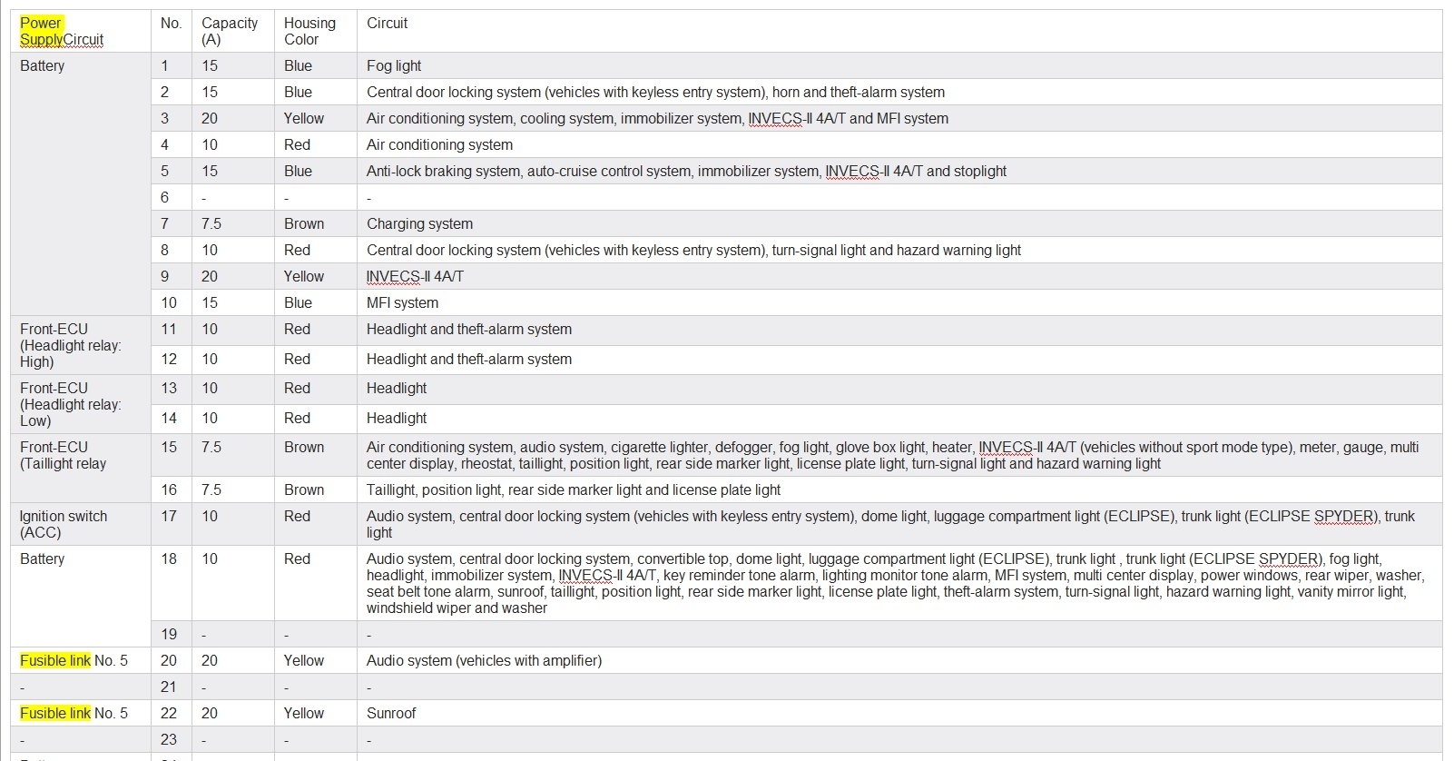

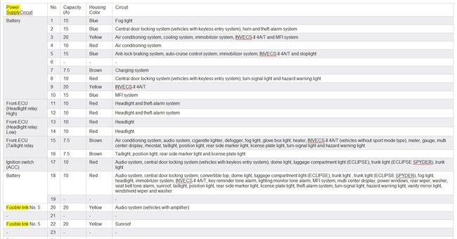

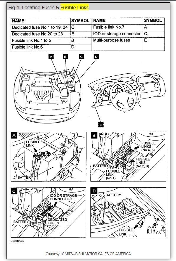

i have found the fuse boxes, but have no luck fixing the stereo or clock on. engine comp shows a music symbol for ten amp, the one on dash shows music symbol twenty amp but it says upper. where is it?
Jun 8, 2017 at 7:58 AM

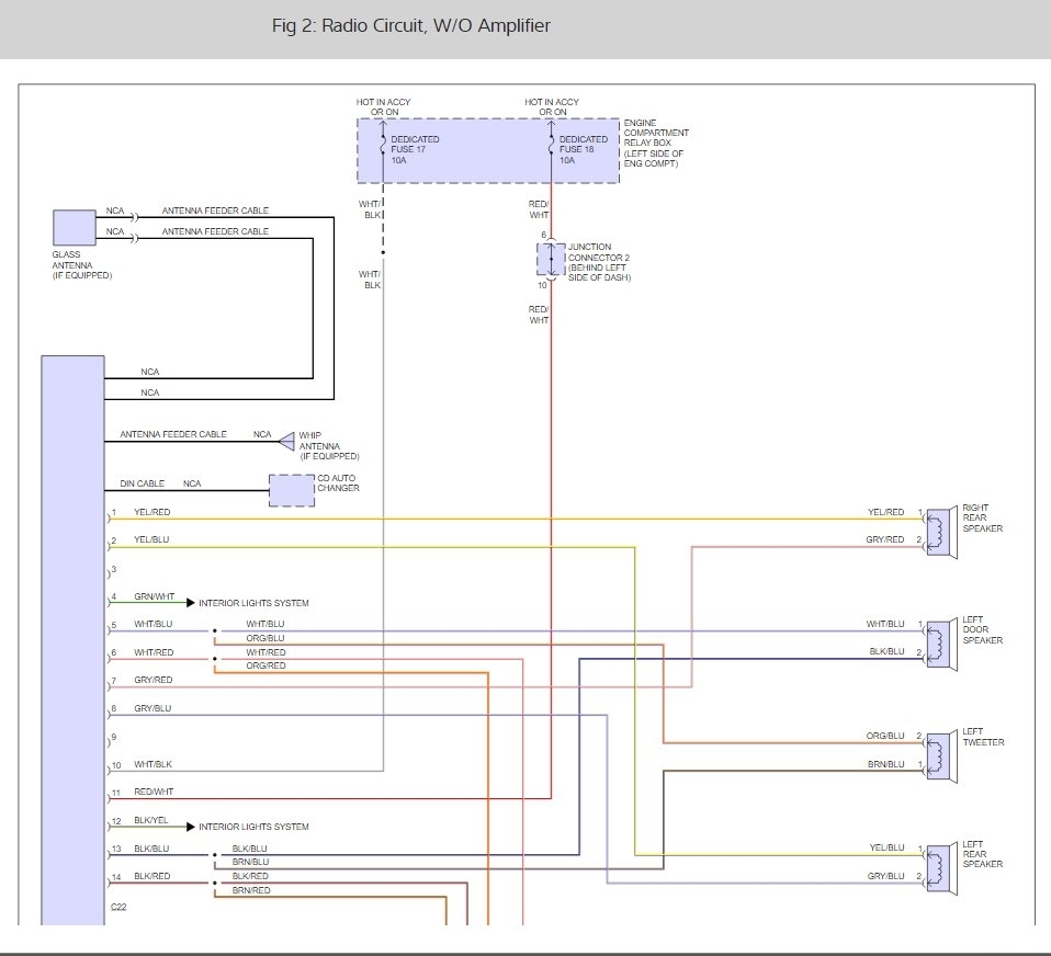

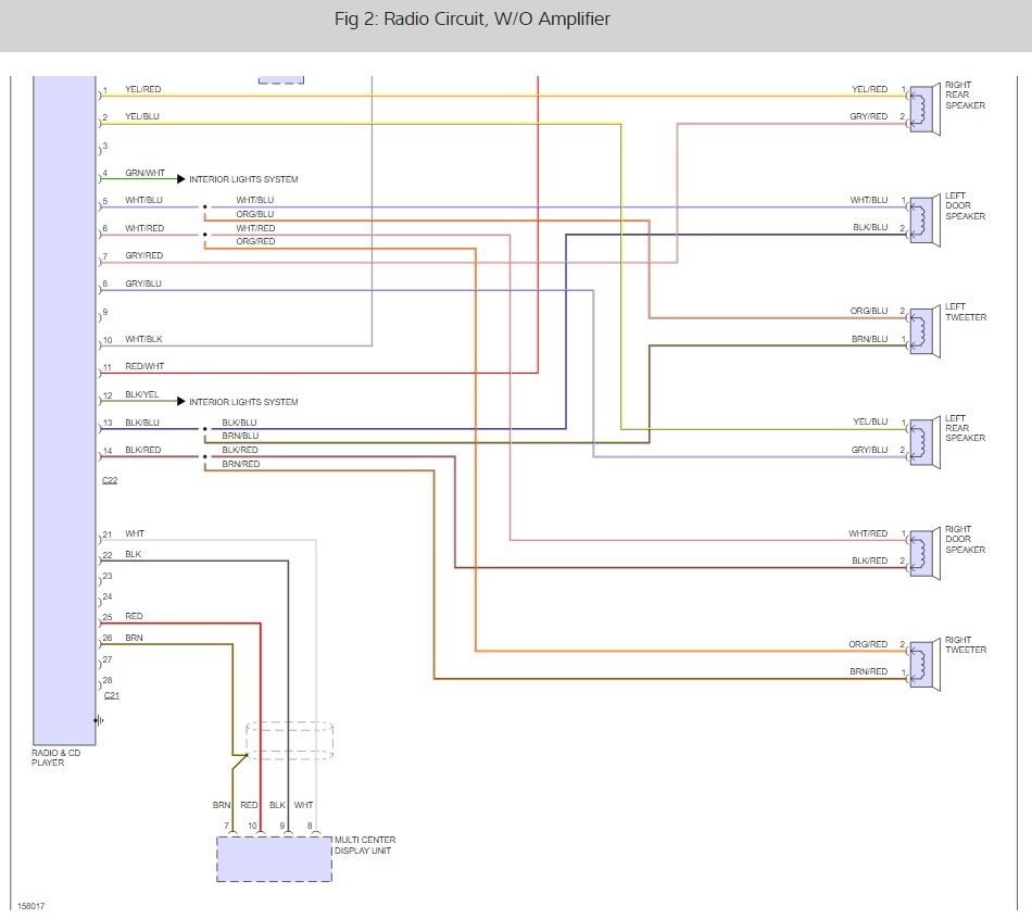

I have found the wiring diagrams and fuse panel diagrams along with a couple of guide to help you get the job done.
and
Check for power going to the radio and make sure there is power on both sides of the fuse for the radio
Please run some tests and get back to us so we can continue helping you.
