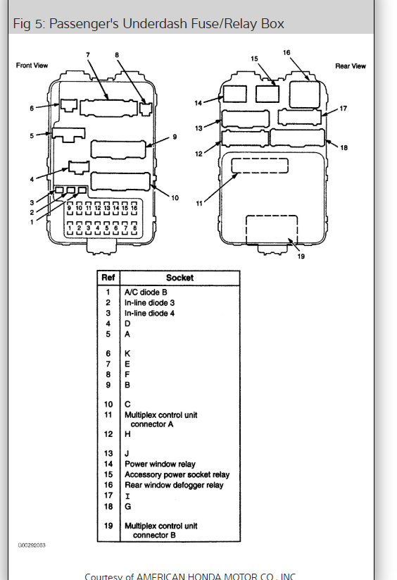

Hi, my car has a navigation system and stereo with 6 disc changer also has camera for when you reverse. One day approximately 2 months ago it just didn't want to turn on. Also the lighter where you charge like a cell phone. I don't know what happened. any help or idea why? And what i need to do? Anything that can help me please.
Jul 30, 2019 at 11:20 PM

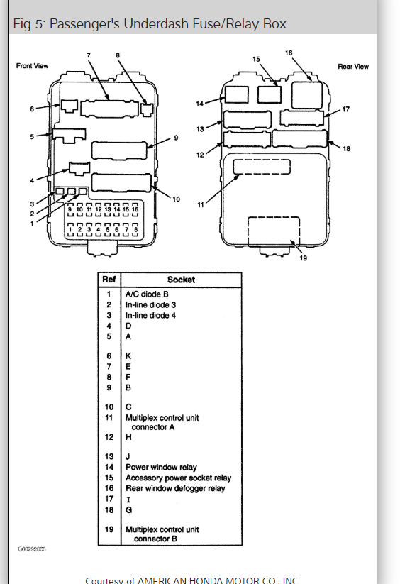

There is a fuse panel on the passengers side that has an accessory power socket relay that needs to be checked. here is a guide and the relay location as well int he diagrams below:
