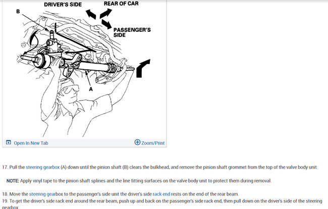

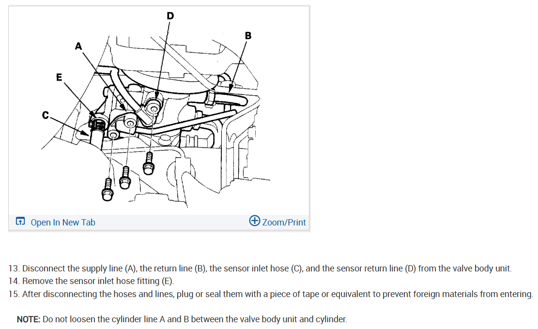

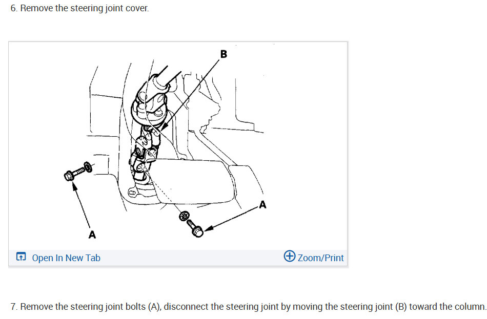

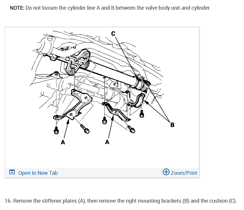

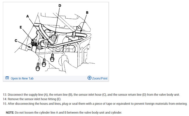

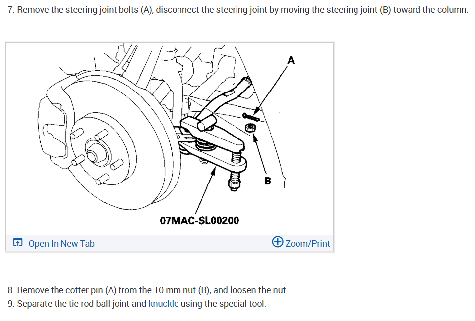

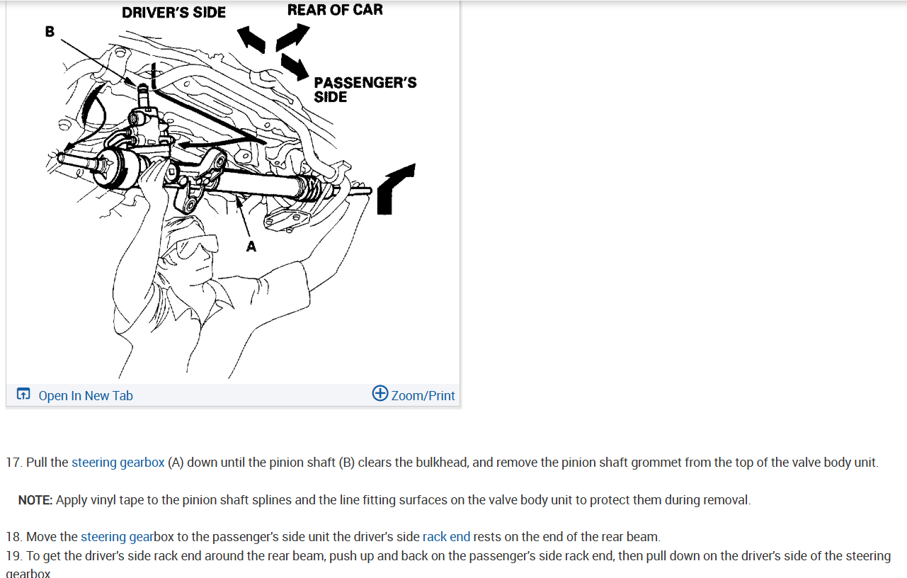

These images should help as well.
Check out the images (below). Please upload an image or a short video in your response, so I can see what's going on.

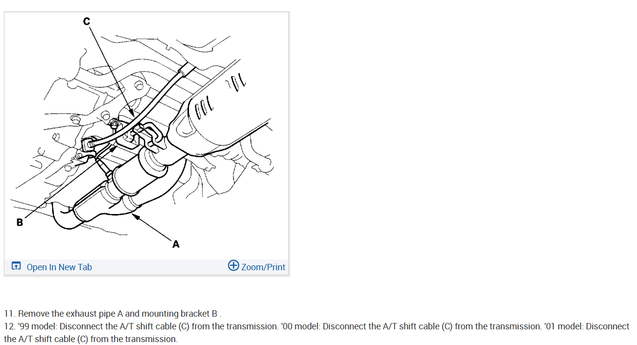

Also, any suggestion on removing seemingly rounded off nuts from the cat? Or is my best bet to drop the whole exhaust
Jan 13, 2026 at 10:24 AM
Yep, you can drop the exhaust system. If the inner seals are leaking the ack is bad, you can get a rebuilt unit which will fix the problem. the video is how to jack up your car correctly.
