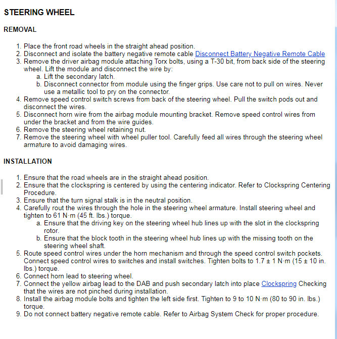

Need to take off steering wheel.
Jul 21, 2019 at 11:54 AM
CERTIFIED EXPERT
18,907 POSTS
Please see the attached instructions from the manual on how to remove the steering wheel.
These are not too detailed so here is a guide that gives a little more general explanation.
https://www.2carpros.com/articles/steering-wheel-removal
