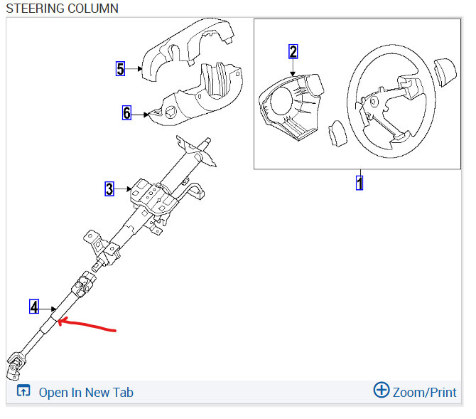

Chances are the squeak is caused by the steering shaft where it goes through the firewall. I would use some WD/40 to help stop the noise. I marked with a red arrow where you should apply the oil. Check out the images (below). Please upload pictures or videos.

Yes, is does happen, if you upload as short video of the noise I can be sure. Please upload the video in your response.

I don't have a video, but I can describe it. It's an intermittent rubber squeak noise like there's tension and it's mainly when I turn the wheel left or right.
Jun 6, 2025 at 1:29 PM
Yep, I would use WD40 at the shaft point above.
