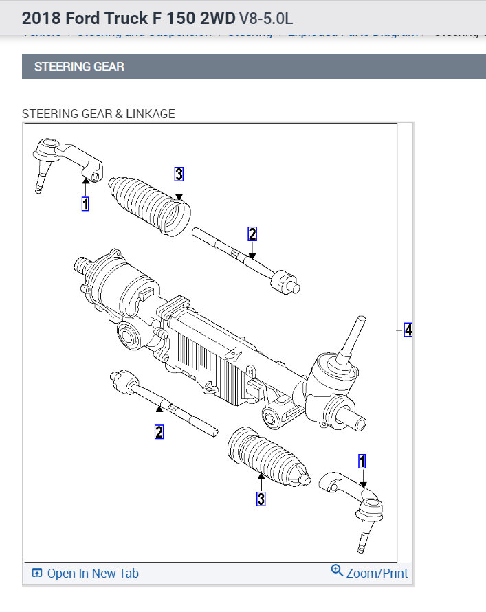

It is tough to tell without a short video of the noise which you can upload with your response. If I had to guess, I would say it sounds like the electronic steering motor inside the rack and pinion is going out which is common.
Power Steering - Overview
Overview
The EPAS system provides steering assist by replacing the conventional hydraulic valve system with a steering gear equipped with an integrated electrical motor and PSCM. The motor operation and level of steering assist provided is controlled by the PSCM.
Check the images below. Please let me know and upload a video so I tell for sure what's going on.
