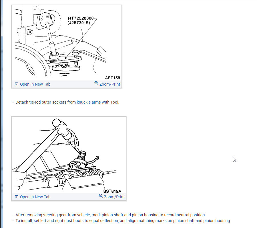

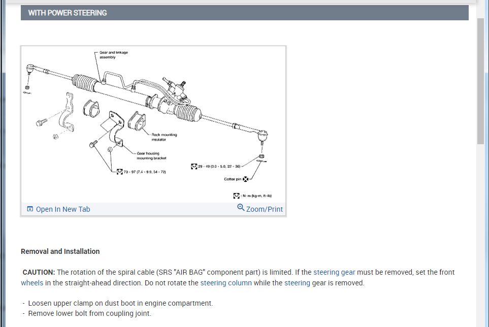

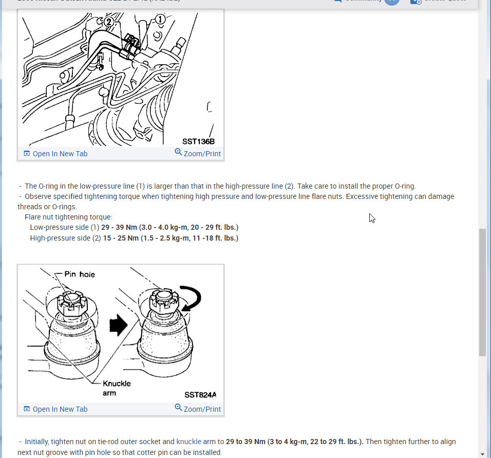

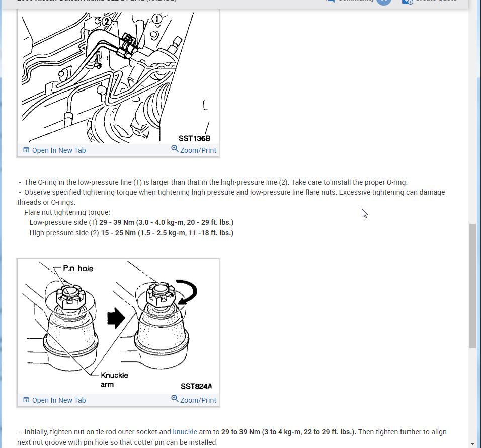

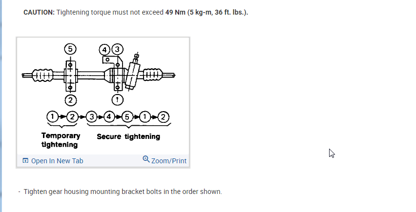

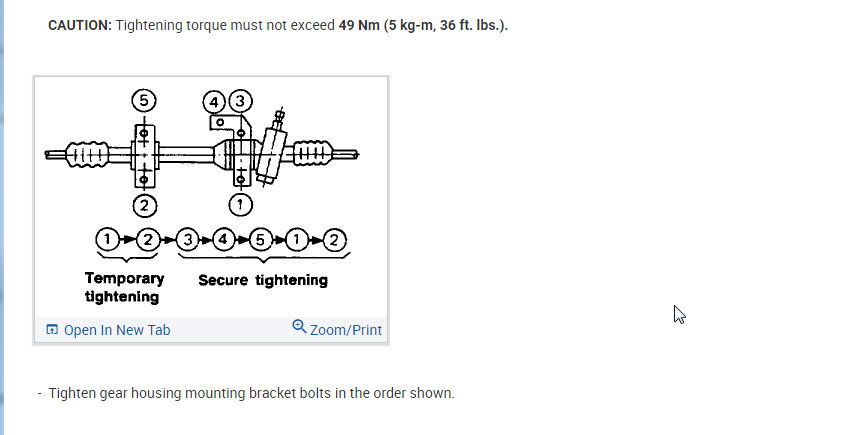

We don't have a manual on this vehicle but it appears you have a similar vehicle to the one I attached below. So if you can get a video of this happening we will have a better idea but I would think this is a steering gear issue or a component that is attached to the gear like a tie rod is loose. Either way, we need to inspect these steering components and make sure they are all tight.
