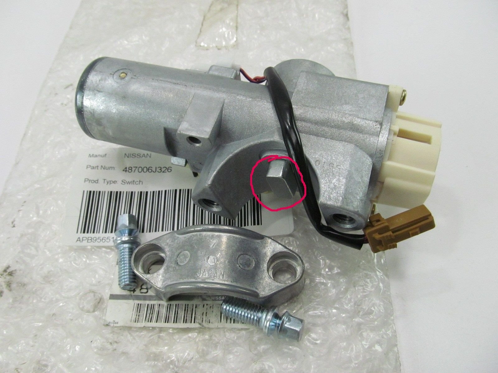

After removing the entire Ignition Cylinder, I found that the key now turned freely in the lock cylinder and the spring activated "steering wheel lock" "button" (or hunk of metal) as Steve W. called it (See the image Steve posted above) worked fine.
I oiled the spring "button" lightly with machine oil and added white lithium grease. I added powdered graphite to the key cylinder.

After removing the ignition assembly and replacing it, I'm convinced that the steering wheelkey lock problem that started this repair thread was caused by a common combination of circumstances. My wife parked the vehicle with one wheel slightly up on a rounded curb, and then we tried forcing the steering wheel while turning the key. This resulted in the "steering wheel lock button" getting jammed up in the steering wheel slot.
The only way to release this "jam" was remove the ignition lock cylinder.

Another fix/option I considered but did not opt for was locking the steering wheel lock "button" in the down position where it could not possible lock the wheel. If this extreme hard steering wheel lock situation occurs a second time, I would try this before spending the several hundreds of dollars for a new ignition switch, new keys and dealer reprogramming.
