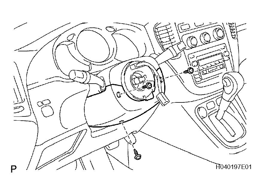

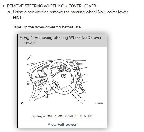

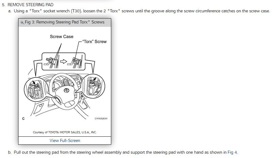

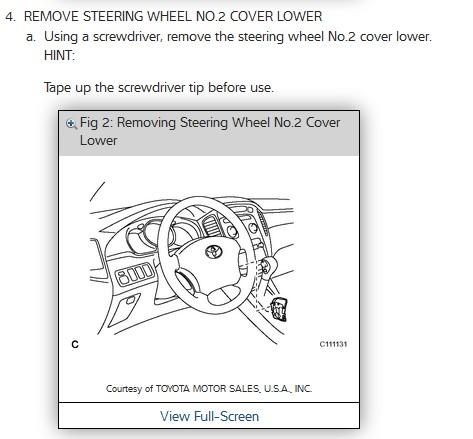

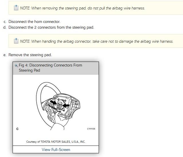

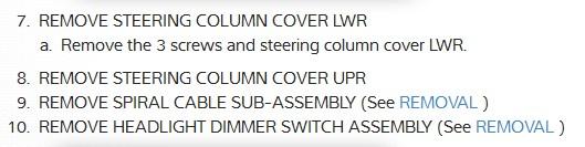

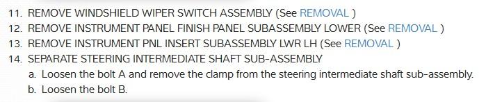

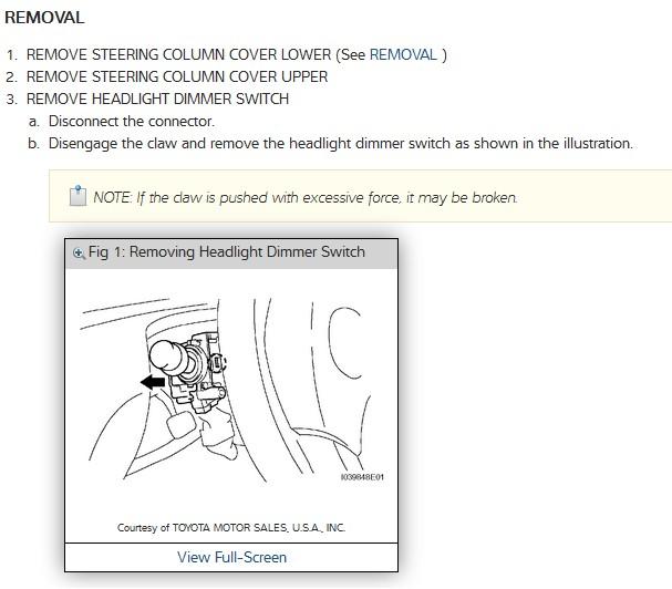

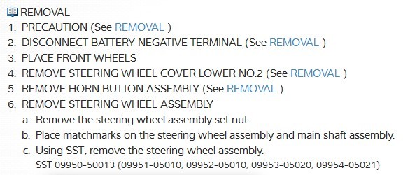

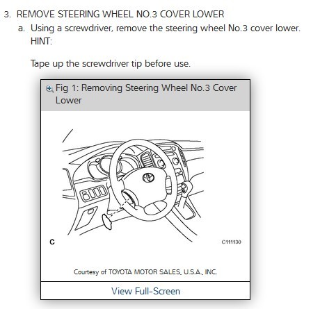

Can you please tell me how the horn pad comes off the steering wheel on a 2006 Toyota Highlander Limited.
I need to replace the cruise control switch lever which is broken.
I would also like to know the cost of the cruise switch lever,
My vehicle has automatic light control, but that switch lever on the other side is working fine.
Any help you can give will be greatly appreciated.
