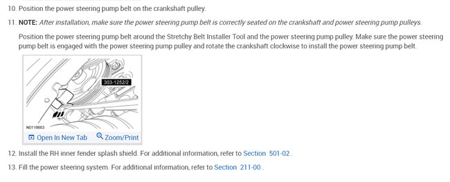

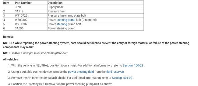

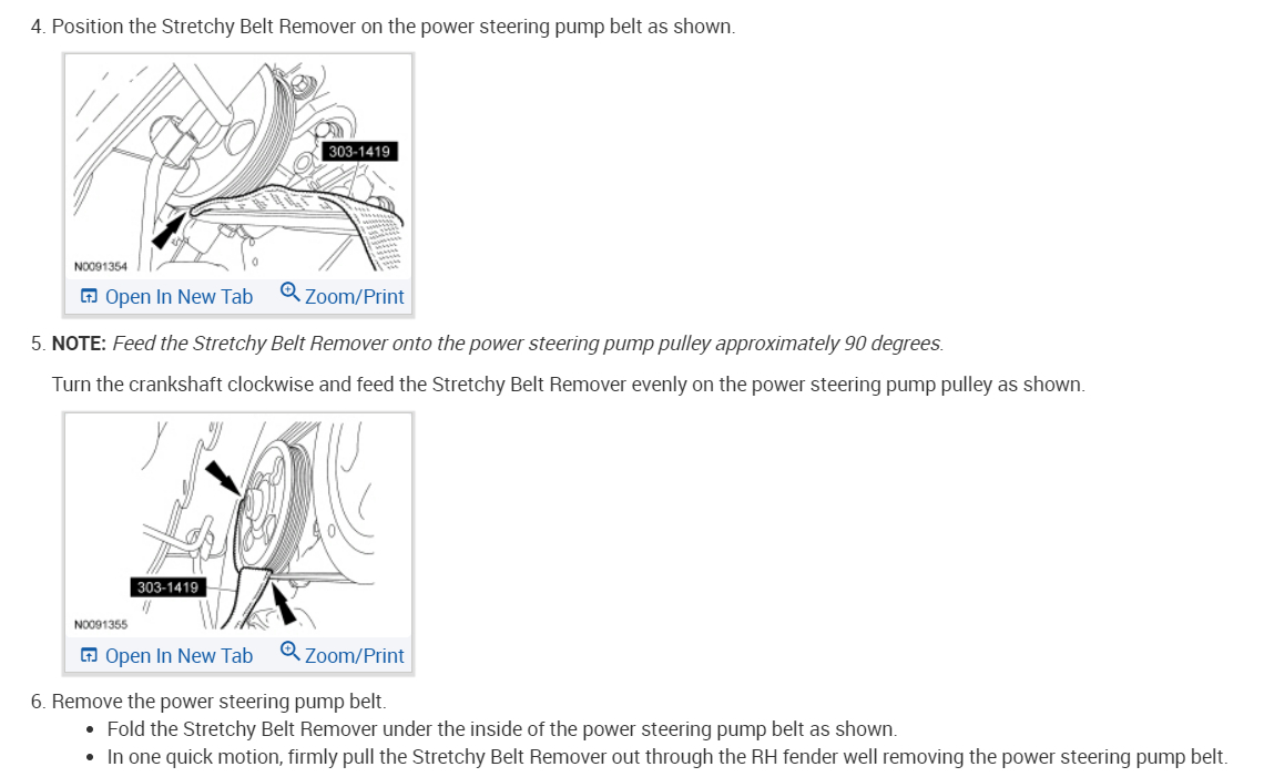

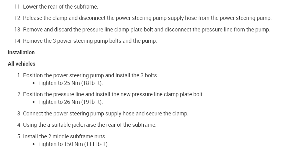

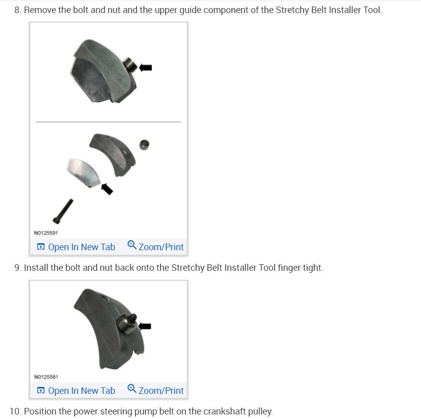

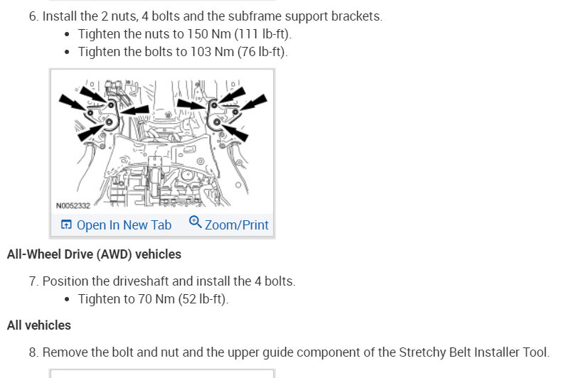

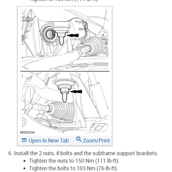

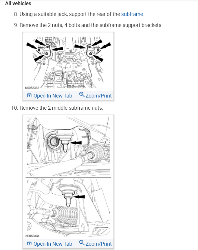

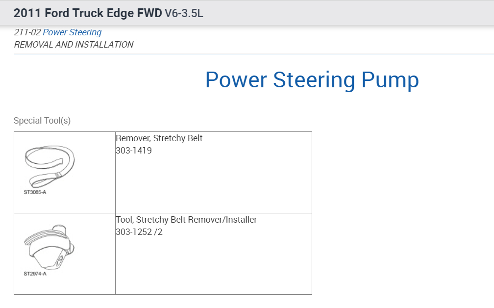

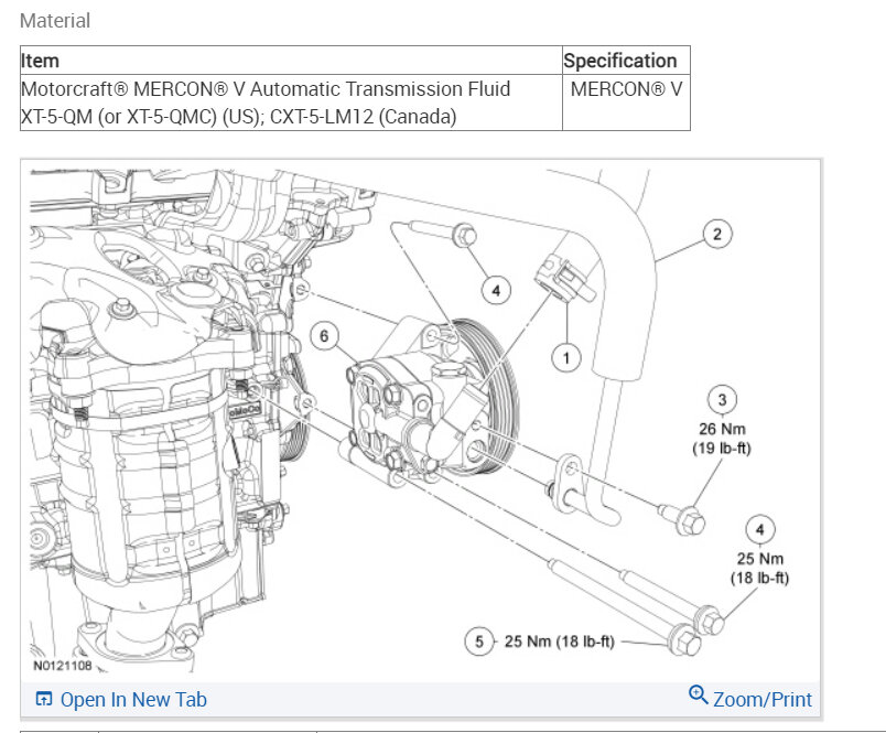

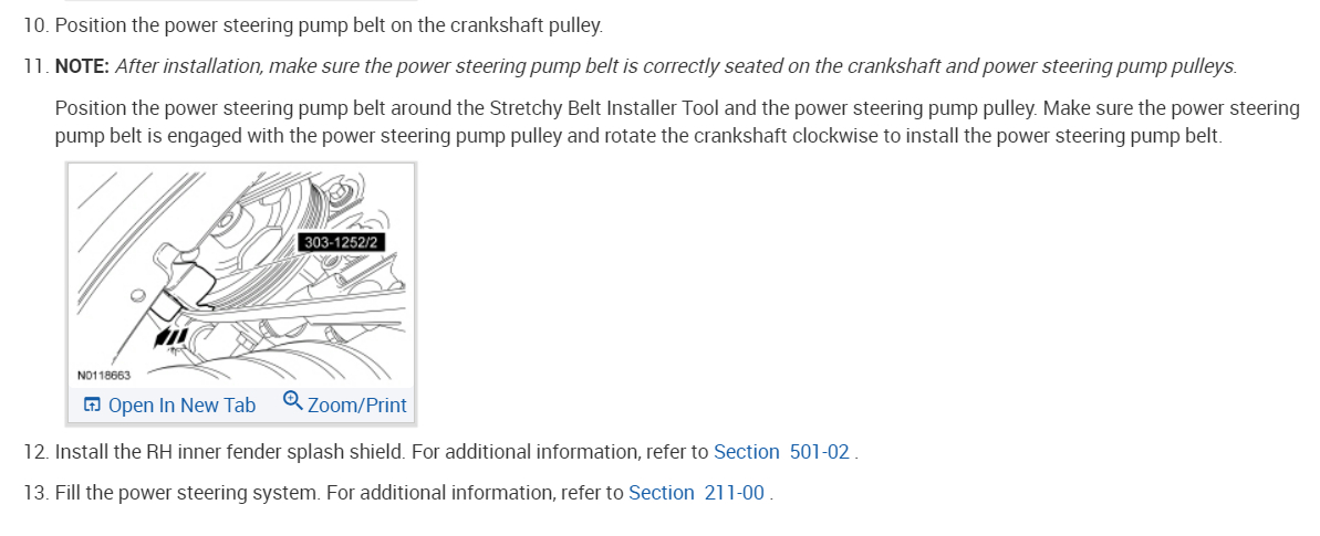

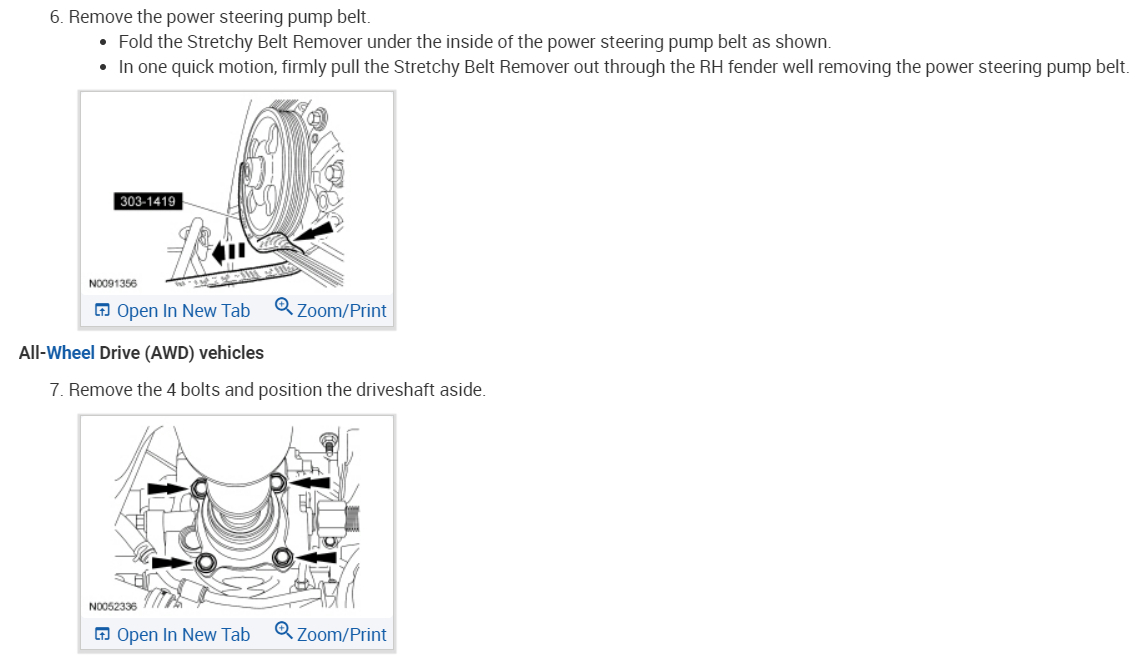

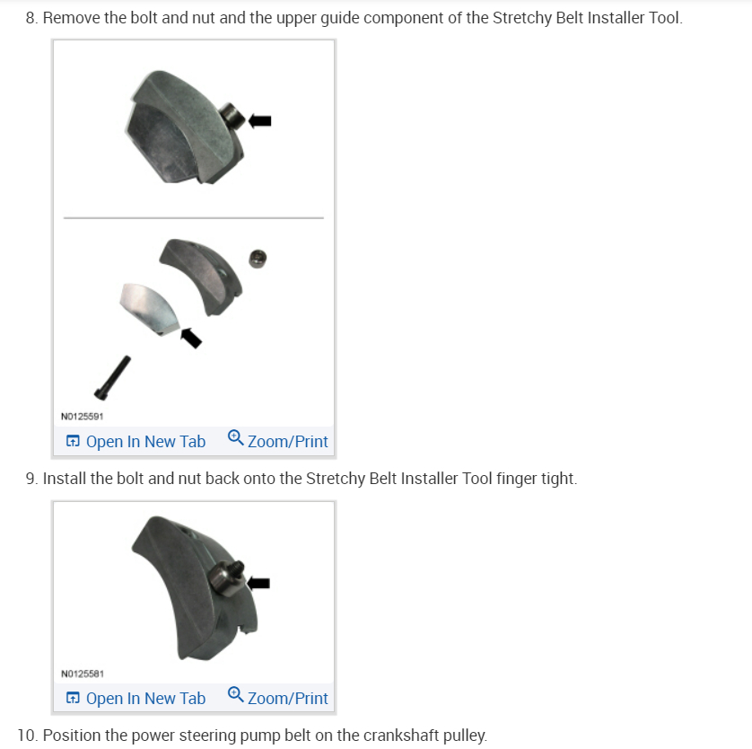

Can you hear the power steering system laboring when you turn it, also I would lift the front off of the ground to see if it gets any easier. Here are the instructions for changing the power steering pump out in case you need it. This guide can help as well:
https://www.2carpros.com/articles/comprehensive-guide-to-diagnosing-and-resolving-hard-steering-in-automobiles
