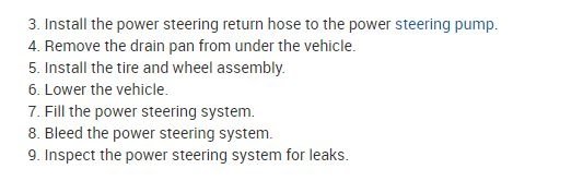

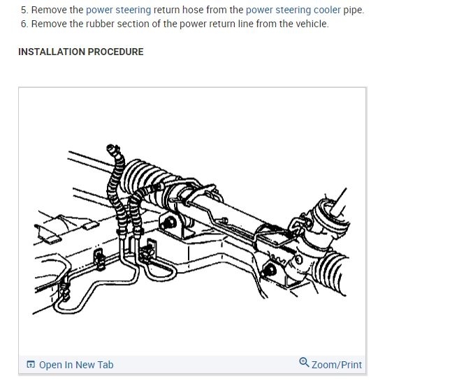

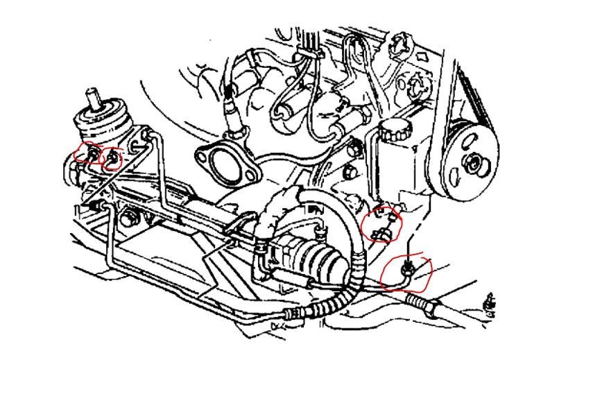

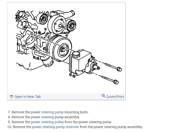

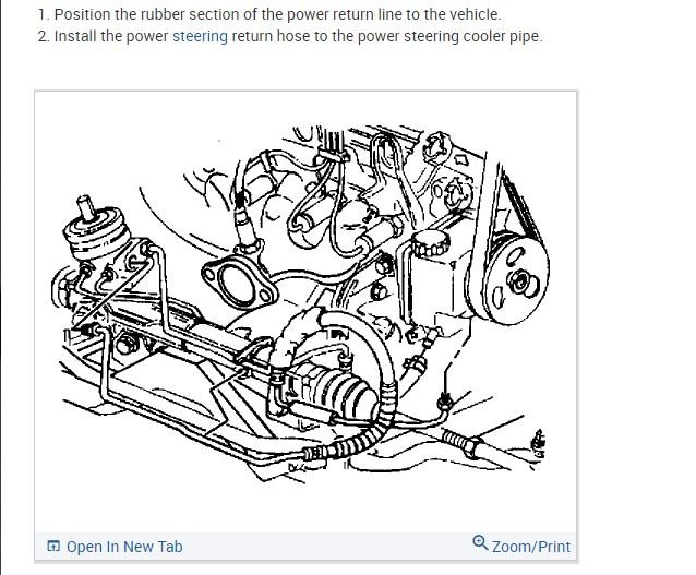

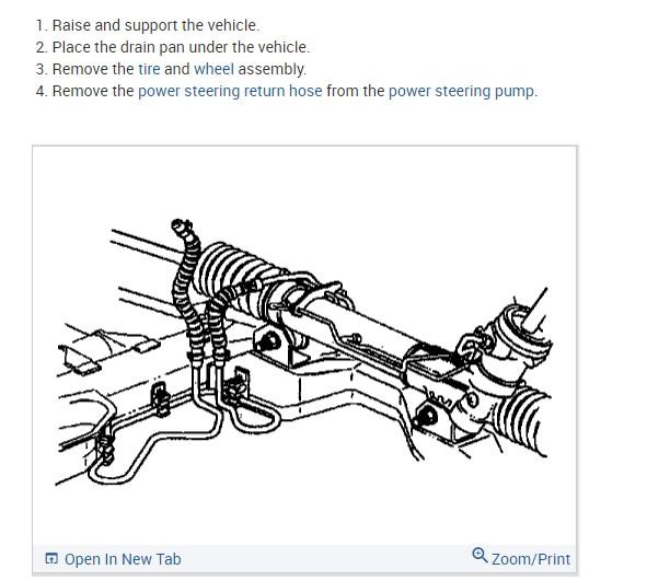

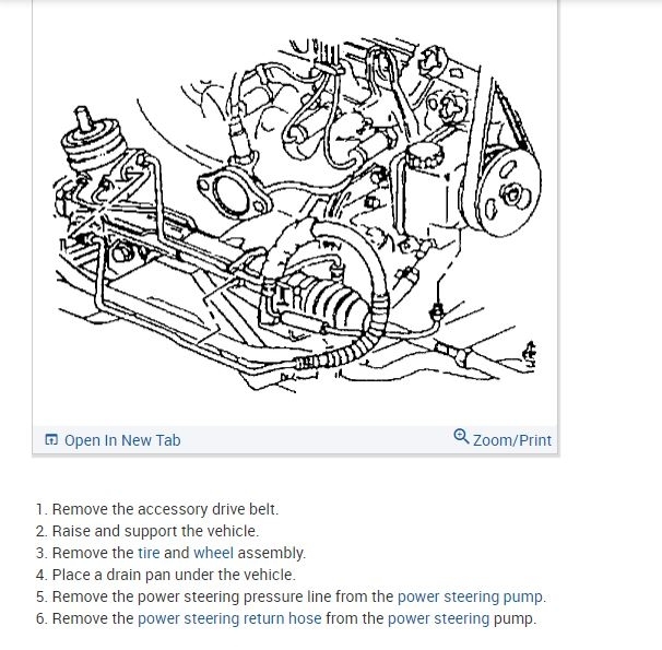

It could be but the lines are more common than the pump. I attached the procedure for replacing both the lines and the pump.
https://www.2carpros.com/articles/how-to-replace-a-power-steering-pump
Once the leak is determined, then you know what to replace. I attached guides for you for determining the leaks.
https://www.2carpros.com/articles/power-steering-problems
https://www.2carpros.com/articles/power-steering-fluid-flush

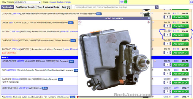

If it's not the pump. how do I look up to purchase the lines?
Is there an item number to look for and where can I find them? Now, is this a very expensive job to replace the lines? How about replacing the pump, how expensive is the labor on this procedure?
Apr 11, 2021 at 10:24 AM

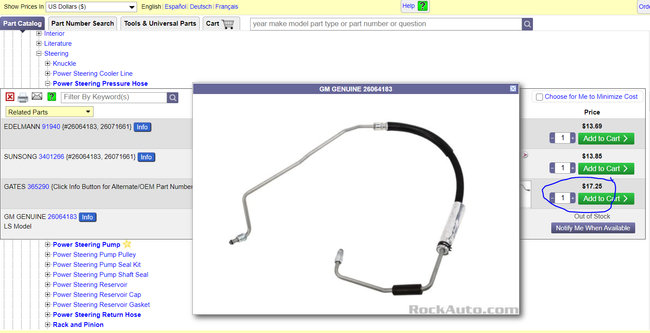

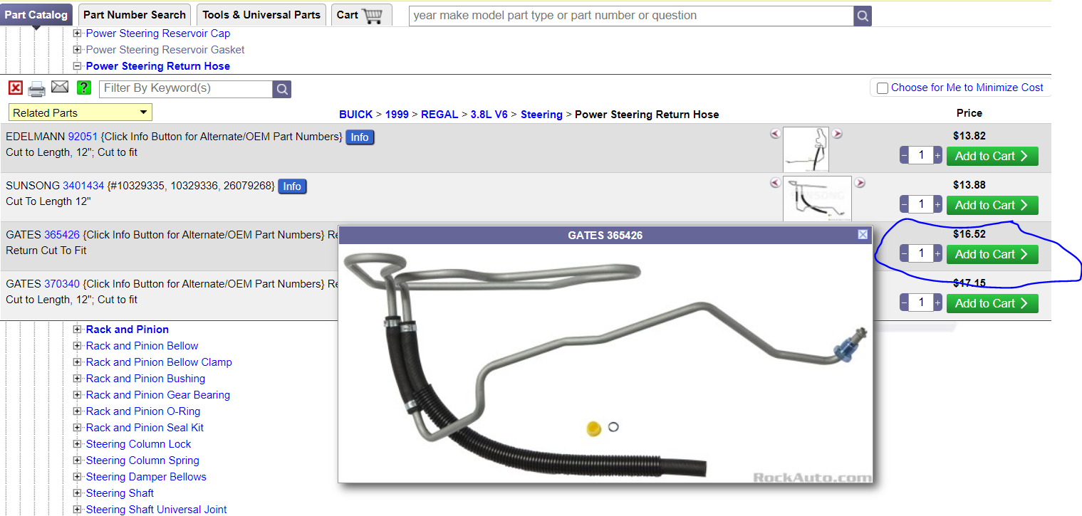

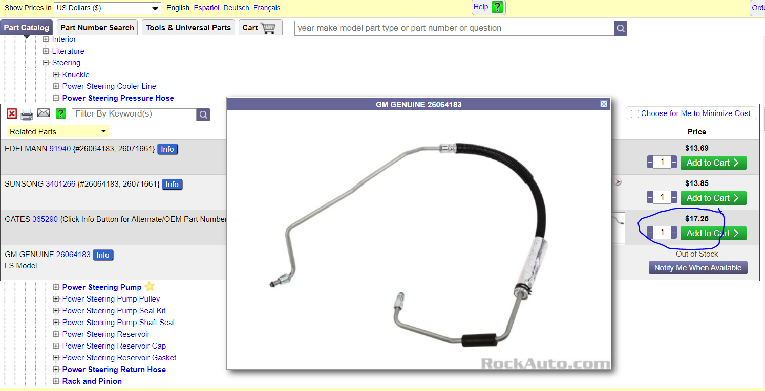

Okay, the labor is 3 hours in a shop. That comes to arounds $350.00 to $400.00 depending on your area.
I attached the parts below for you from Rock Auto.
The total for parts is about $70.00 to $75.00.

If the problem are the lines, I need to order both pictures of cables?

If one line is leaking, I would replace both lines.
If the pump is leaking, just replace the pump.
