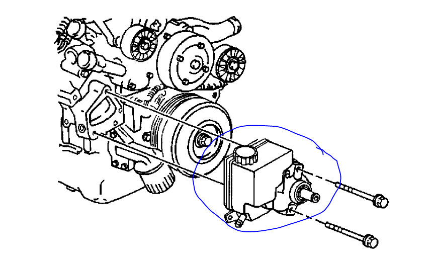

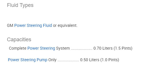

Where can I find the steering wheel fluid reservoir and how much should I put? What brand is the best?
Oct 25, 2019 at 1:51 PM
Good afternoon,
The fill is on top of the pump. The pump is at the bottom of the engine back by the firewall. It is a pain to get back there to the fill cap. You will need a long thin funnel to add the fluid.

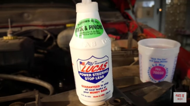

What do you think about this product? It claims to stop leaks.

Okay, no sealer, ever. That stuff is junk and never works.
It will not stop the leak and will destroy the seals and you will end up replacing the pump and steering rack.
