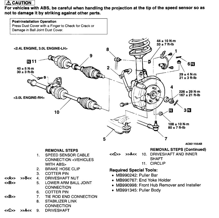

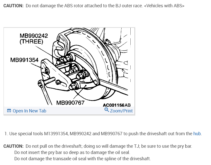

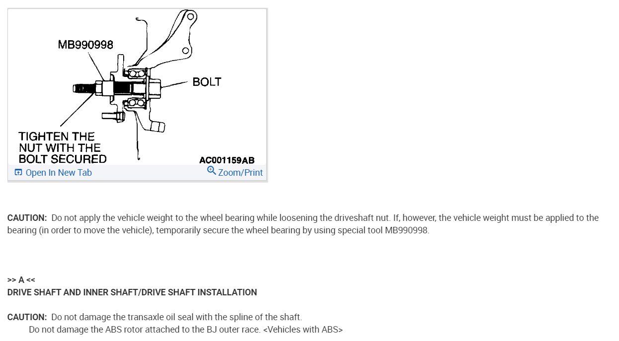

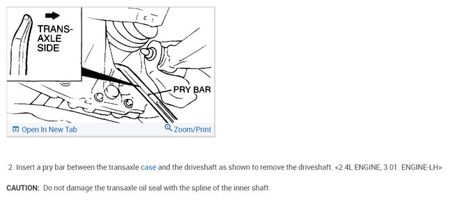

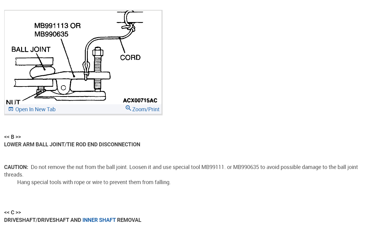

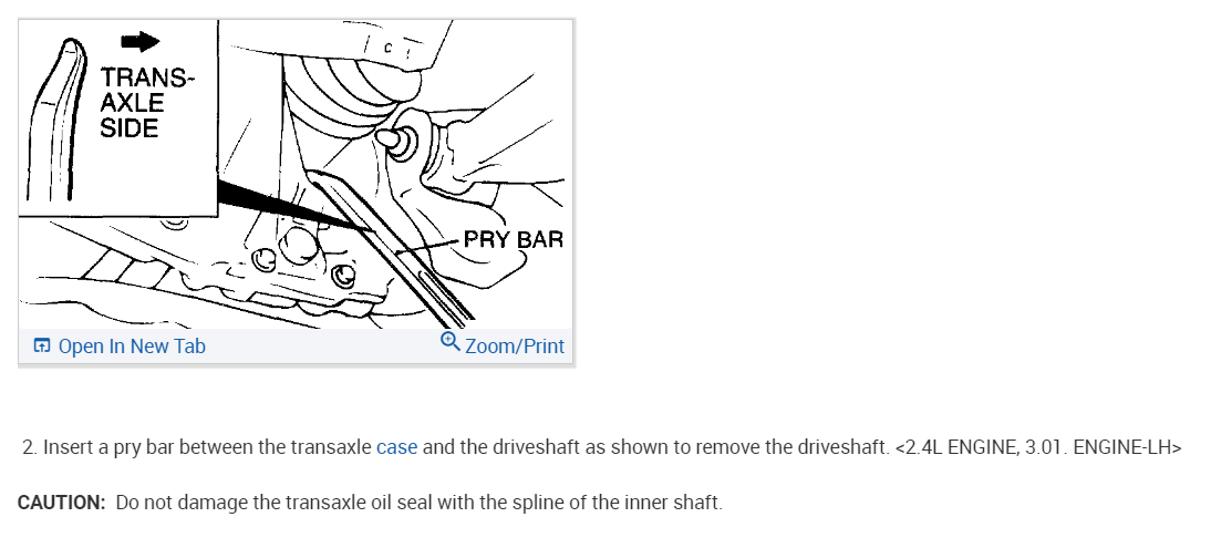

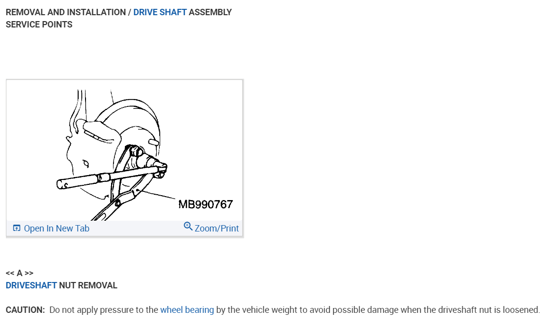

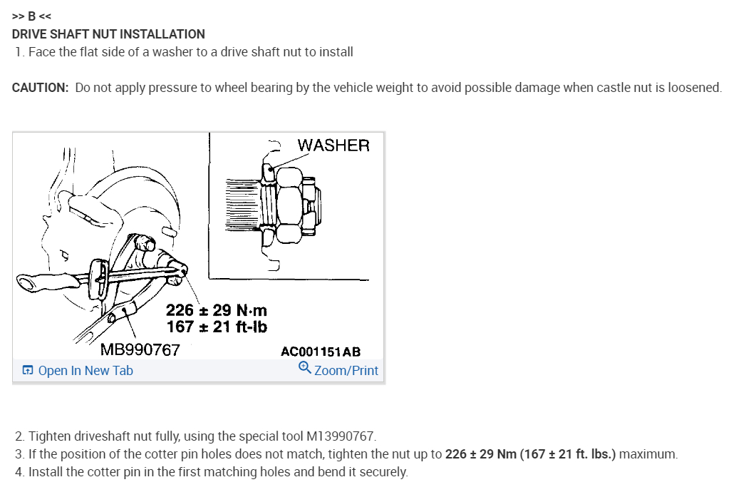

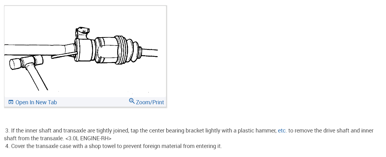

It sounds like the CV axles need to be replaced, which is common. Can you please shoot a quick video with your phone so I can hear the noise? That way I can tell for sure what's going on. You can upload it here with your response. Here is a generic guide to help you step by step with instructions in the diagrams below to show you how on your car:
https://www.2carpros.com/articles/replace-cv-axle
Check out the images (below). Please upload pictures or videos of the problem so we can see what's going on.

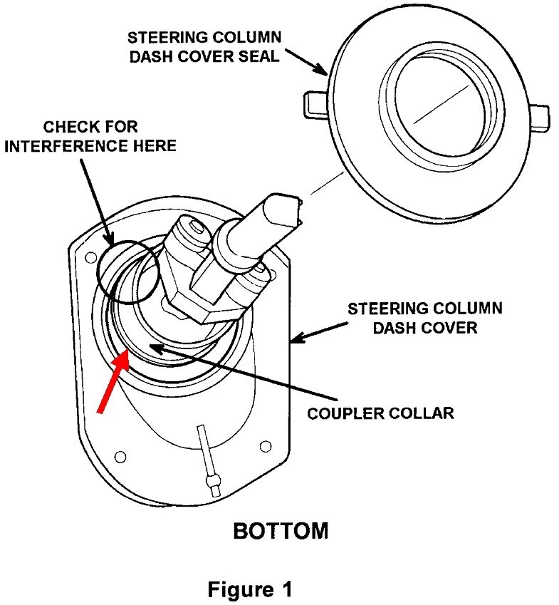

This drawing shows the seal for your car. It looks much like those on the Neons, but I don't see that hard rubber cover. The tip of my red arrow is touching the edge of the seal that must be pulled back to squirt in the grease. If you don't have a cotter pin pick, I would use one screwdriver to stick in under the seal and hold it away a little, then put some light wheel bearing grease on the tip of a flat-blade screwdriver, and stuff that in there. Remove the first screwdriver, then the lip of the seal will wipe the grease off the second one and leave it in there as you pull it out.
If this doesn't help, I'll be sitting in my corner waiting in case you need more of my wondrous wisdom, and to learn the solution.
