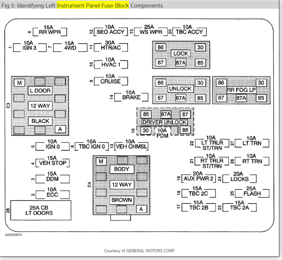

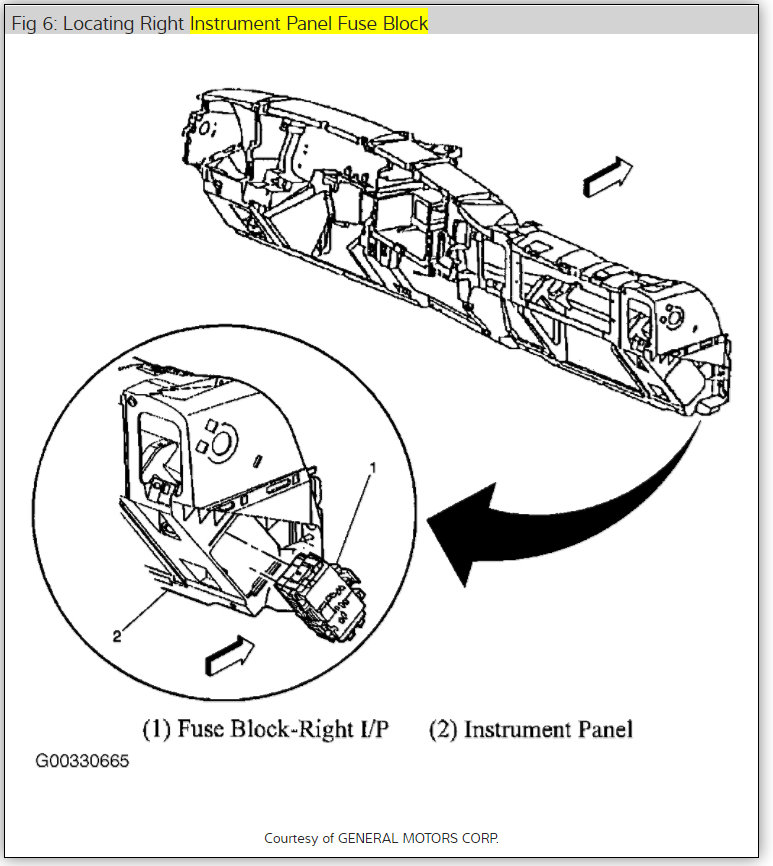

Lets check the fuses first. here is a guide to help and the fuse locations below:
Jul 15, 2019 at 12:59 PM

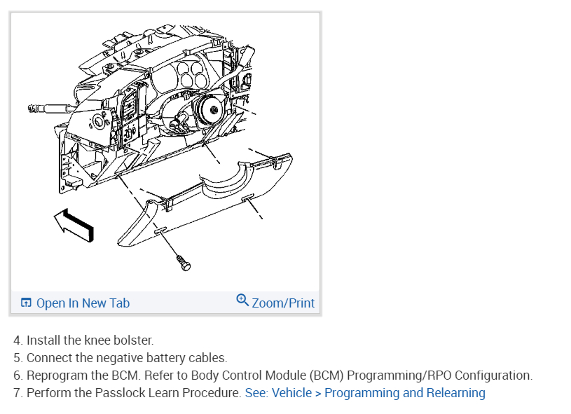

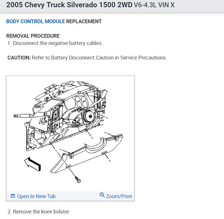

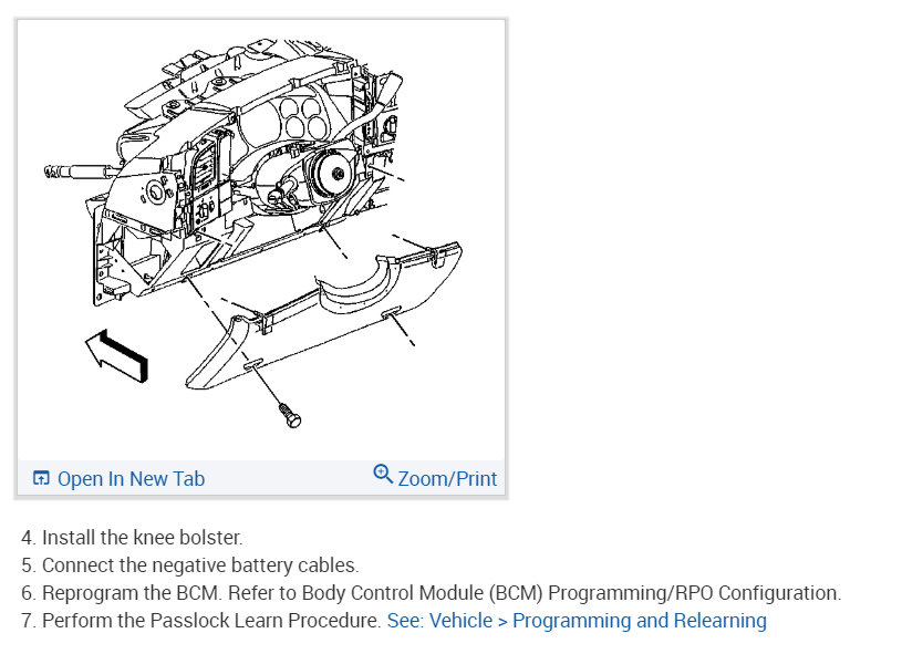

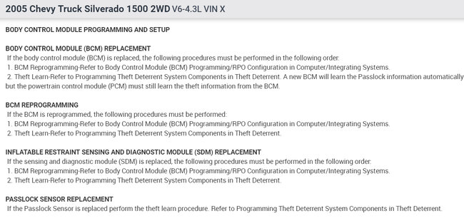

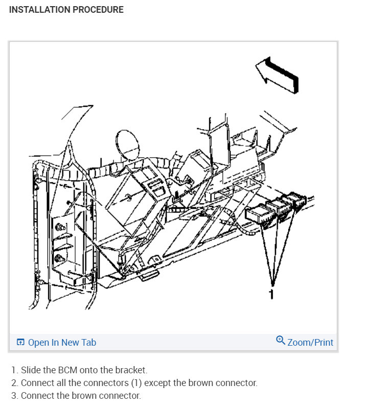

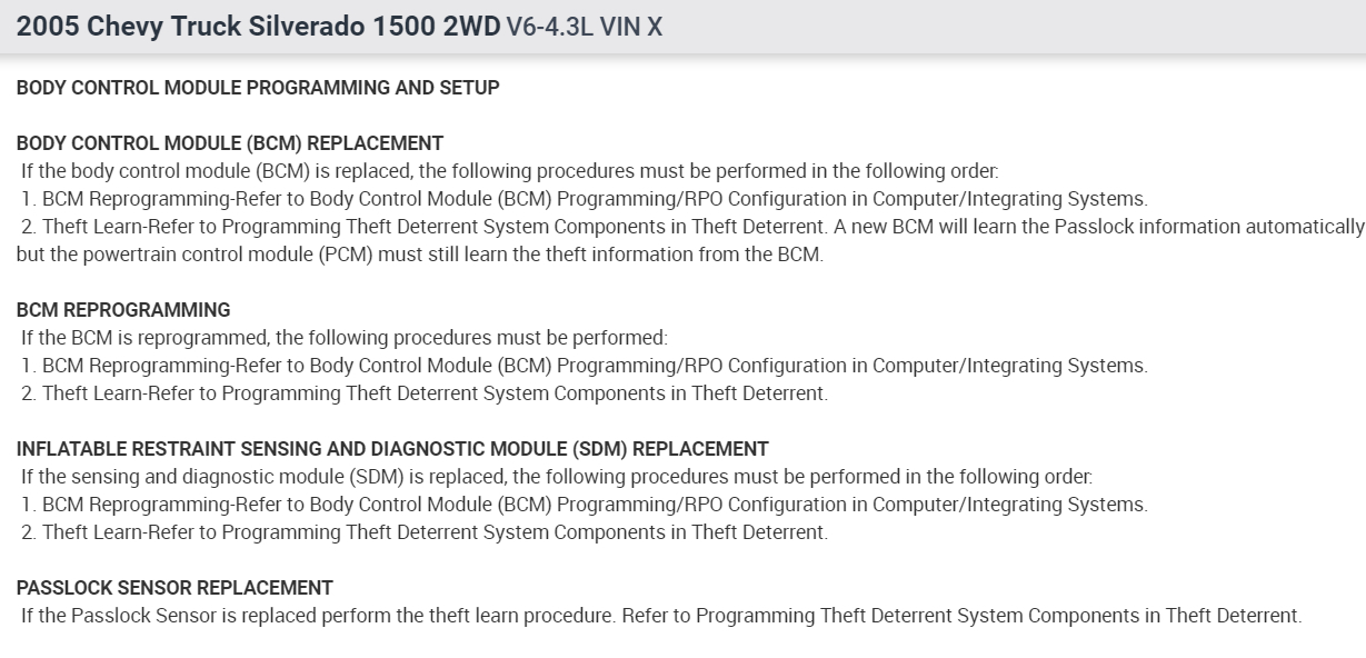

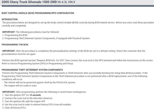

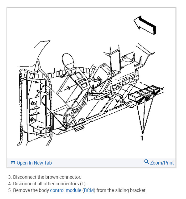

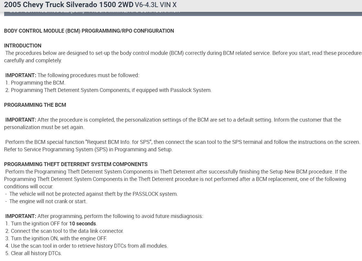

This sounds like a BCM problem. here is a video to help you scan the CAN system to confirm and the BCM replacement instructions and locations below:
https://youtu.be/InIlnsjOVFA
You can get a CAN scanner from Amazon btw. I would check the electrical connector at the BCM for corrosion/moisture.
Check out the diagrams (below). Please let us know what you find.
