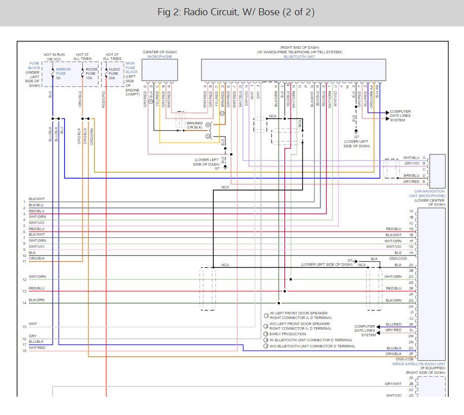

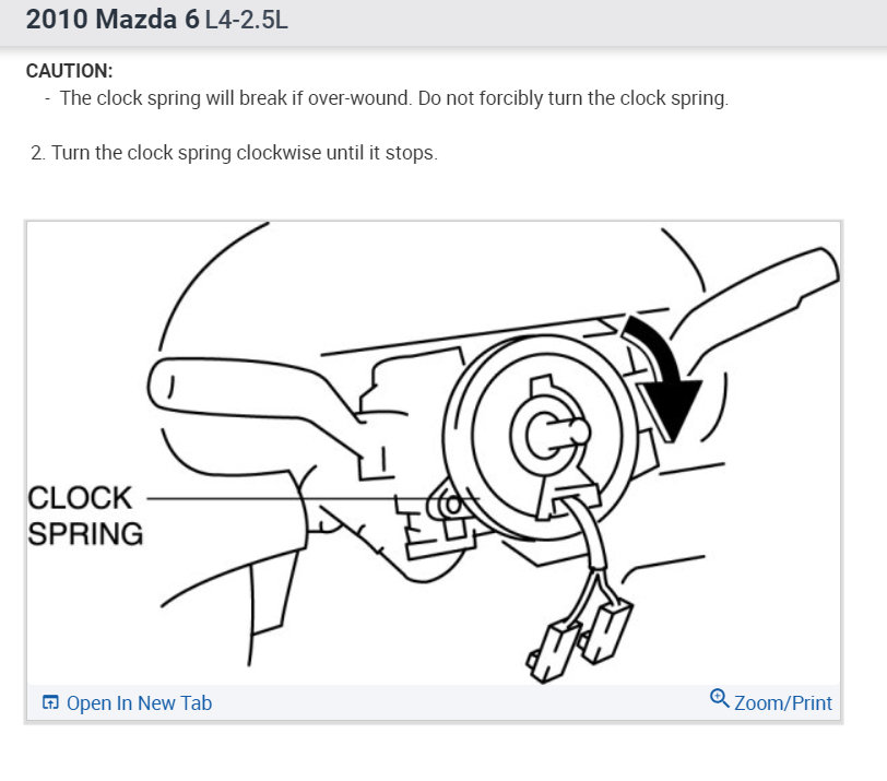

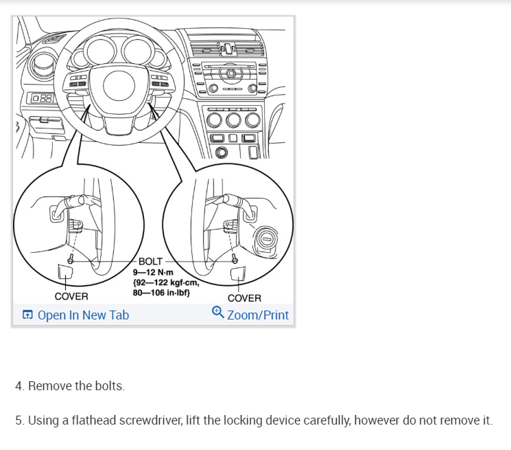

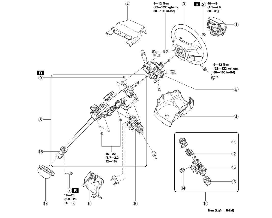

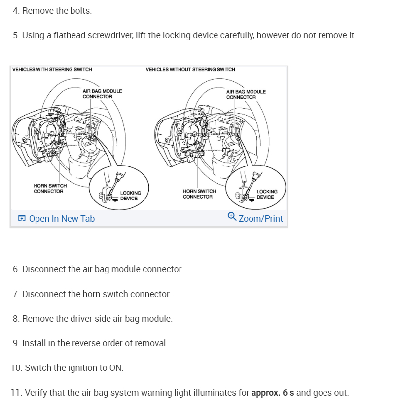

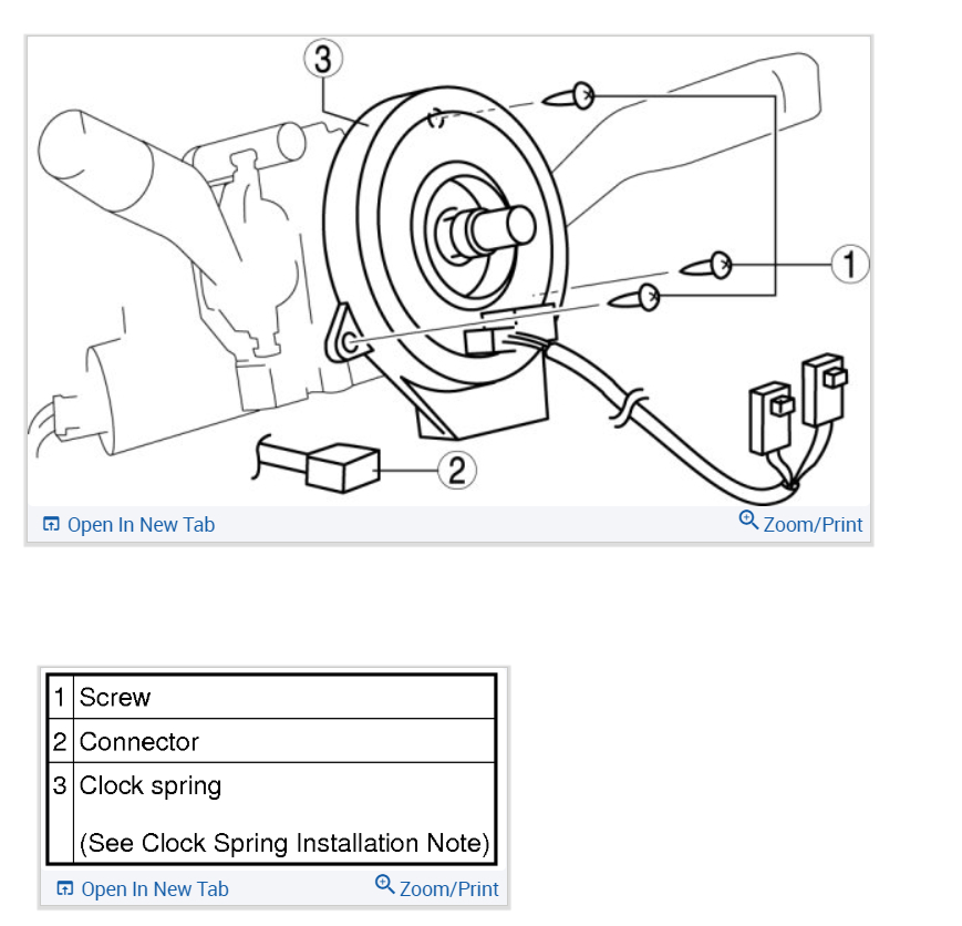

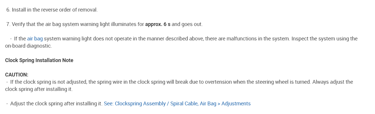

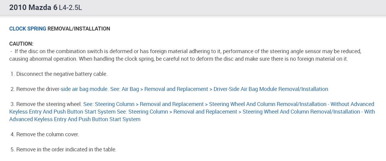

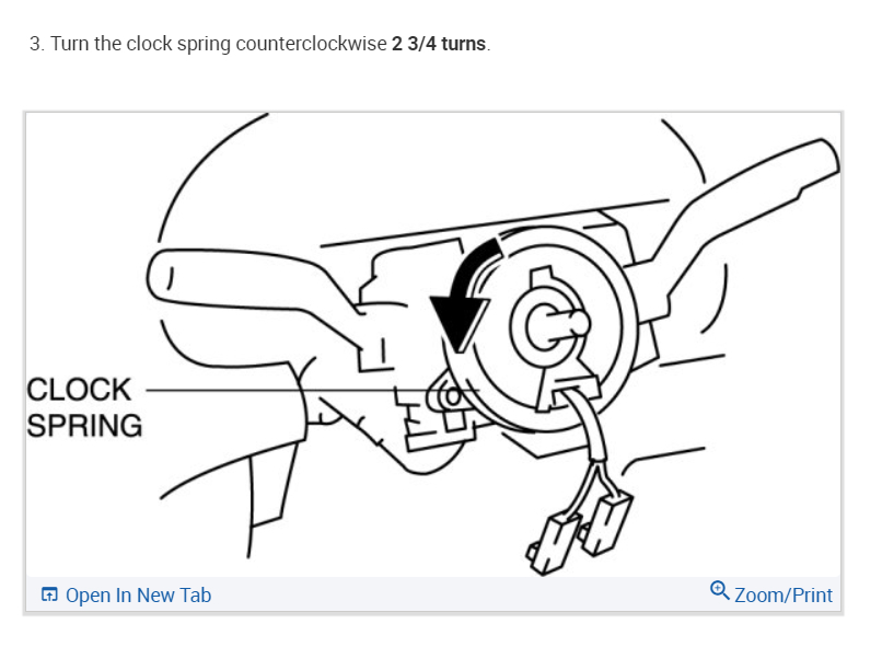

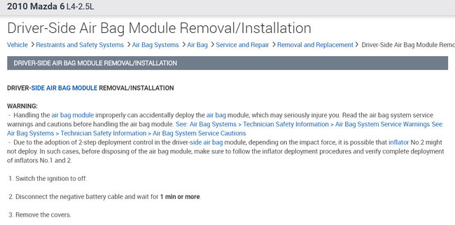

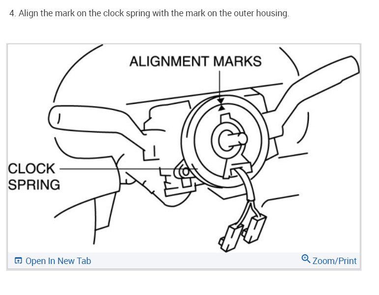

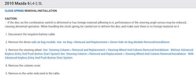

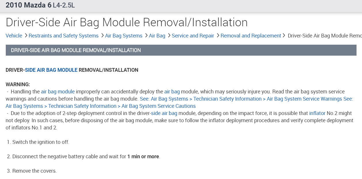

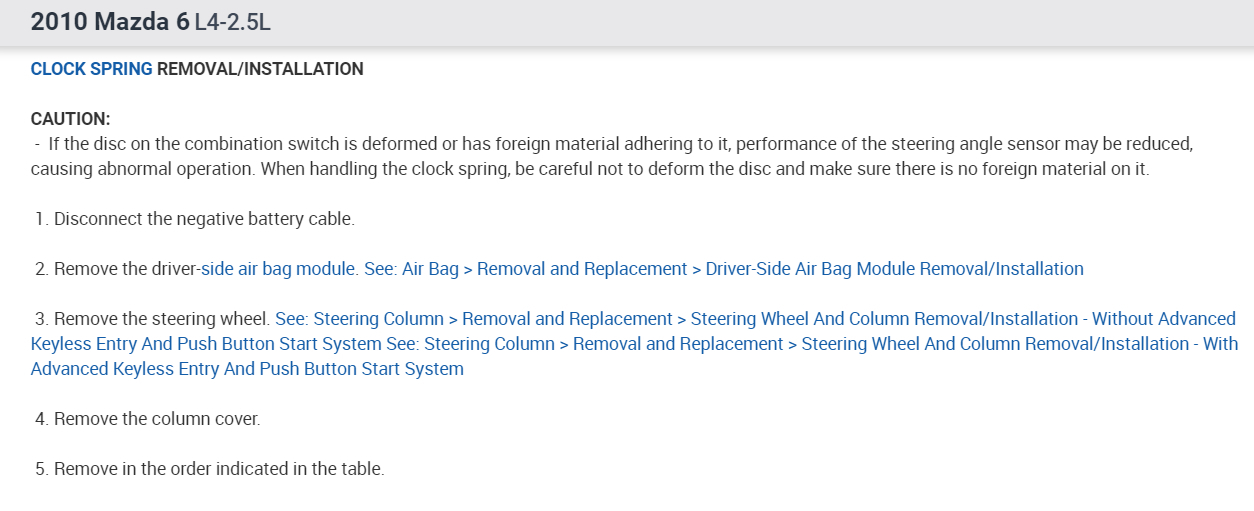

This is common when the clock spring goes bad, I have included the instructions on how to change it in the diagrams below. Can I ask if you have had any steering work done recently? If so they can make a mistake by turning the wheel which breaks the spring. Check out the diagrams (below). Please let us know what you find. We are interested to see what it is.
Jun 1, 2020 at 12:32 PM

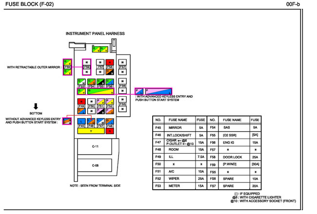

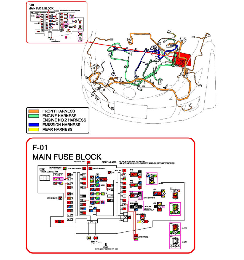

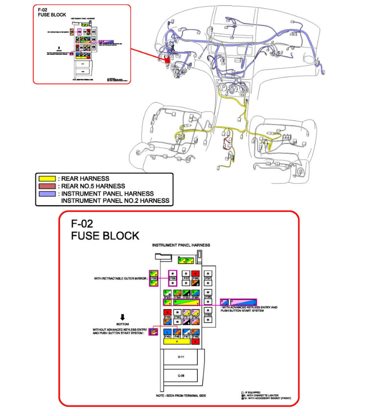

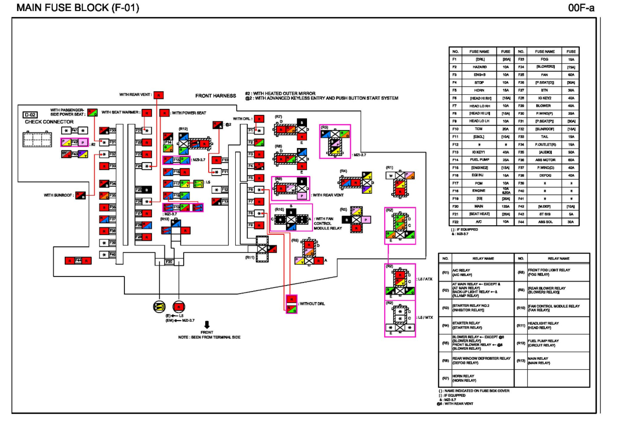

Okay, lets check all fuses to start. here is a guide to help and the fuse locations please test the fuses with the key on:

All fuses are okay!

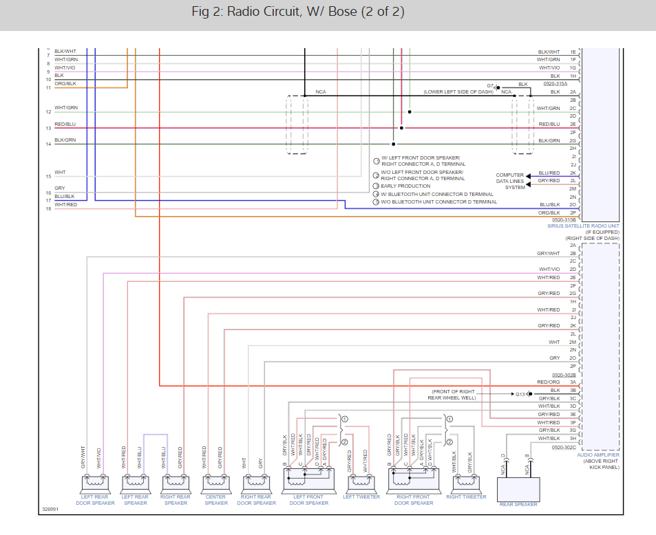

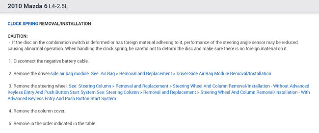

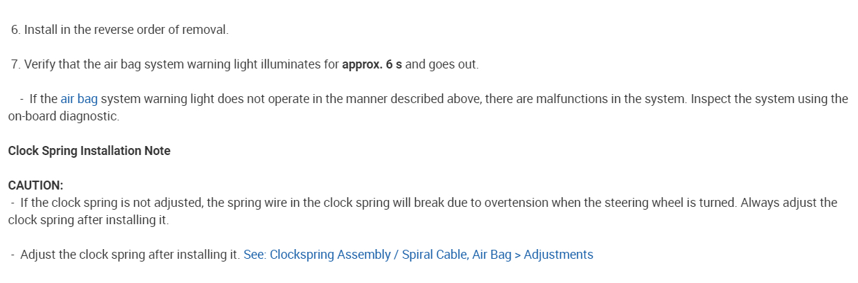

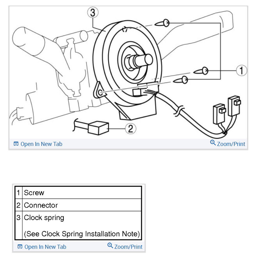

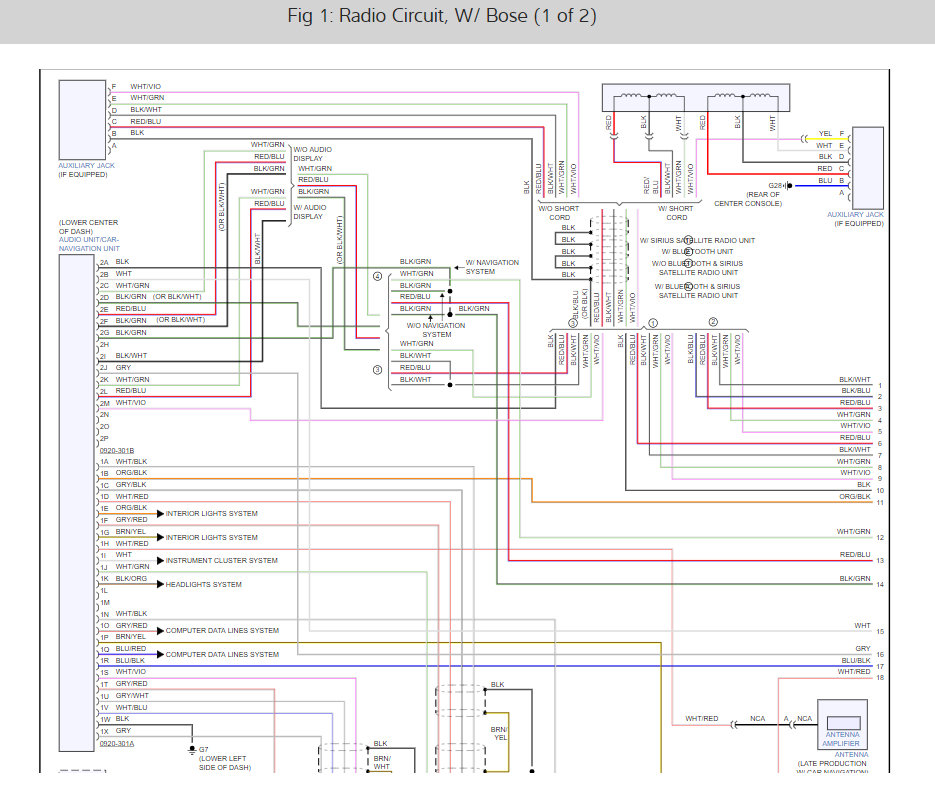

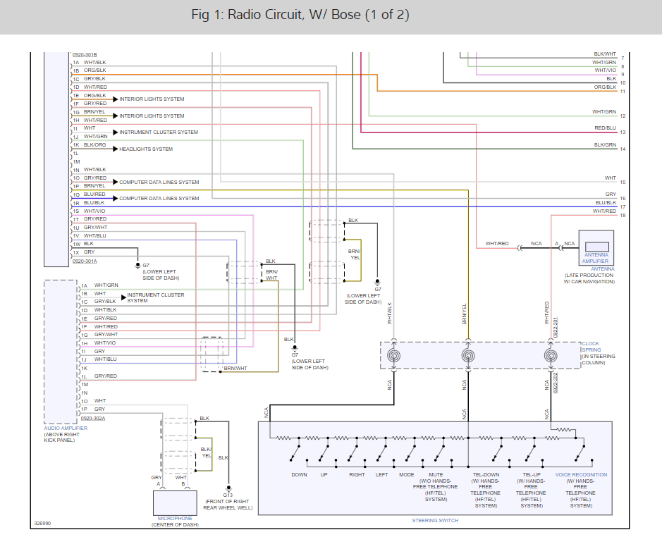

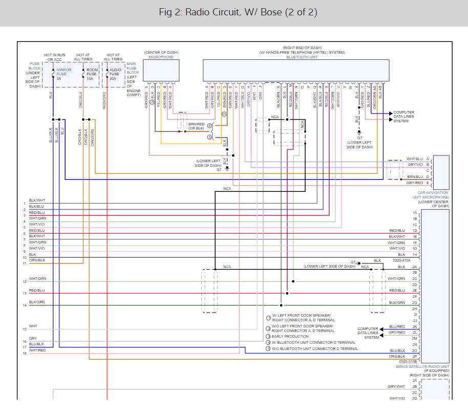

Good to hear, it still can be the clock spring because it control the mode function. The only way to be sure is to test the spring. here is a guide and the radio wiring diagrams along with the instructions on how to remove the clock spring:
Jun 8, 2020 at 10:32 AM
