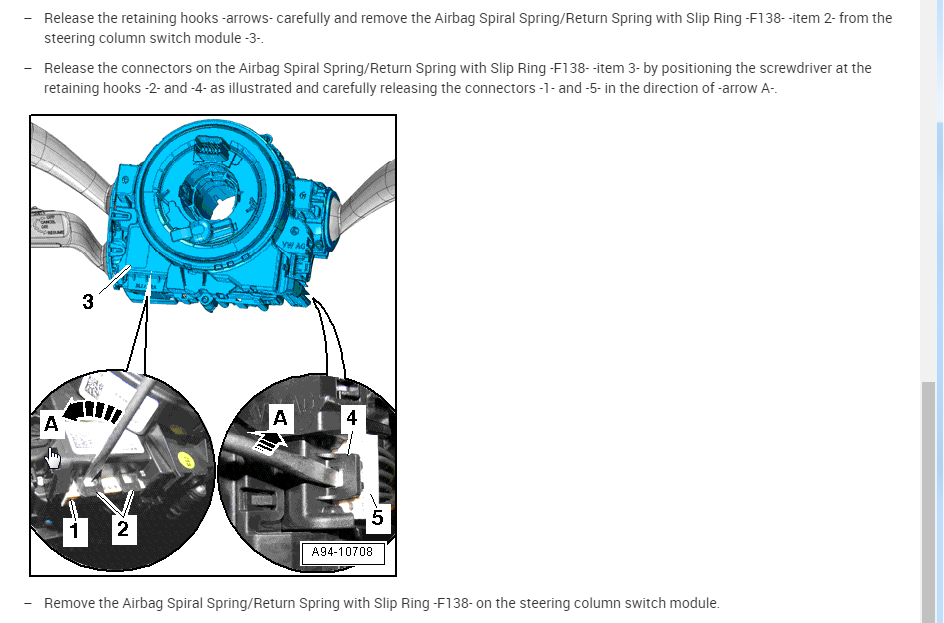

My car makes a clicking noise when I turn the wheel.

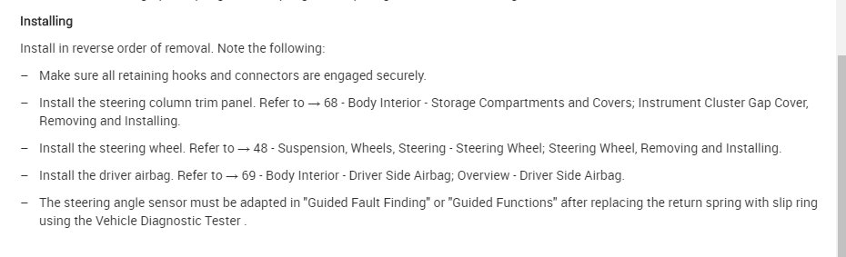

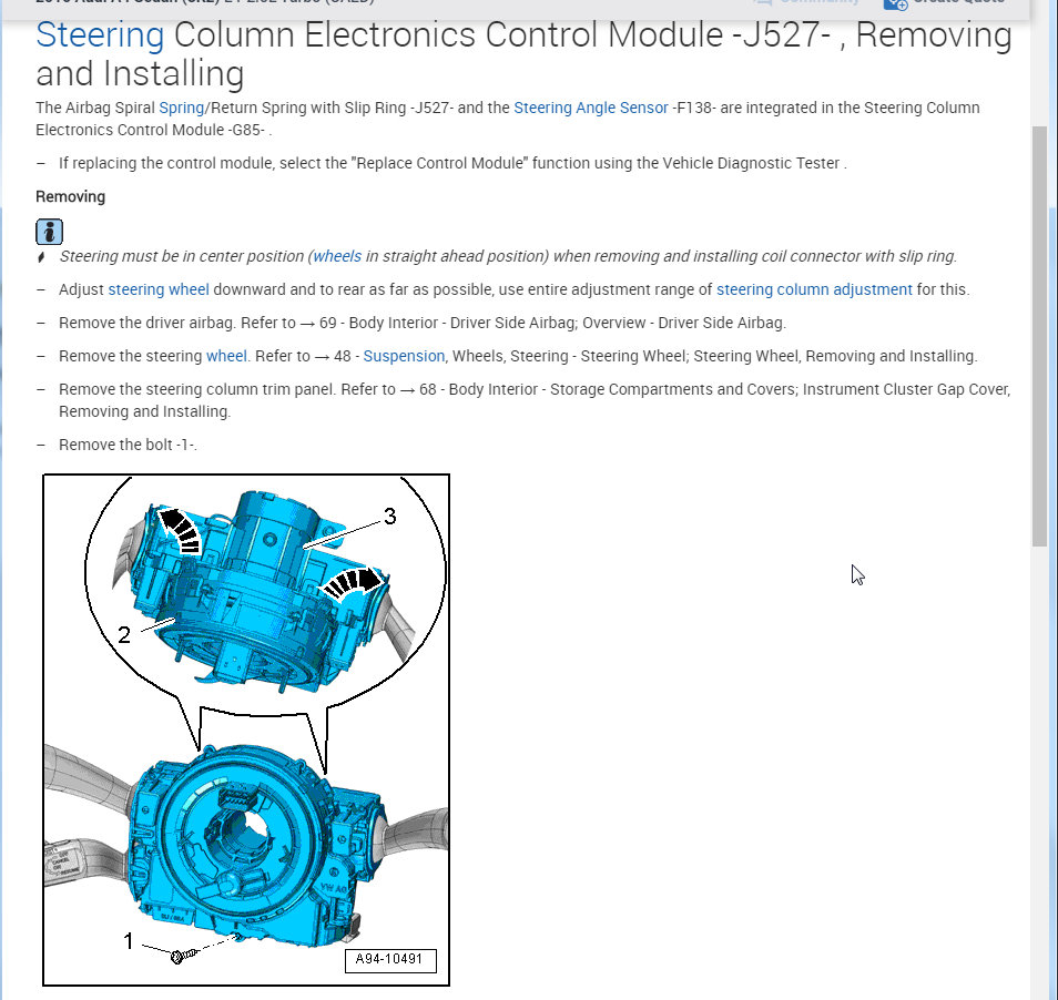

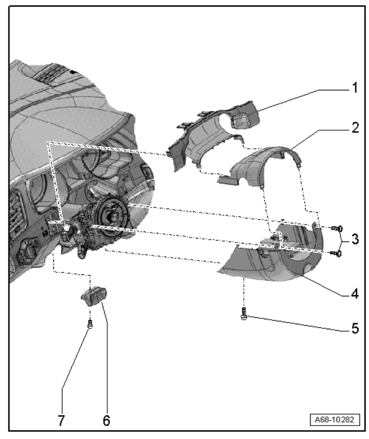

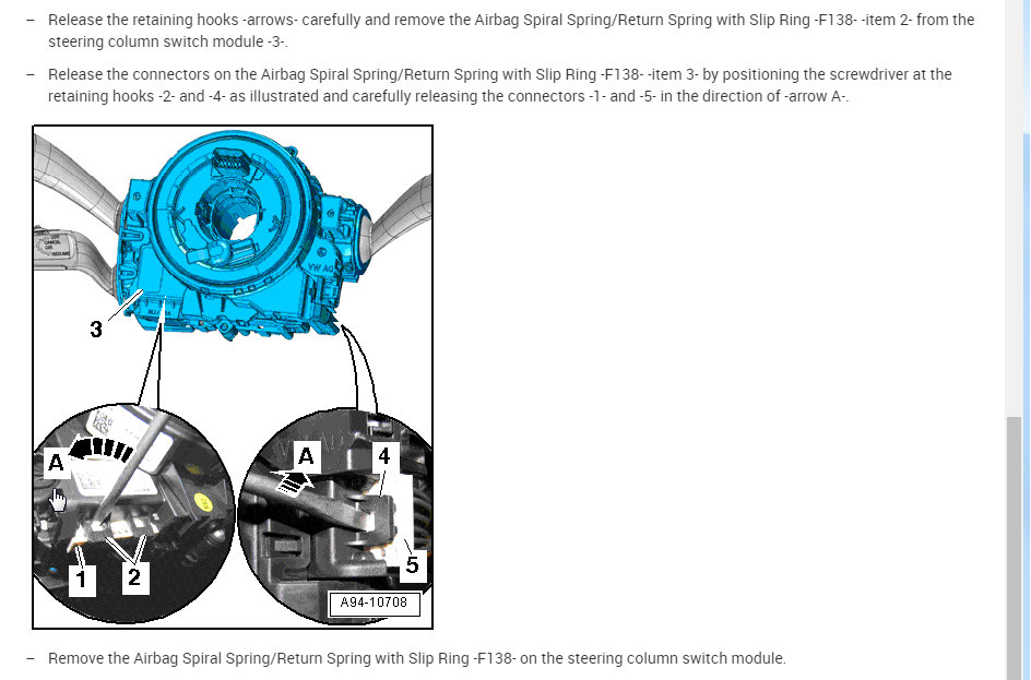

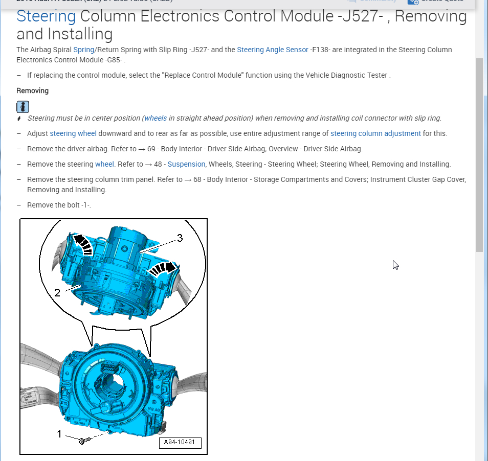

This is called the airbag spiral spring or clockspring. I attached a bit of info on this but if you are going to do this yourself, make sure you disconnect the battery because you will be removing an airbag.
