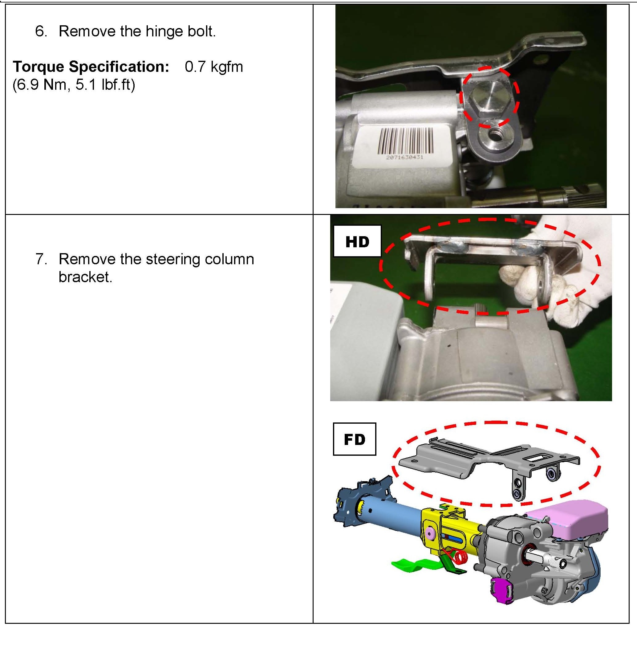

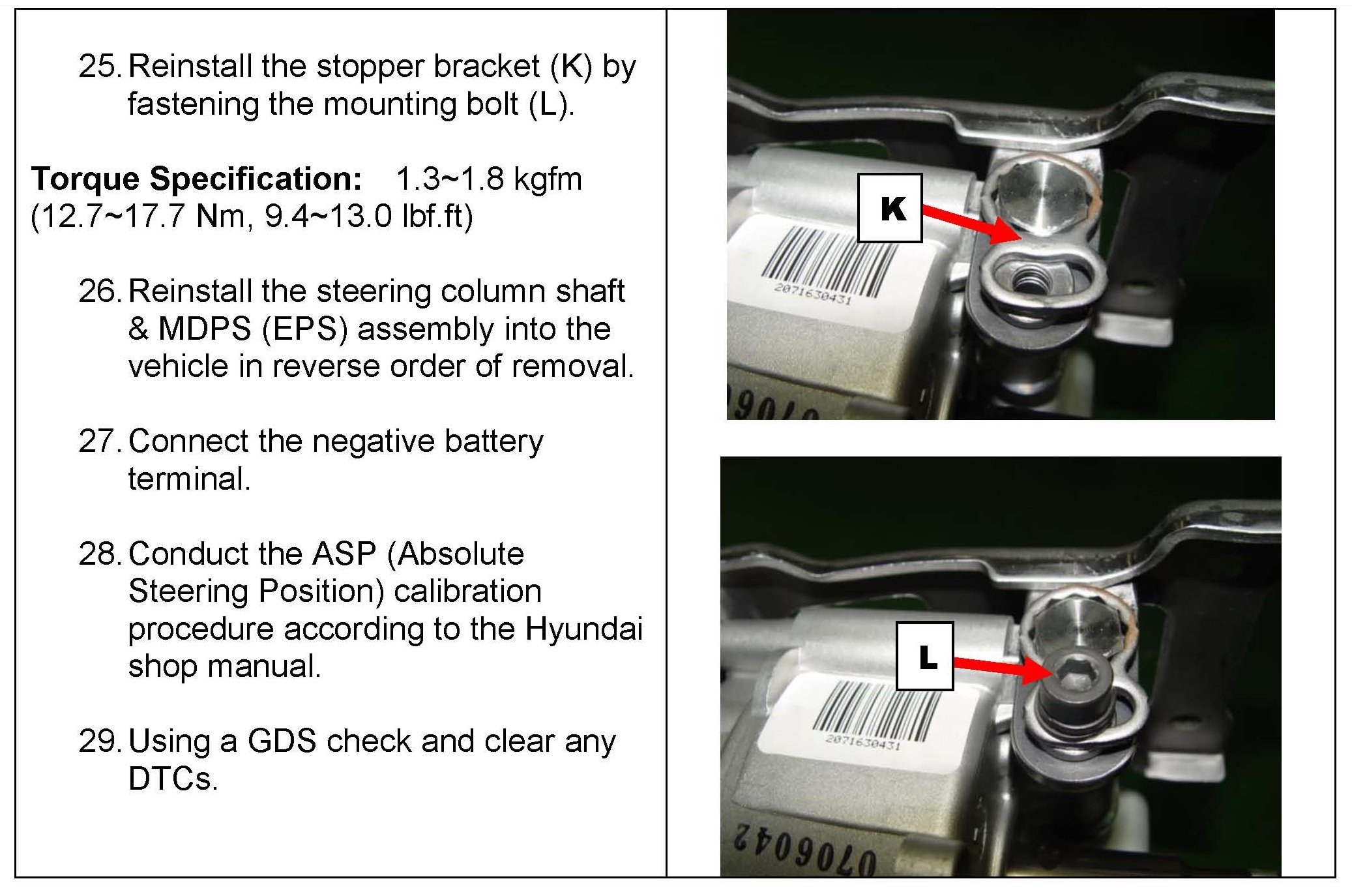

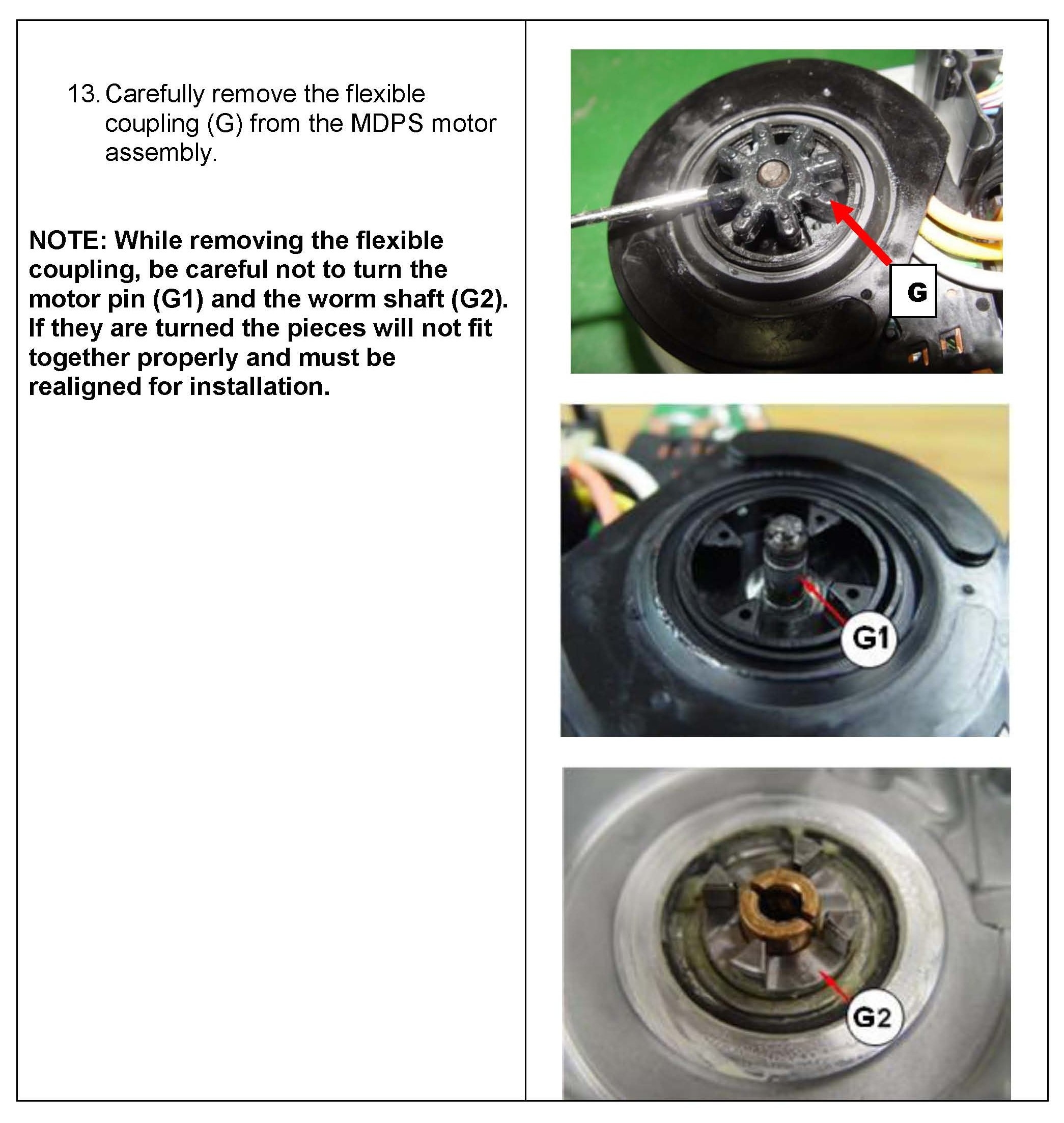

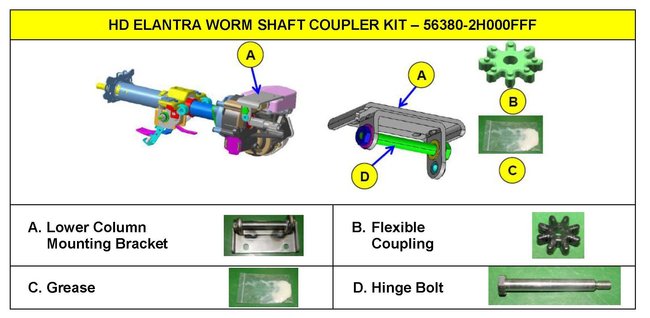

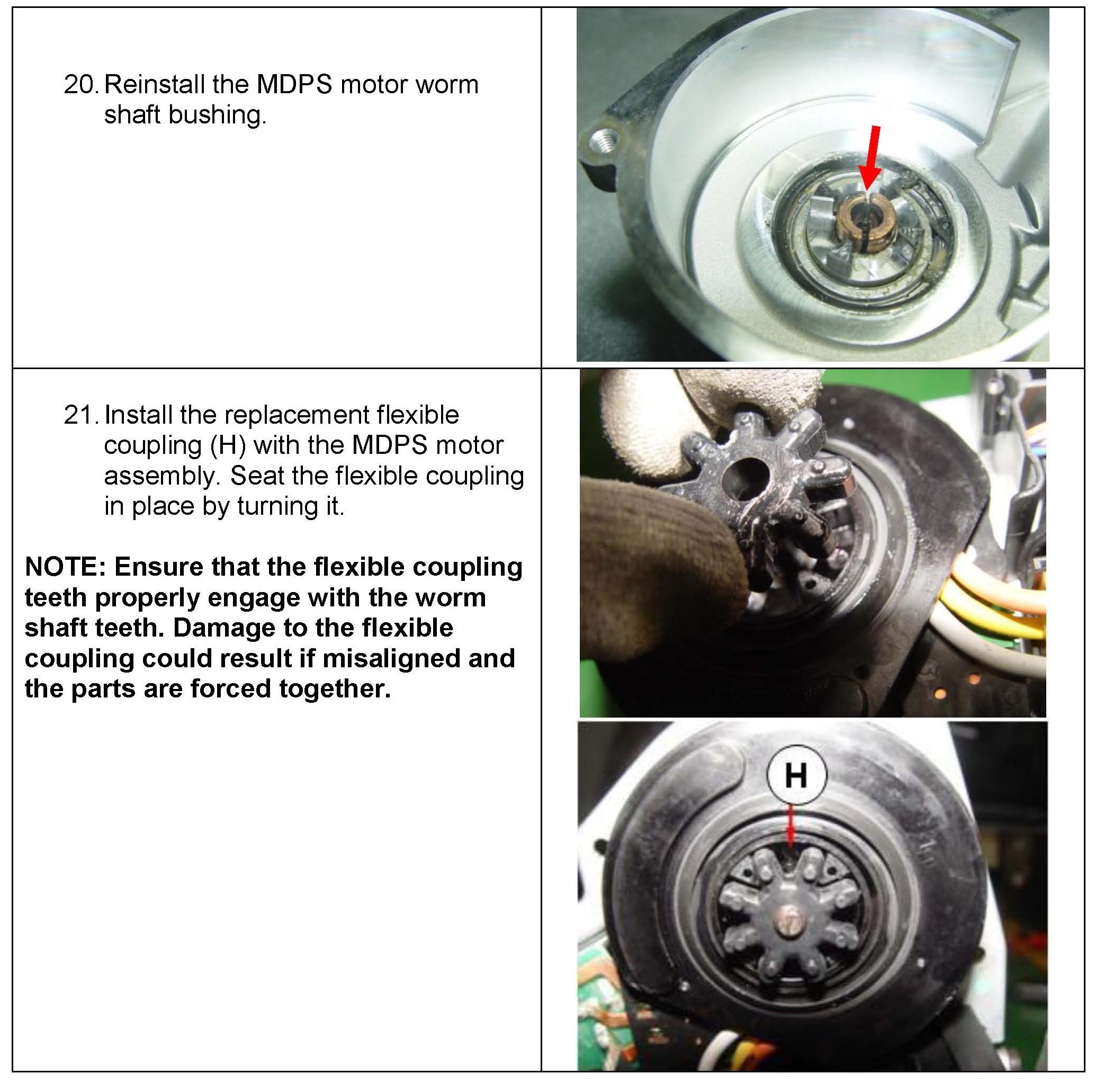

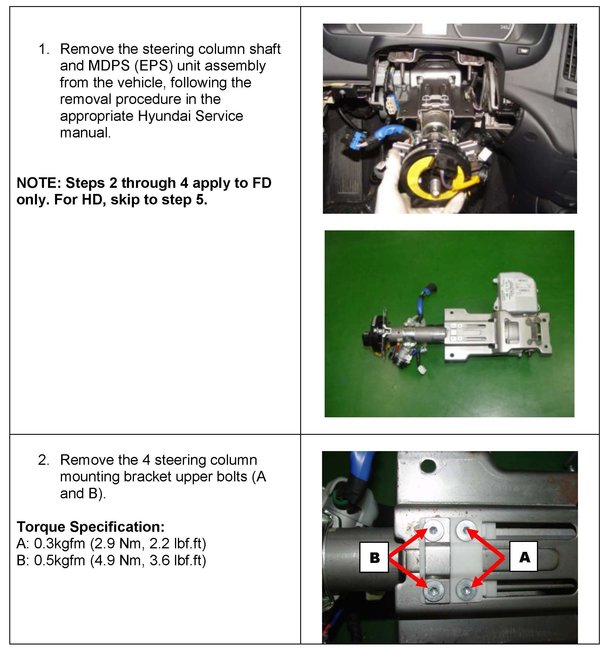

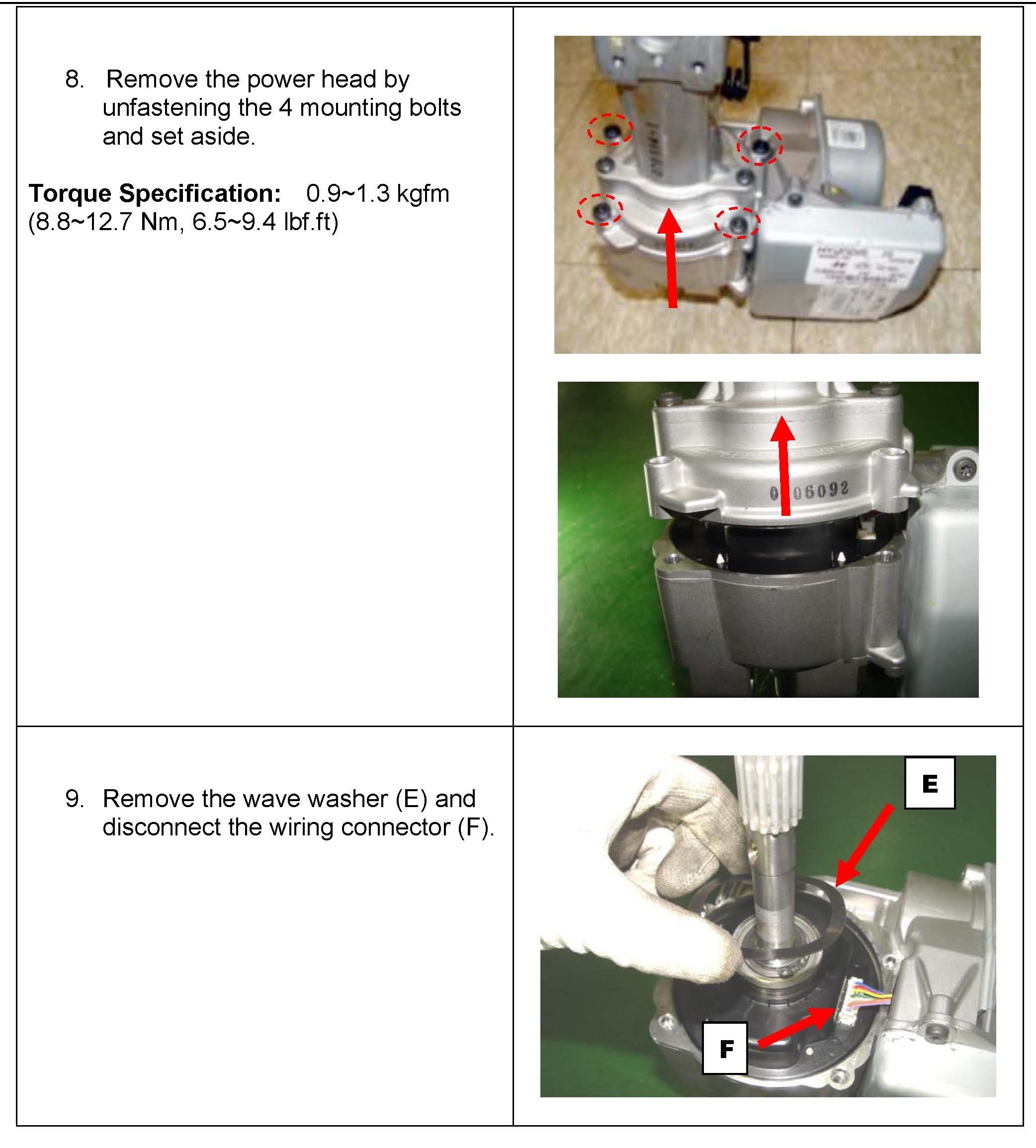

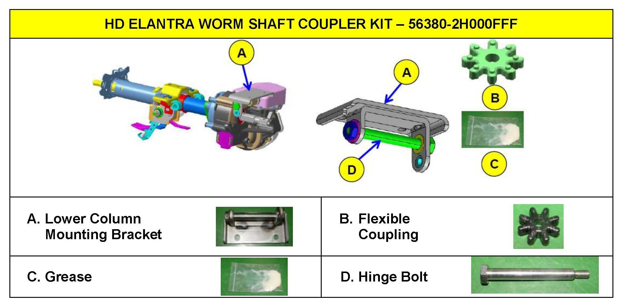

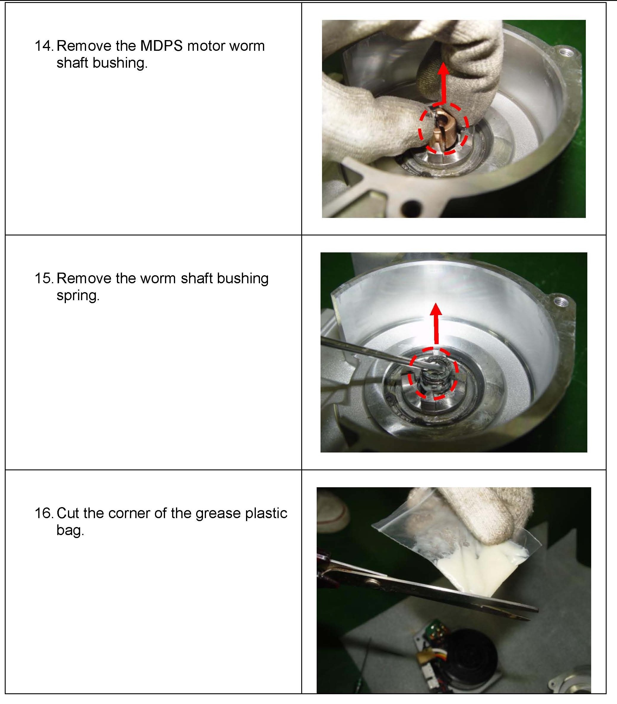

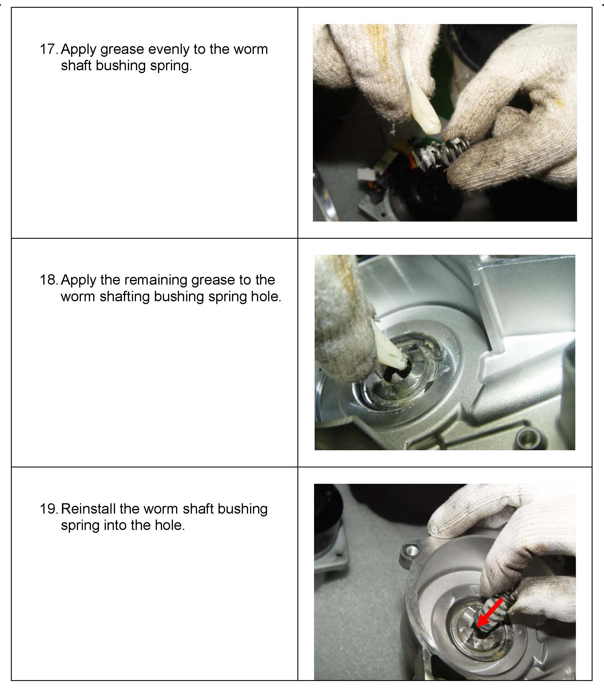

When this happens, does it make any noise? I came across a technical service bulletin (TSB) related to a rattle when hitting bumps or turning the wheel.
Take a look through this. This describes the issue and how it's repaired. The attached pics correlate with the TSB.

Some 2007-2010MY Elantra and 2009-2010MY Elantra Touring vehicles may exhibit a slight rattle noise from the steering column while driving on rough roads at low speeds or while turning the steering wheel.This condition is cause by the worm shaft flexible coupling in the motor driven power steering (MDPS) column. This bulletin provides the procedure to repair this condition.

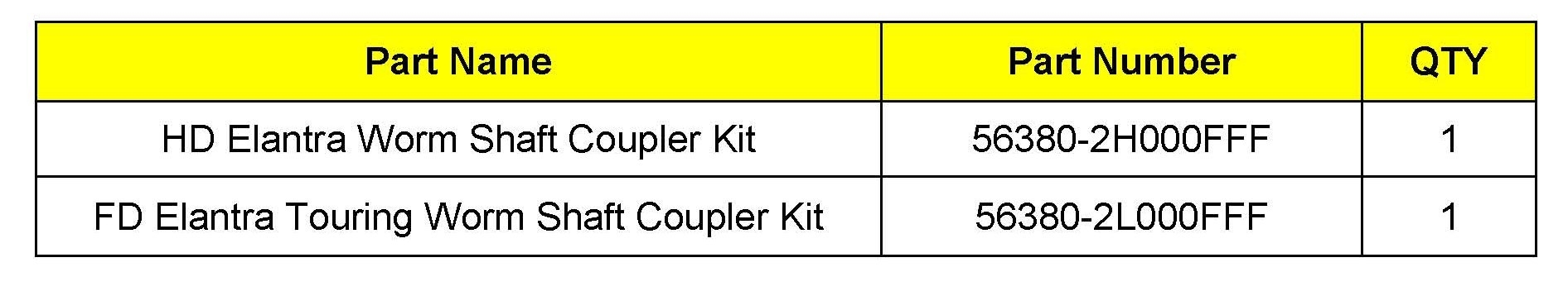

pic 1
PARTS INFORMATION

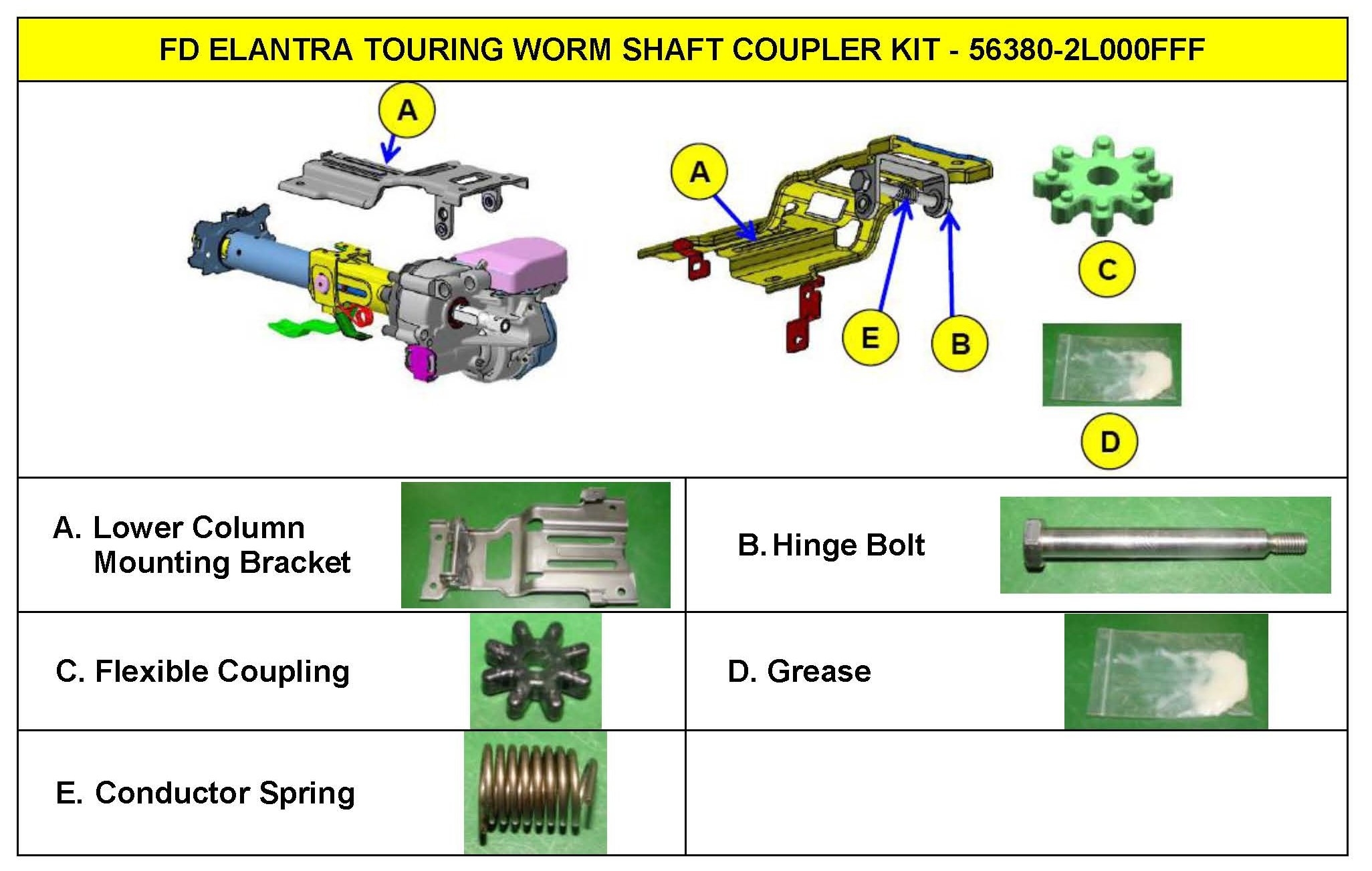

pic 2

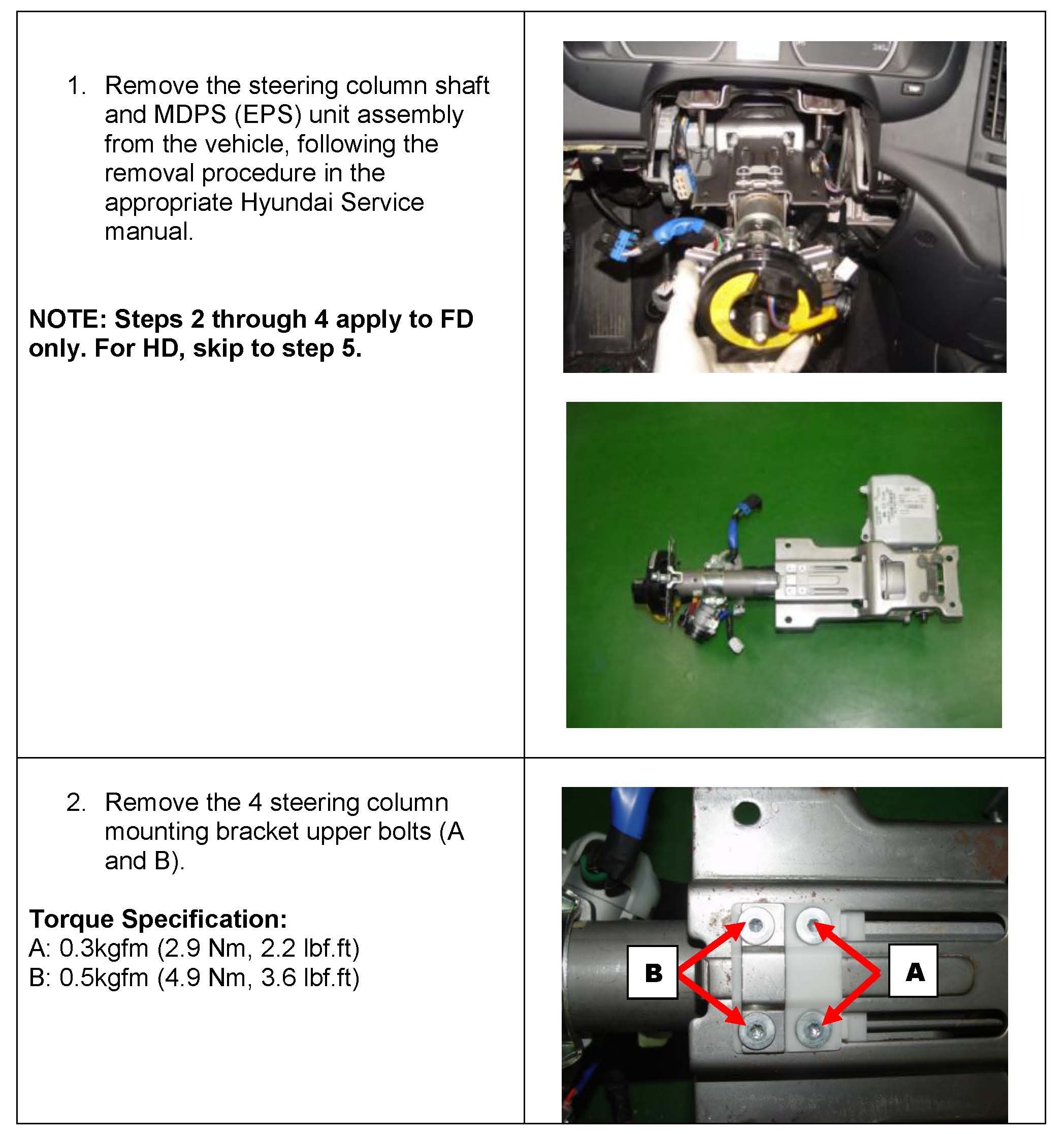

pic 3
KIT COMPONENTS

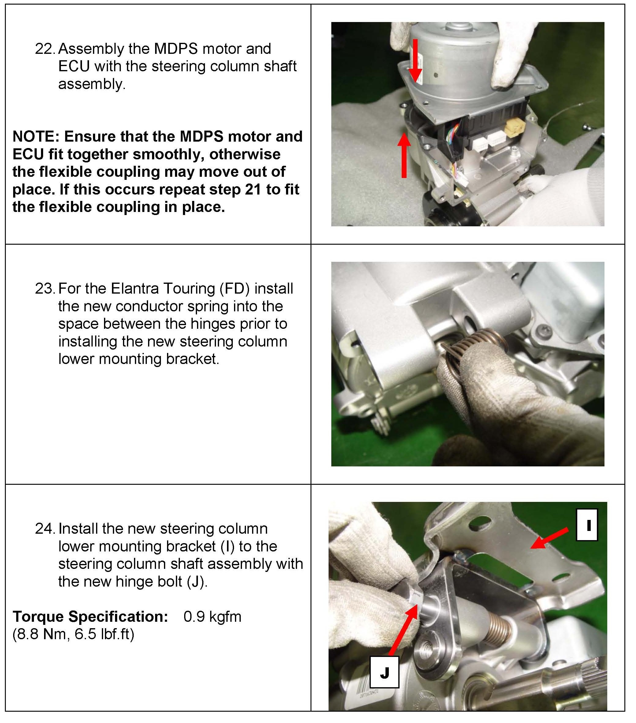

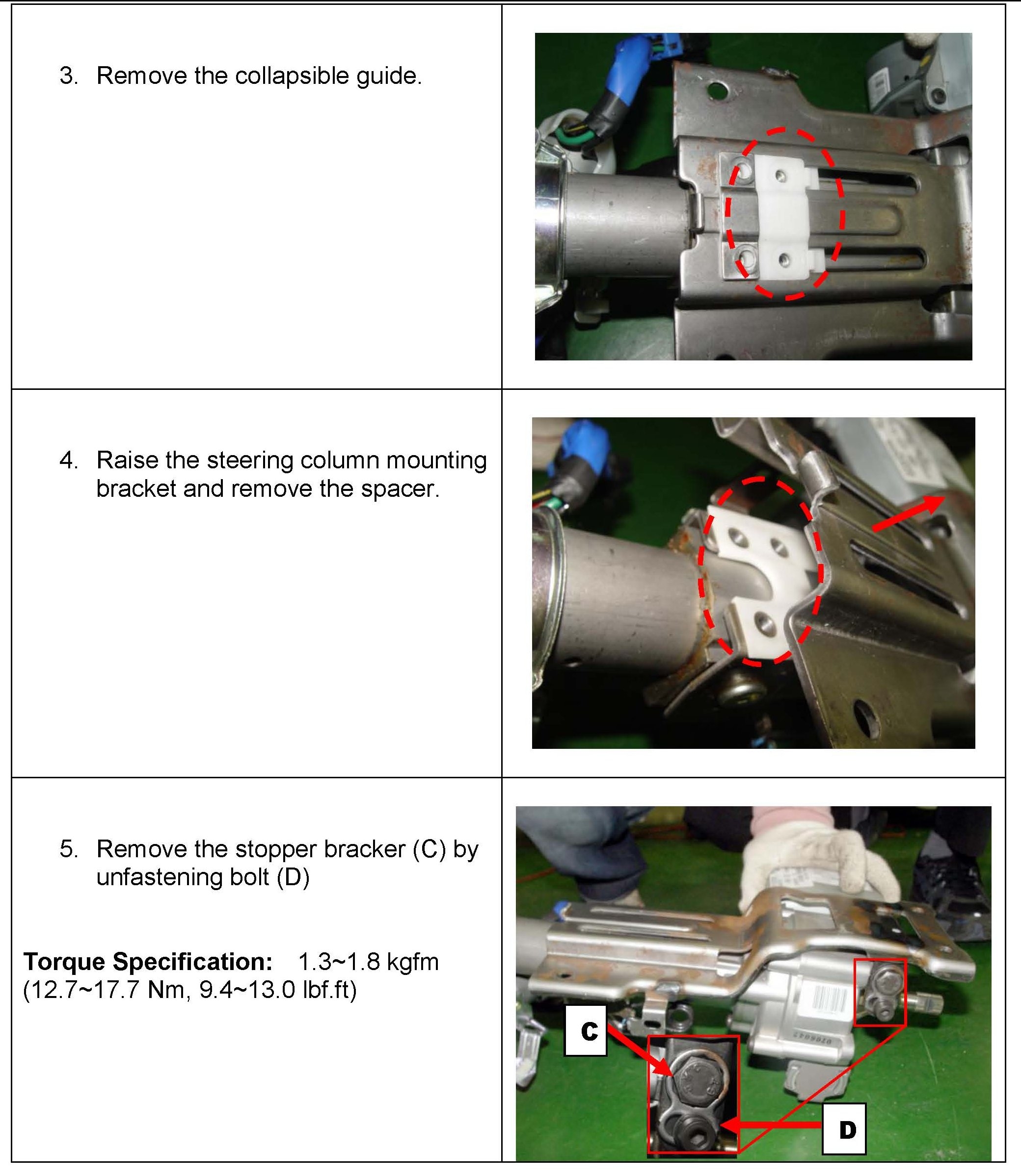

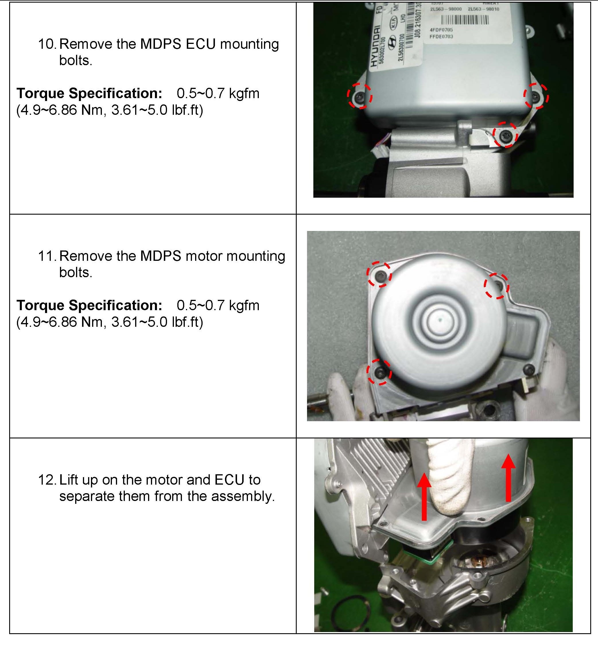

Pics 4 to 11
SERVICE PROCEDURE:
