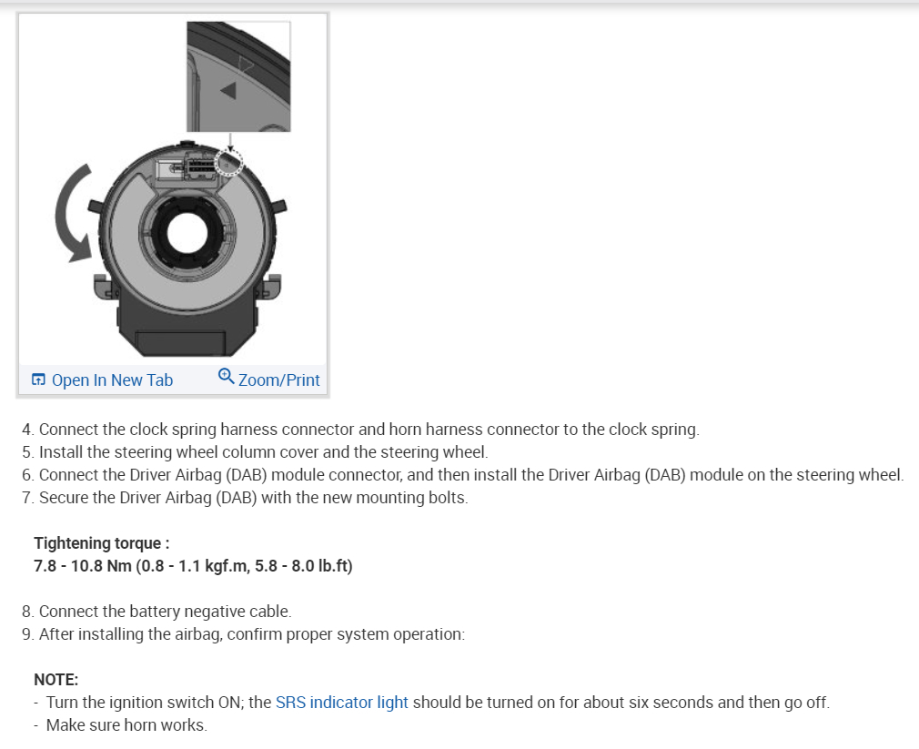

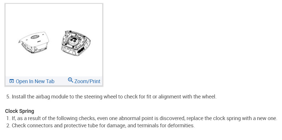

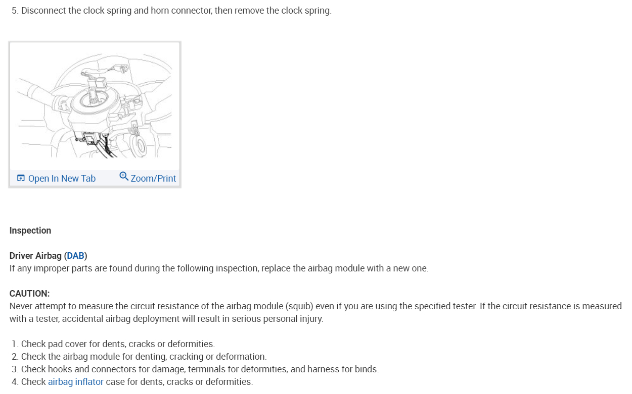

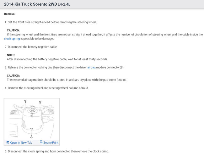

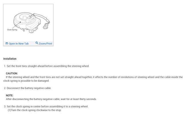

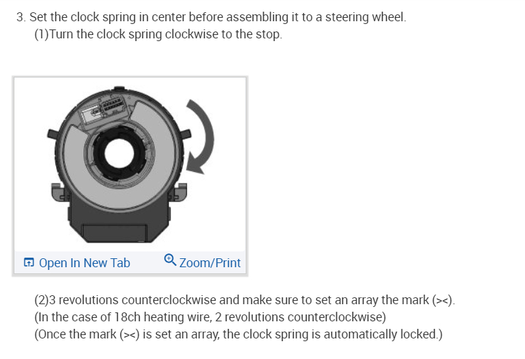

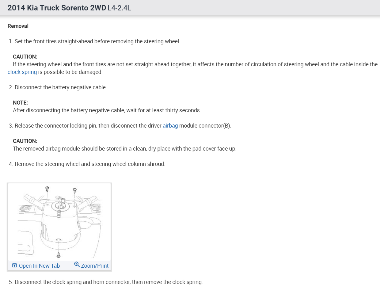

This is common when the clock spring behind the steering wheel goes out. here are the instructions on how to replace it in the diagrams below. Check out the diagrams (below). Please let us know what happens.
