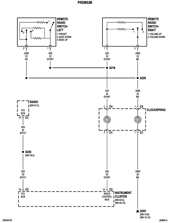

I need to know the steering wheel. Audio control wire colors.
Sep 25, 2025 at 1:53 PM
CARADIODOC
CERTIFIED EXPERT
34,306 POSTS
Black is ground. Gray / white is the multiplexed signal wire.
Image (Click to enlarge)
