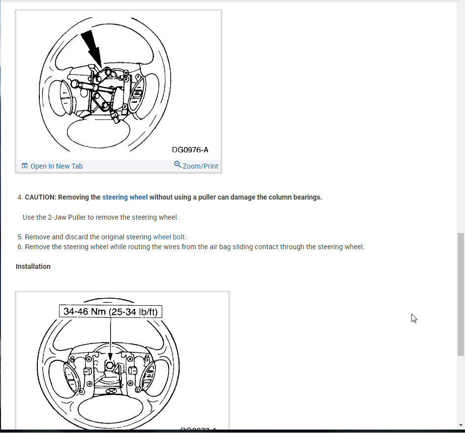

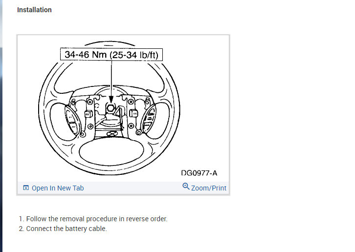

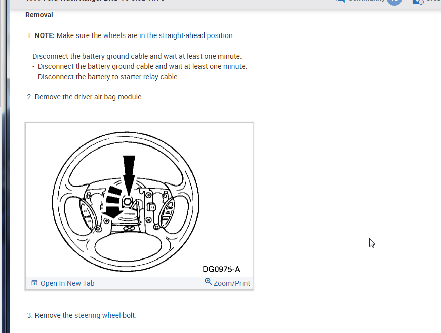

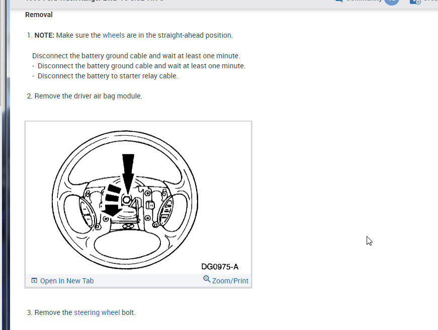

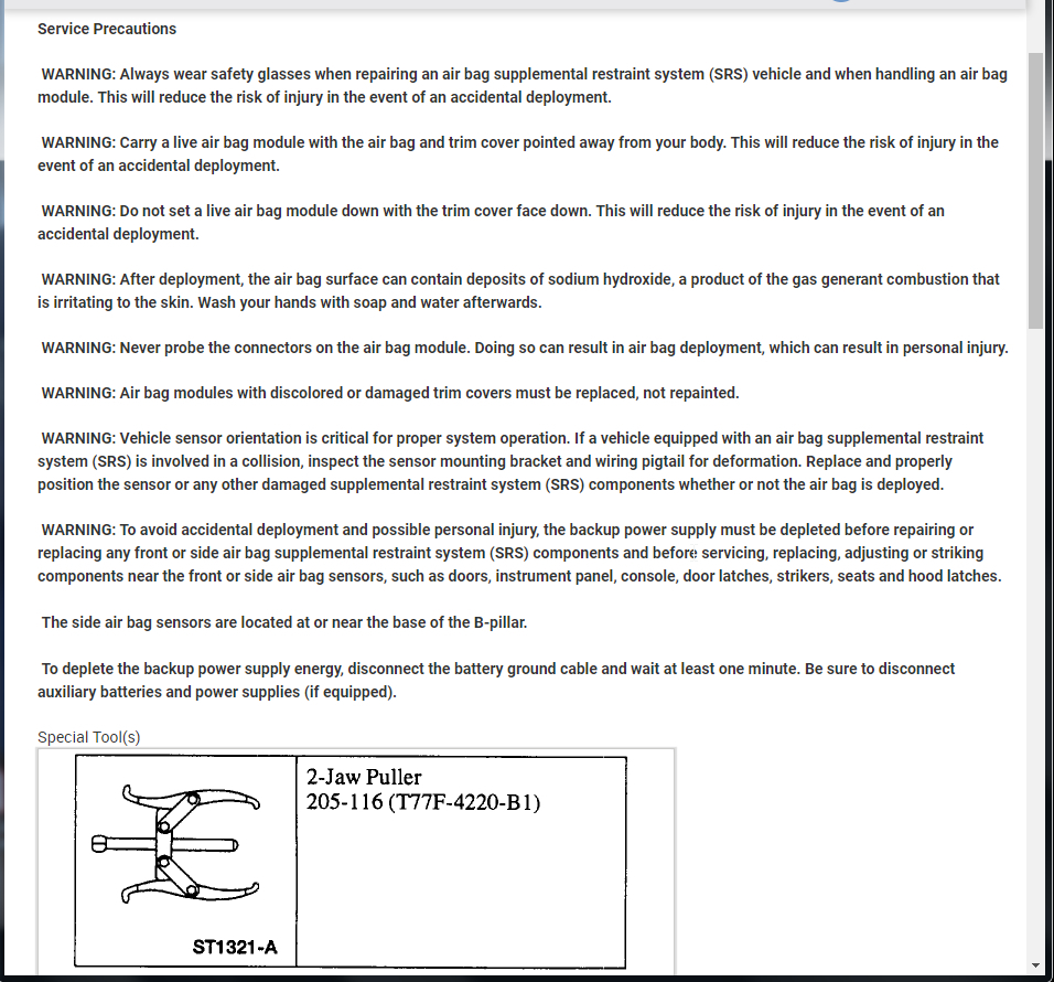

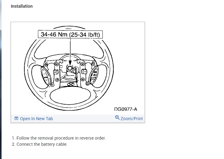

I am attaching the process from the manual. Let us know if you need more information.
