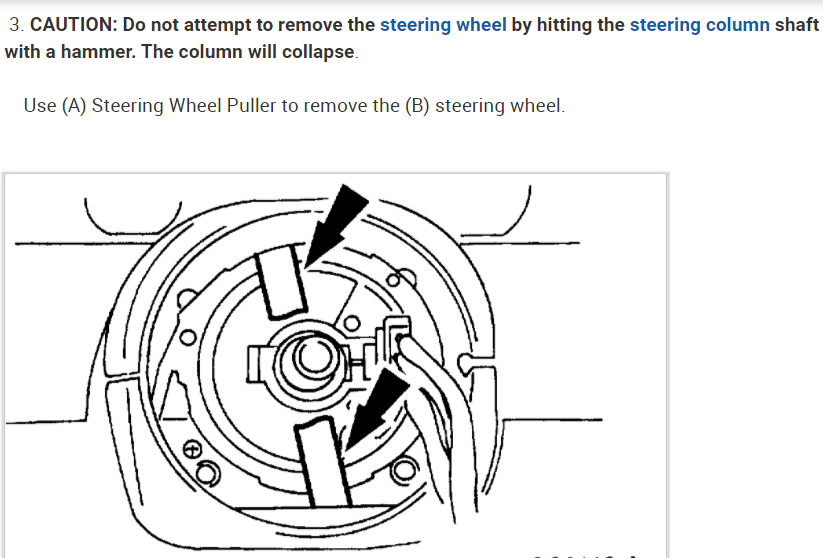

I need to remove steering wheel.
Aug 7, 2018 at 6:00 PM
DANNY L
CERTIFIED EXPERT
5,648 POSTS
Hello, I'm Danny.

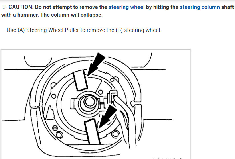

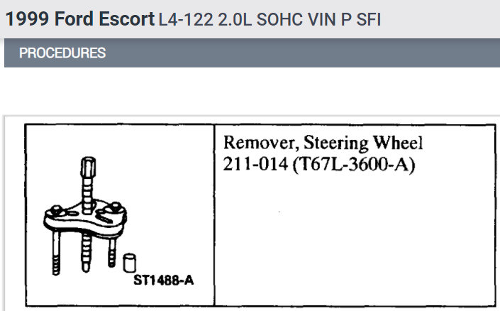

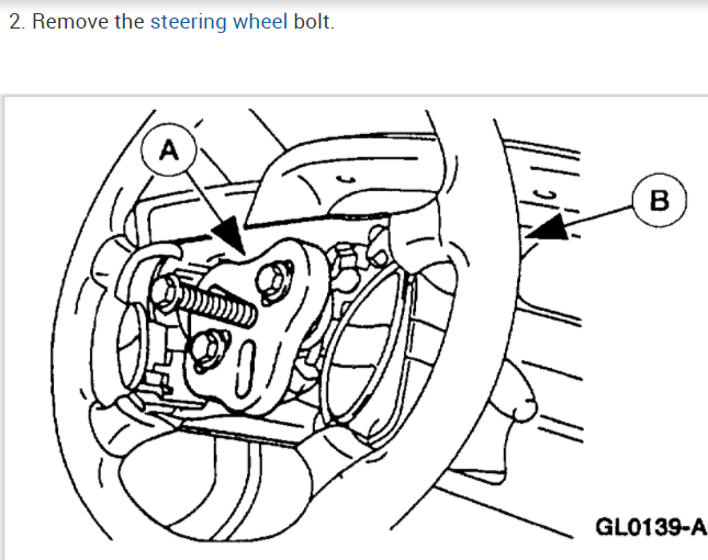

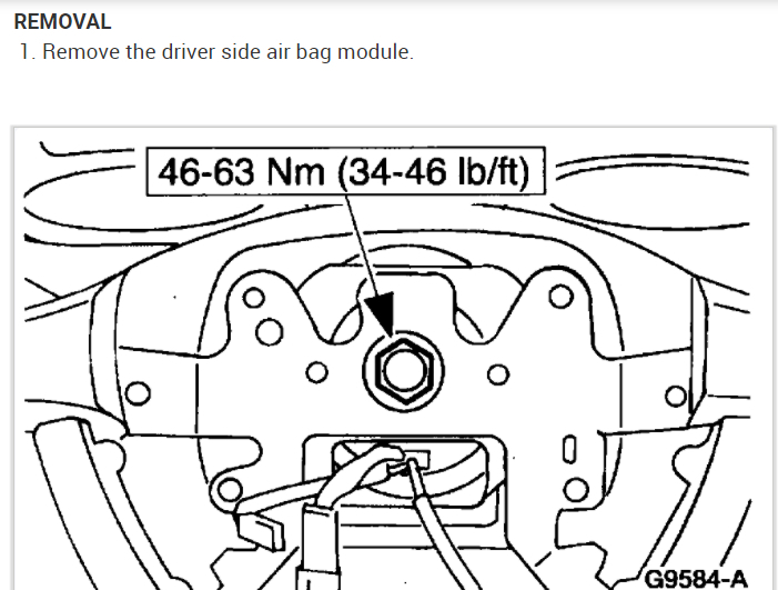

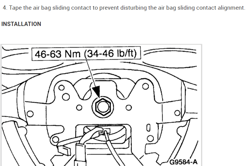

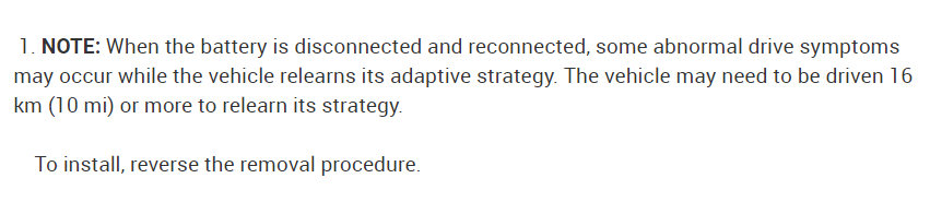

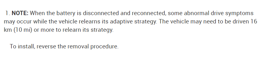

Here is the information you requested. Here is a tutorial for you to view first on how to remove a steering wheel:
https://www.2carpros.com/articles/steering-wheel-removal
I've attached picture steps below on how to remove the steering wheel on your car. Hope this helps and thanks for using 2CarPros.
