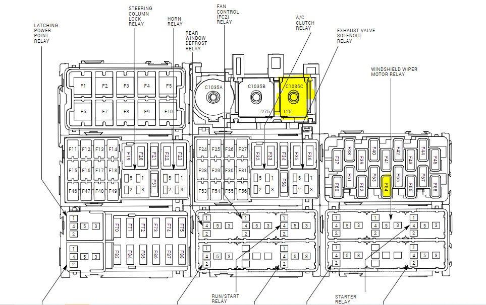

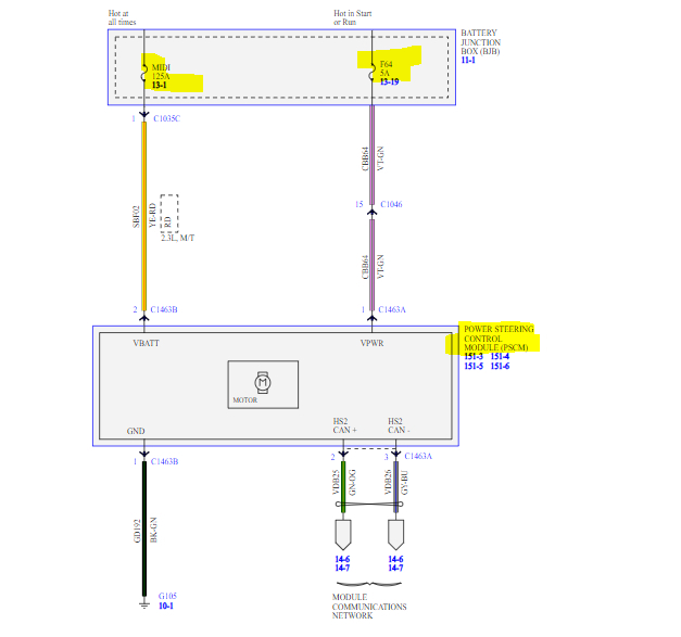

His vehicle has an electric power assist steering (EPAS). The EPAS system provides steering assist by replacing the conventional hydraulic valve system with a steering gear equipped with an integrated electrical motor and PSCM.
If this happened all at once, the first things I would check would be the fuses. There are two in the battery junction box that power the unit. See pics below.
Note: One fuse (fuse 64) is a traditional 5-amp fuse. The midi fuse is 125 amp and should be bolted in place. You may want to disconnect the battery before working with the midi fuse.
See pics below.

When you say nothing worked, did the fuses have power to and from them? Also, I don't know if you have one or have access to a scan tool that can scan the can-bus. That is what should be done at this point to see if there is a code that is stored in the module. If there is, that should point us in the right direction. Otherwise, it will become a guessing game.
Here is a link explaining how that is done:
https://www.2carpros.com/articles/can-scan-controller-area-network-easy
Let me know if that is something you can do or have done.
