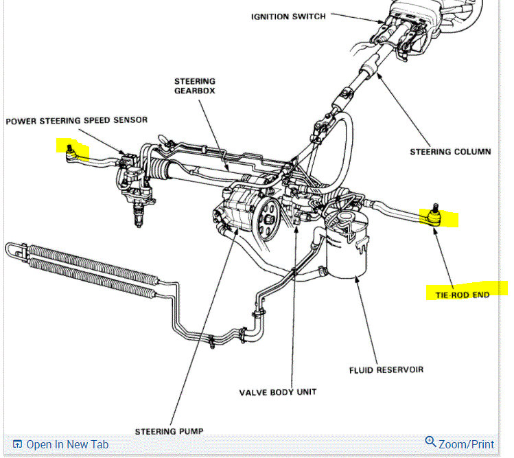

The first thing I recommend is to check both the tie rods and the ball joints. Either could be causing this issue.
Here is what to do. Safely lift one front wheel from the ground. Place your hands at 3 and 9 o'clock and wiggle the wheel back and forth. Check for play in the tie rods shown in pic 1. Note, I highlighted the outer tie rod. There is an inner one as well that attaches to the rack and pinion under the rubber boot. See if the play is coming from there as well.

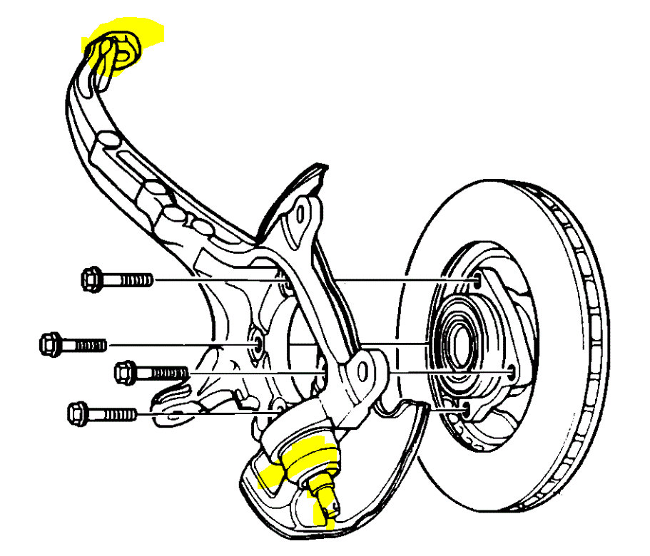

Next, place your hands at 6 and 12 o'clock. See if there is play in the ball joints. There is both an upper and lower ball joint. In pic 2, I highlighted their locations.

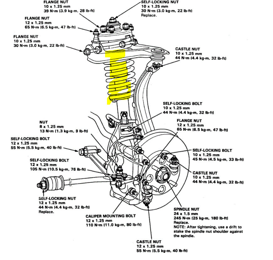

Next, inspect the coil spring which is part of the strut assembly. Make sure it isn't cracked. See pic 3.
