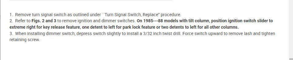

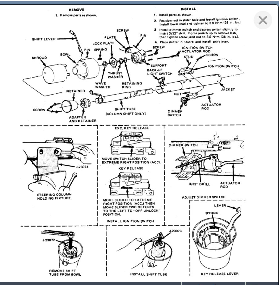

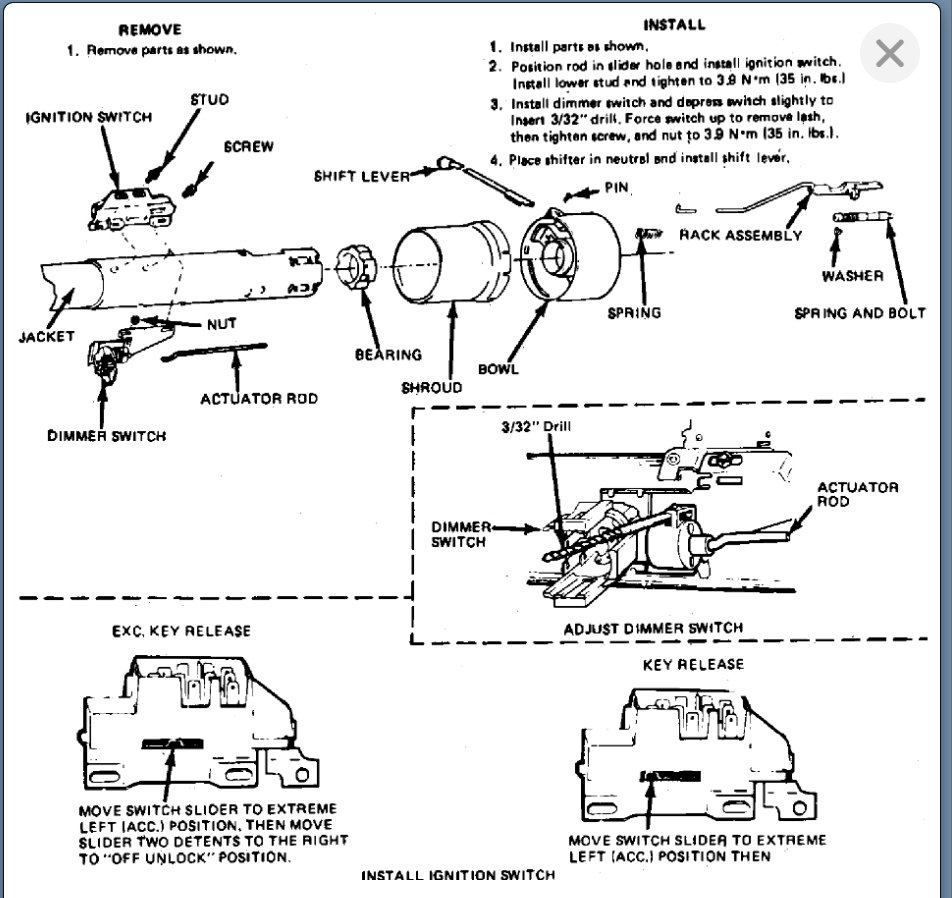

i changed the ignition switch actuator on the car and now the turn signal won't spring back, the windshield washer fluid wont spray, and the horn honks every time i turn, what did i do wrong?
