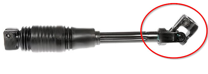

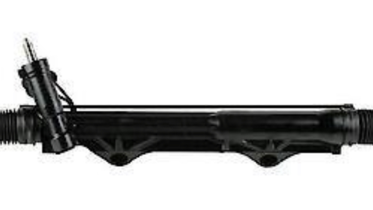

Just to be sure we are on the same page, take a look at the picture below. You are talking about changing this joint?
If that is the case then no, you cannot change just the joint. You need to change the at entire shaft that is shown in the same picture.

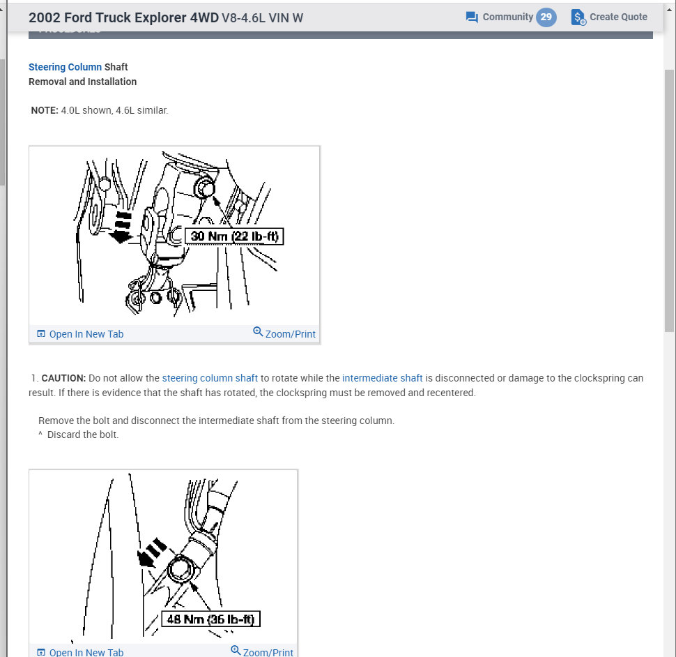

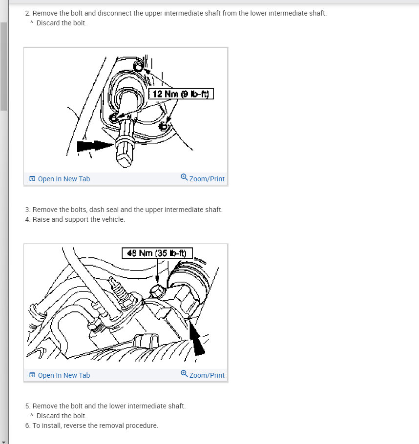

I also attached the instructions on how to change this shaft. Please run through this info and let us know if you have other questions on this.

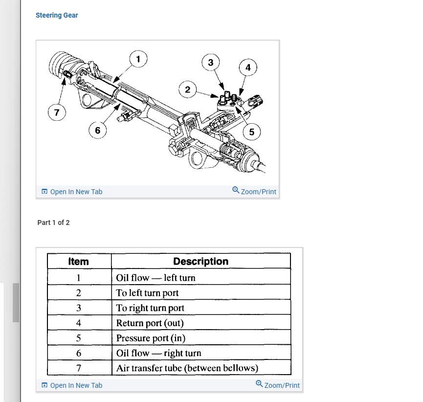

So, all of the suspension parts were worn, and I replaced all of them. I also got an alignment after I replaced all of those parts described in my last message. So, I don’t believe it would be the alignment. I think it must be something with the power steering. The fluid doesn’t appear to be leaking. If it is then it’s minimal because the level remains where it should be in the reservoir. I attached a picture because when my friend was helping me with some of the suspension parts replacements, I remember him saying something fell down to the ground and he didn’t know what it was and thought it was something not important or from an old repair or something. He described something similar to that thin black rod looking piece on the top of the rack and pinion that looks like it connects to the bellows on either side that cover the inner tie rods. What is this piece and if it’s missing could it cause these issues?

Plus, you never answered my question about what that part of the rack and pinion is. I think it’s the hydraulic transfer tubing of the rack and pinion but I’m not 100% sure. What would be the symptoms if this were missing.

As for the tube that connects the bellows, that is an air transfer tube.
You do need to have that installed but that is just to keep dirt and debris out of the bellows.
Basically, as you turn back and forth, there needs to be air movement, so they just move the air back and forth rather than letting it pull in fresh air that contains all the dirt and dust being kicked up from the road.
Once you have dirt in the boots then you will need to replace the rack shortly thereafter.
Take a look at the info below.
