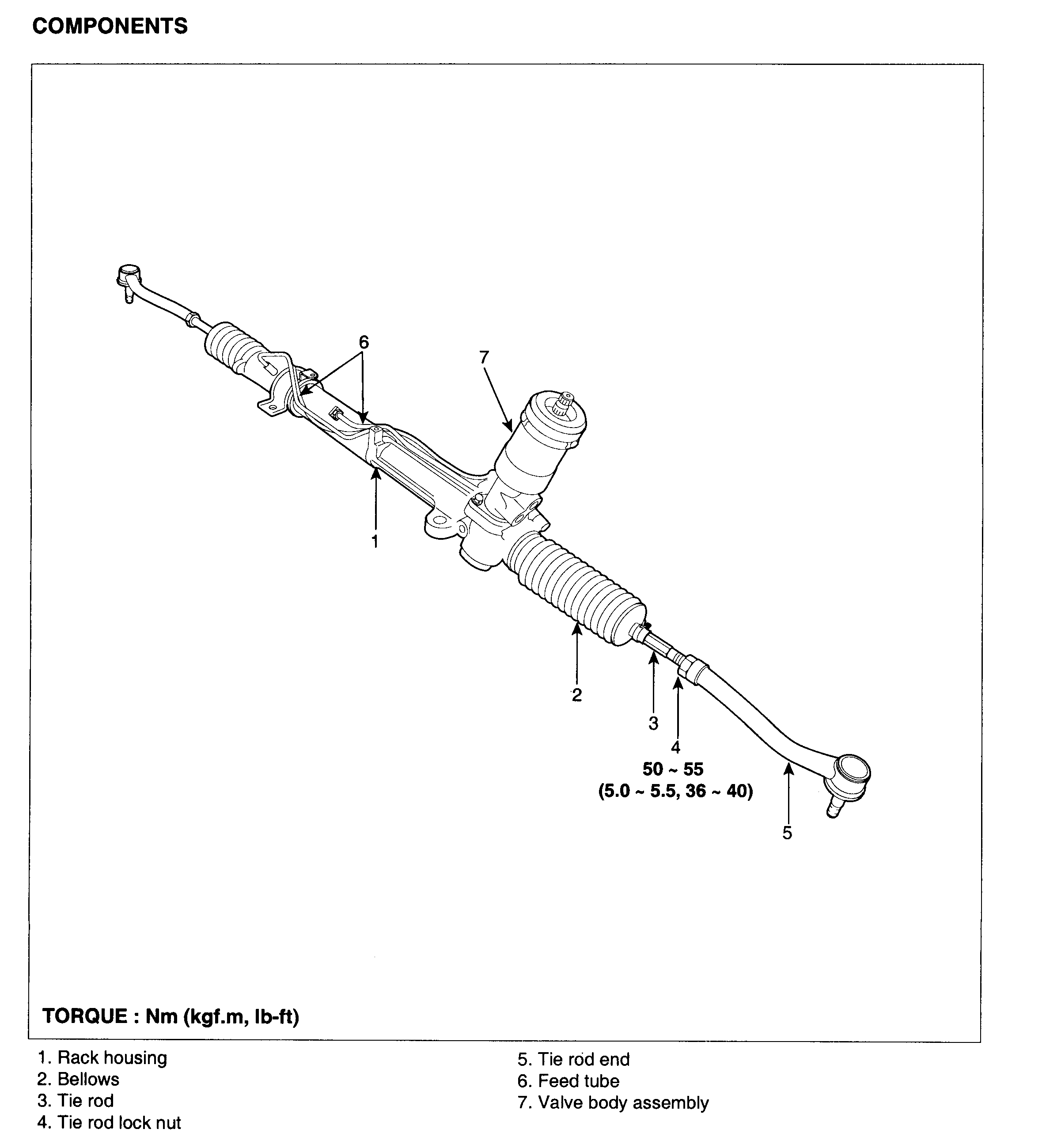

Steering rack and power steering pump are shot. Any tricks to getting these items out? Some say you have to drop the whole suspension. Hoping not. Thankyou
Feb 21, 2021 at 9:39 AM

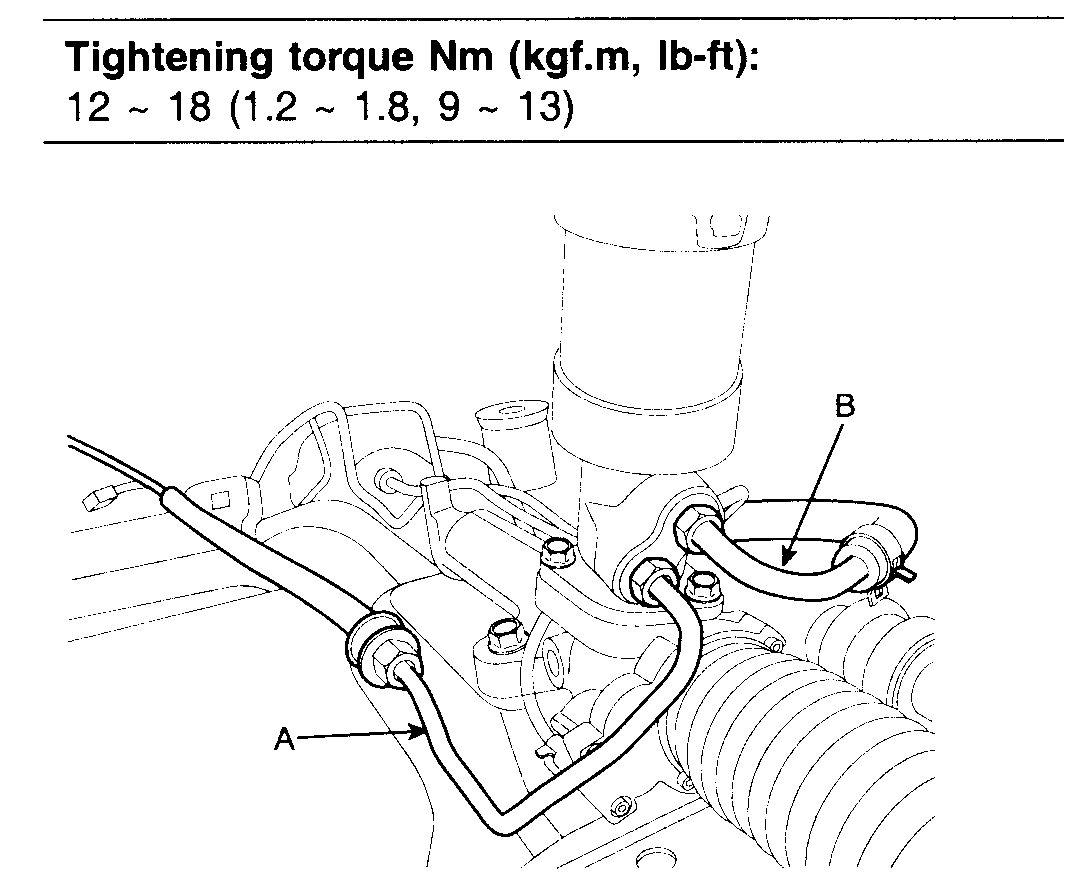

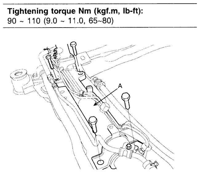

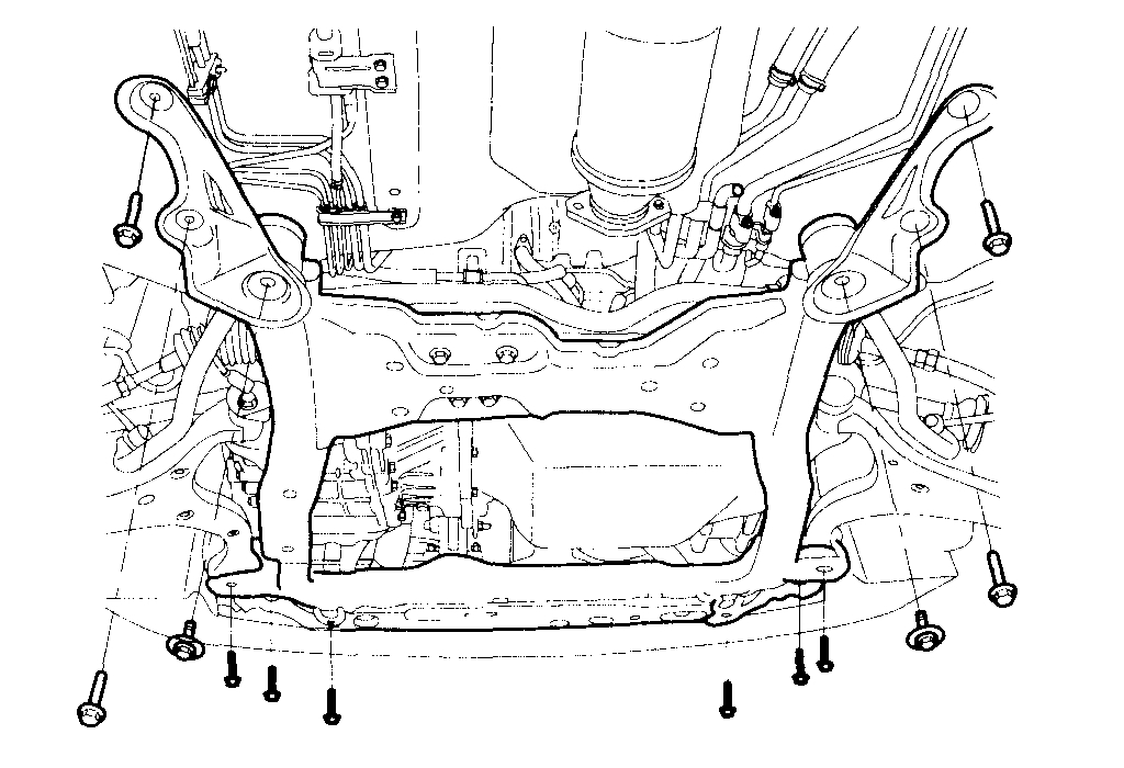

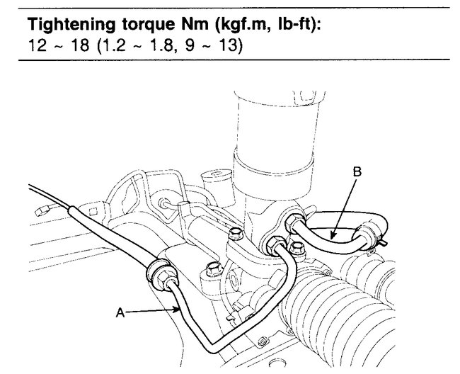

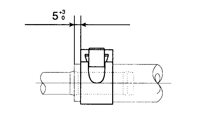

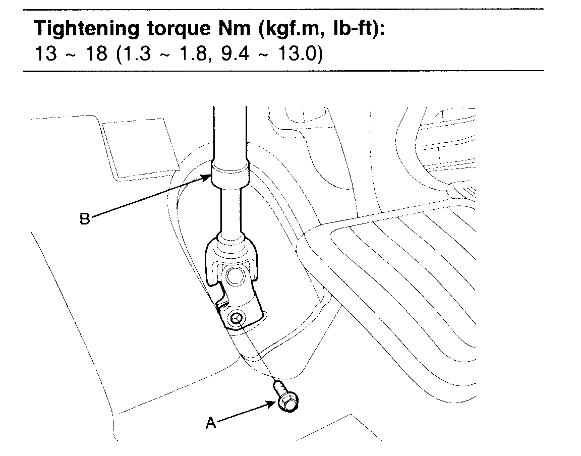

The subframe does need to be removed. It is a rather large job, but if you follow the steps, you should be fine. Here are the directions for removal and replacement. The attached pics correlate with the directions.

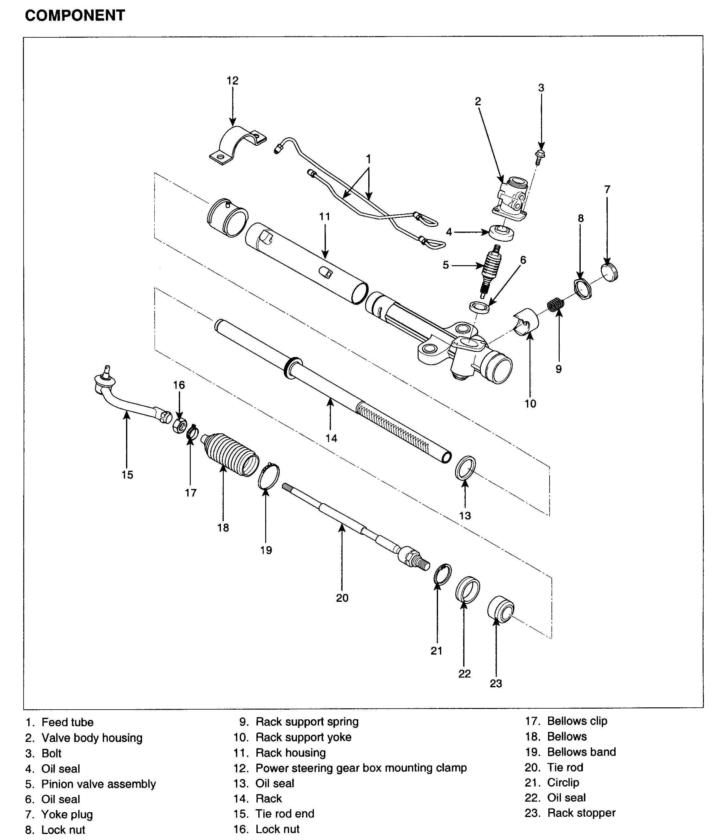

POWER STEERING GEAR BOX

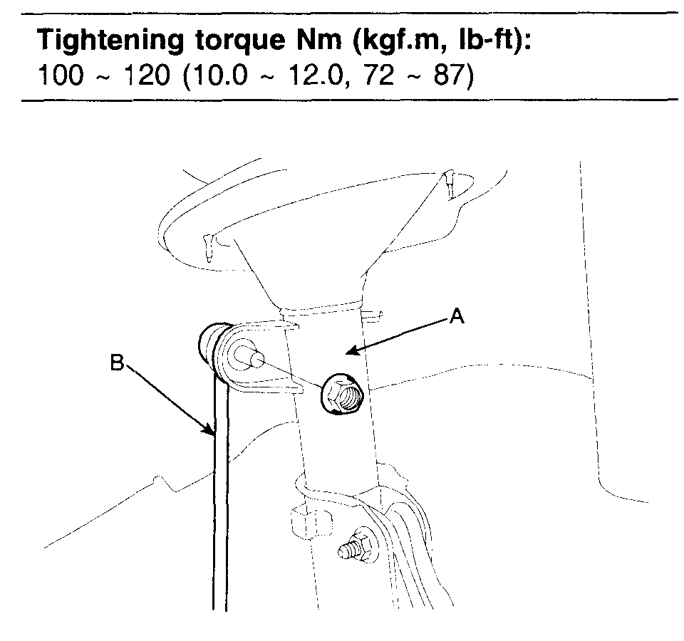

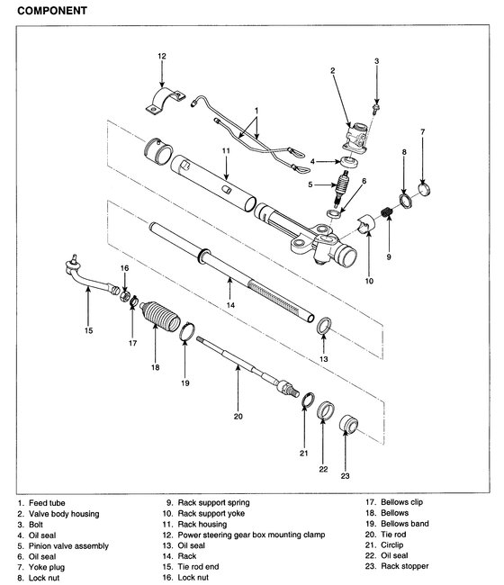

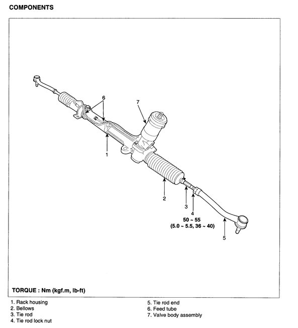

COMPONENTS
pic 1
COMPONENT
pic 2

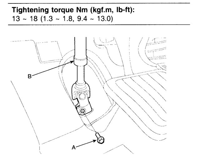

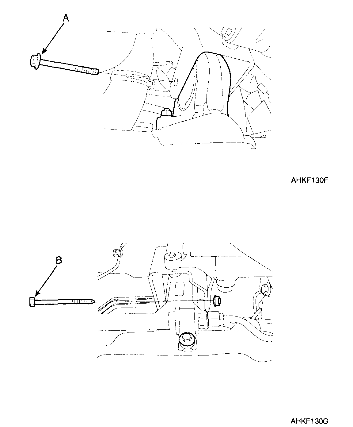

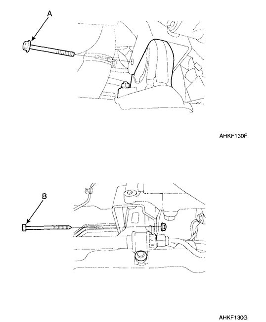

3. Remove the bolt (A) connecting steering column to universal joint.
pic 3

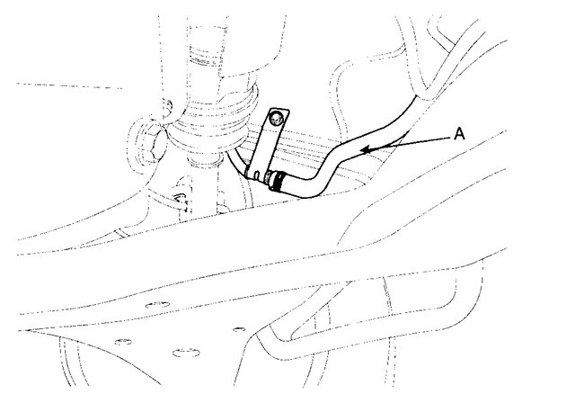

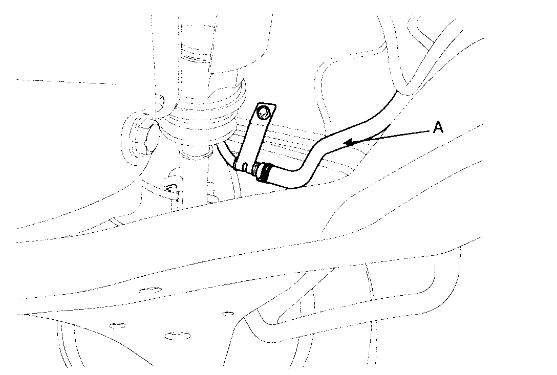

4. Disconnect the pressure tube (A) from the power steering oil pump by loosening eye bolt.
pic 4

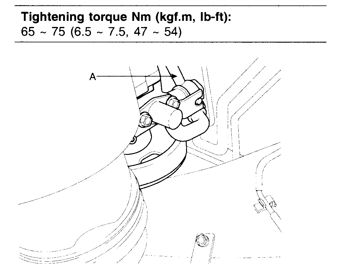

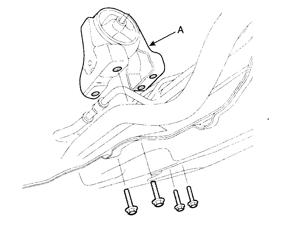

5. Disconnect the return hose (A)
pic 5

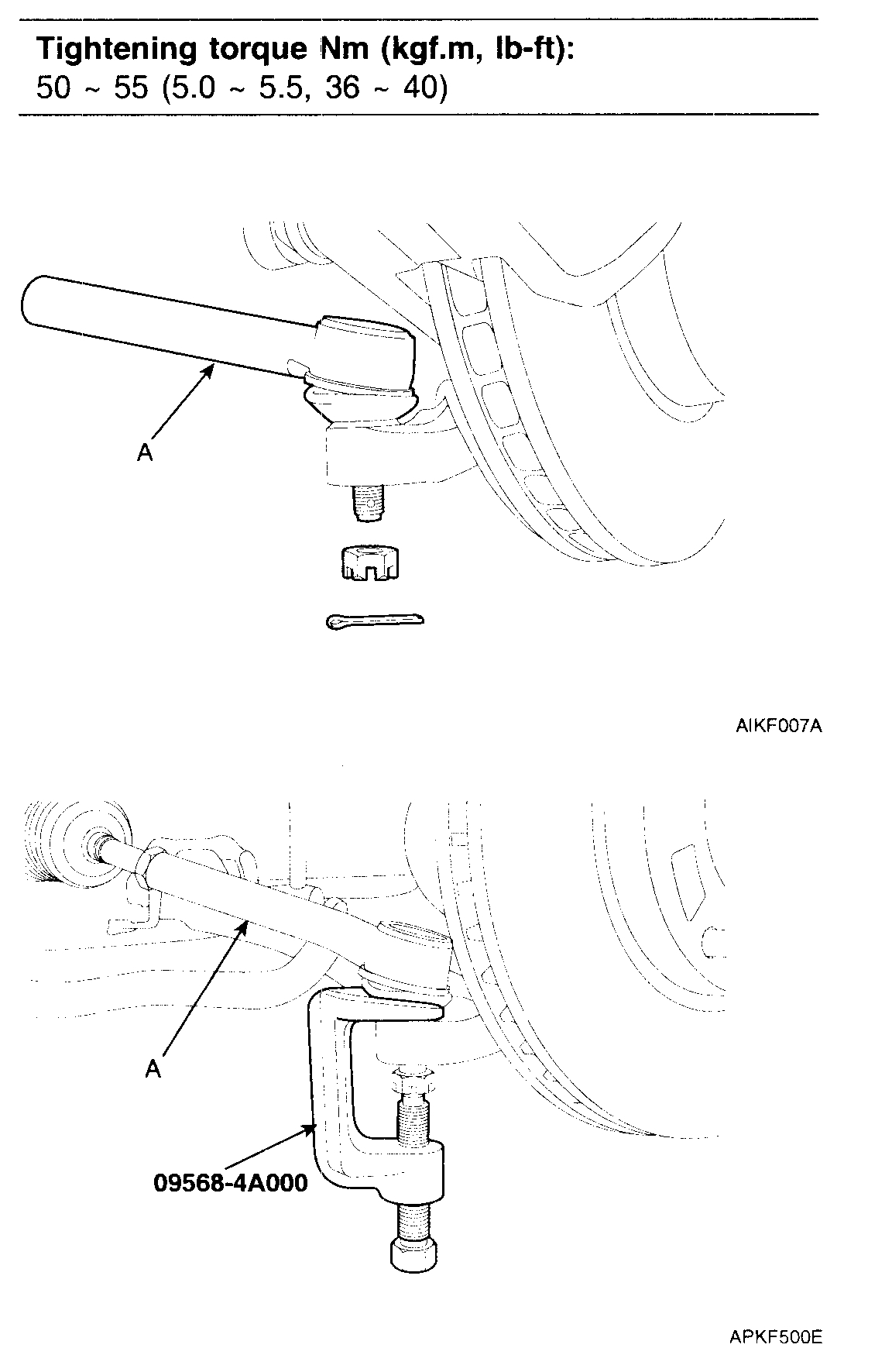

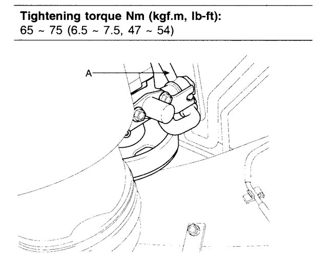

6. Loosen the split pin and castle nut, and then remove the tie rod end (A) from the knuckle by using a SST (09568-4A000).
pic 6

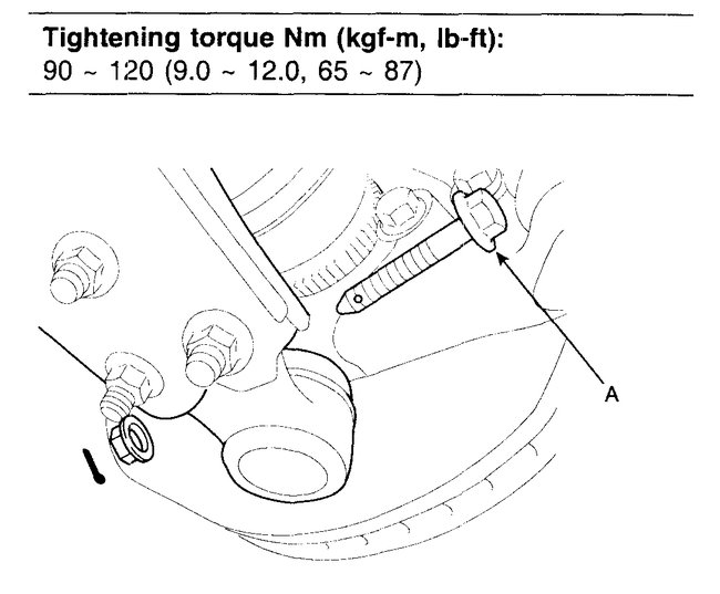

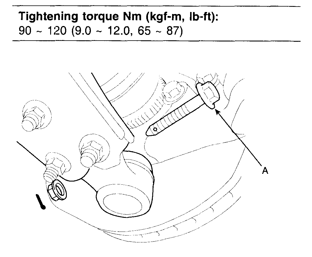

7. Remove the split pin and lower arm bolts and nut (A).
pic 7

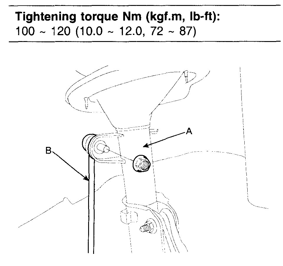

8. Disconnect the stabilizer link (B) from the strut assembly (A) by loosening nut.
pic 8

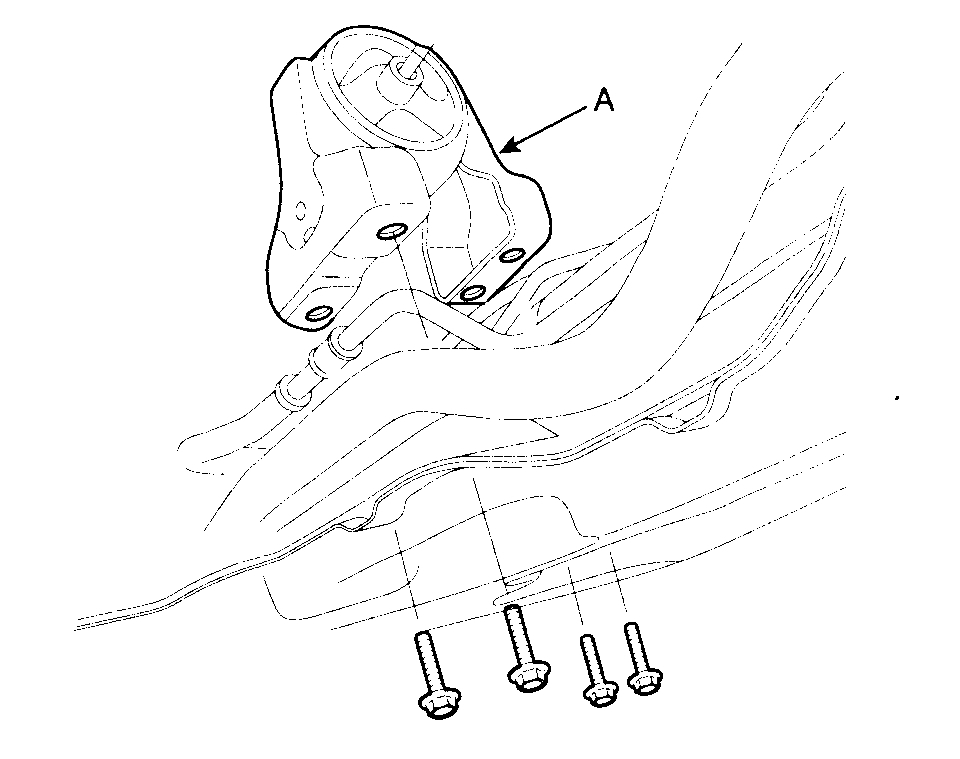

10. Remove the front and rear roll stopper bolts and nuts (A, B).
pic 9

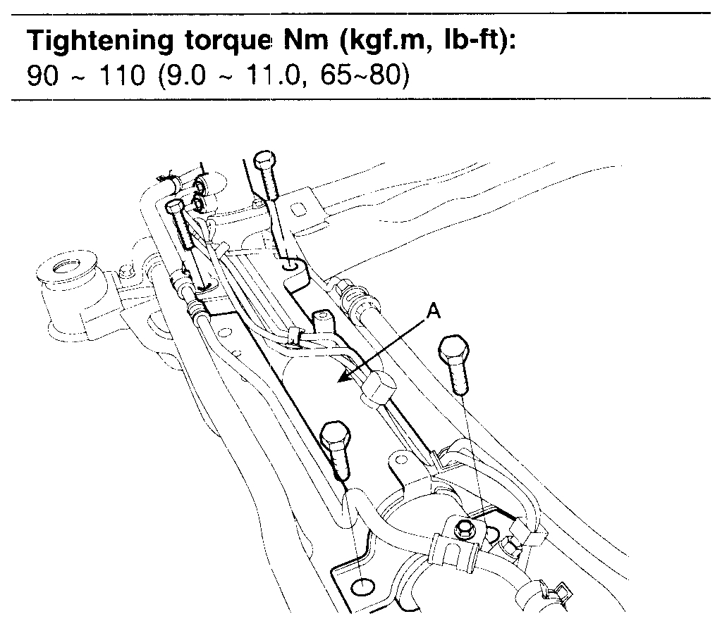

11. Remove the sub-frame by loosening the bolts and nuts.
pic 10

13. Disconnect the pressure tube (A) and return (B) from the valve body housing.
pic 12
14. Remove the power steering gear box (A) from the sub-frame by loosening the mounting bolts.
pic 13
