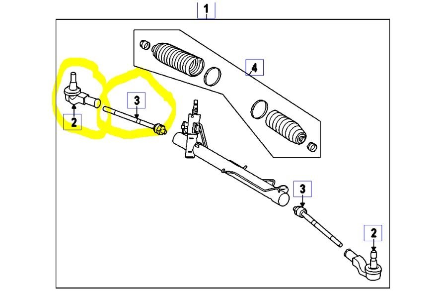

When the car is stationary with the ignition on and turning the steering wheel gently from left to right I can feel knocking through the steering column and in the left foot well. I also have play in the front left wheel in the 9 and 3 O'CLOCK position. I have replaced both inner and outer track rods and also had the wheel bearing checked which is fine. I can't see any leeks on the steering rack but was thinking it may be something internal.

Did you mean the tie rod ends? They are what give you play at 9 and 3 positions.

Yes, that's right. I have replaced the inner tie rods and the tie rod ends as shown in your diagram.
