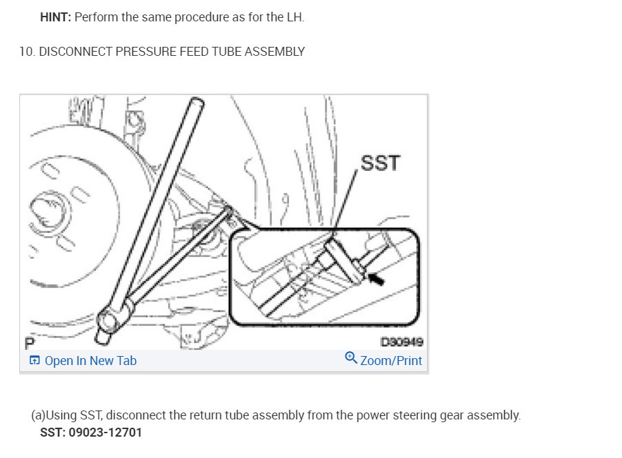

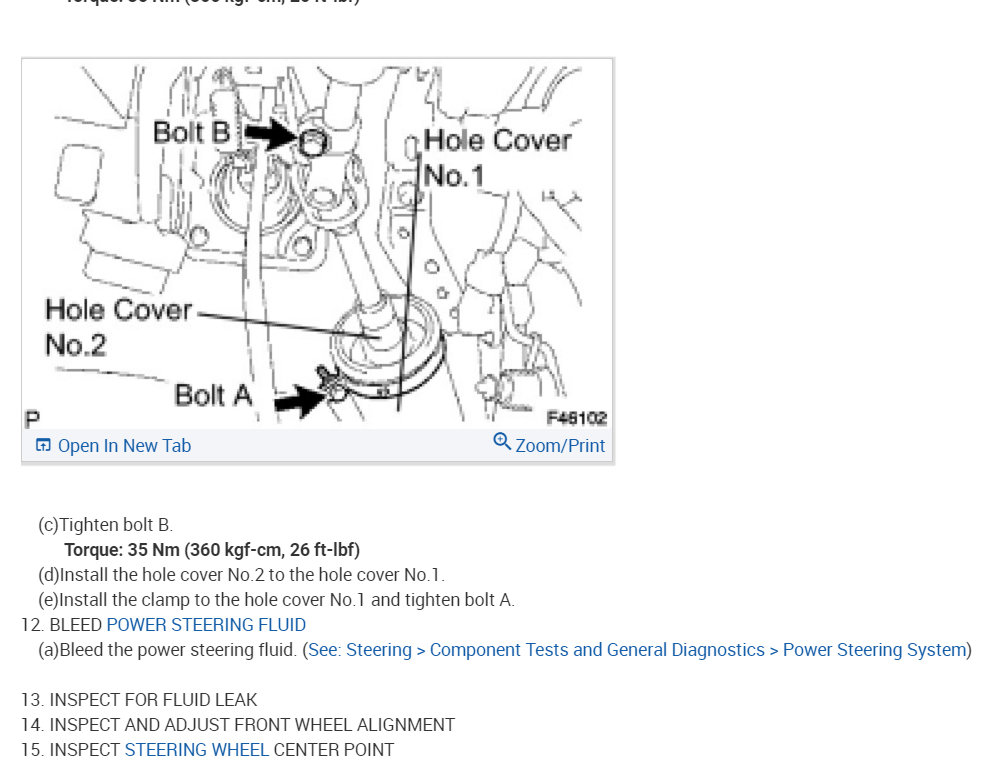

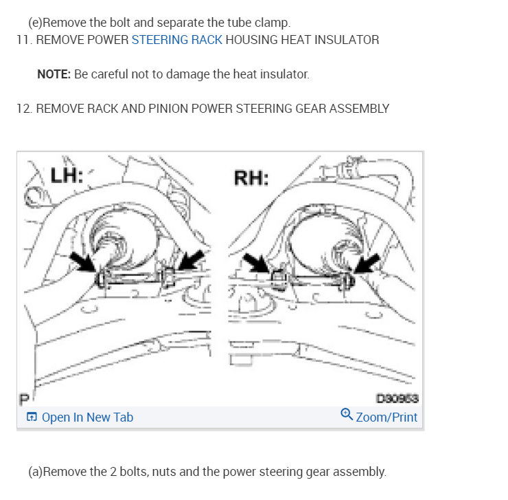

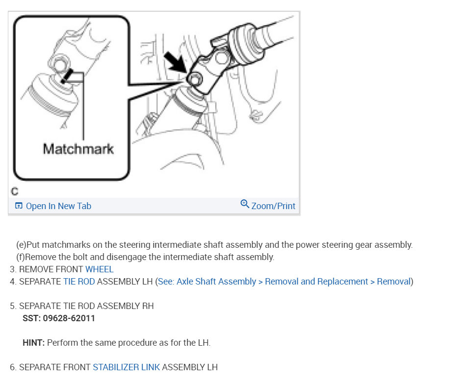

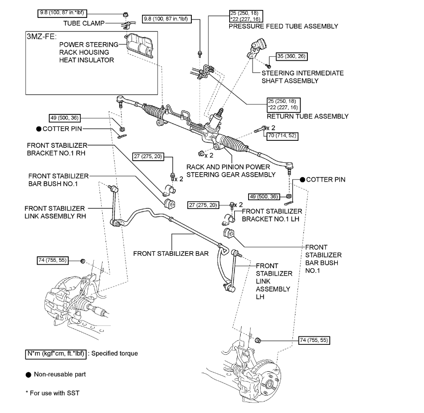

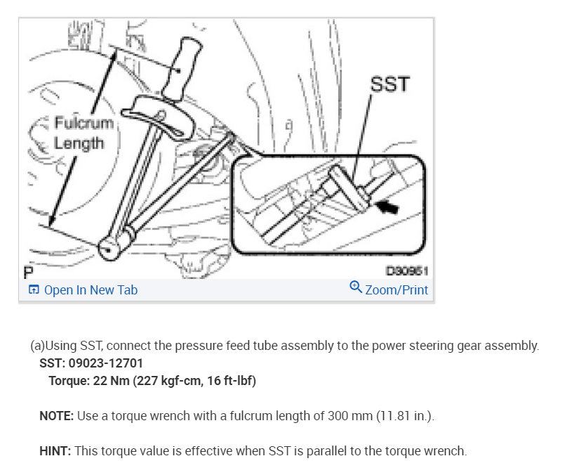

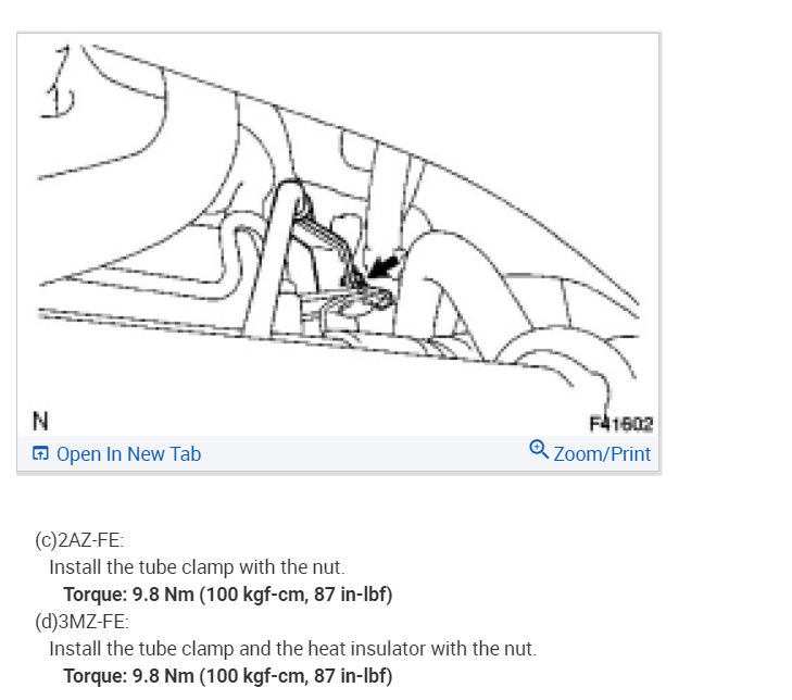

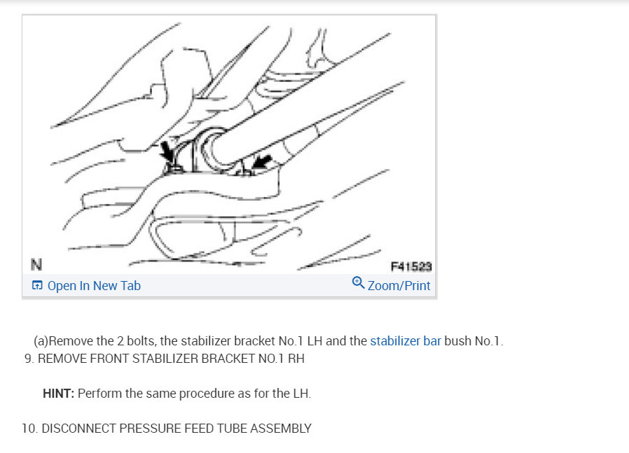

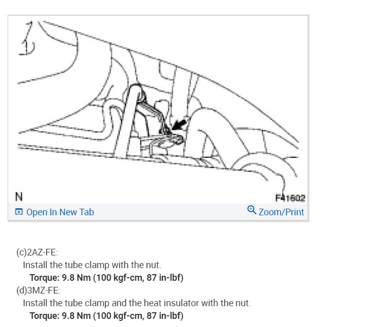

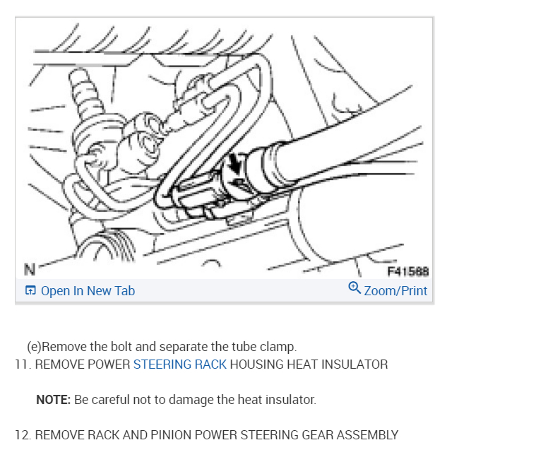

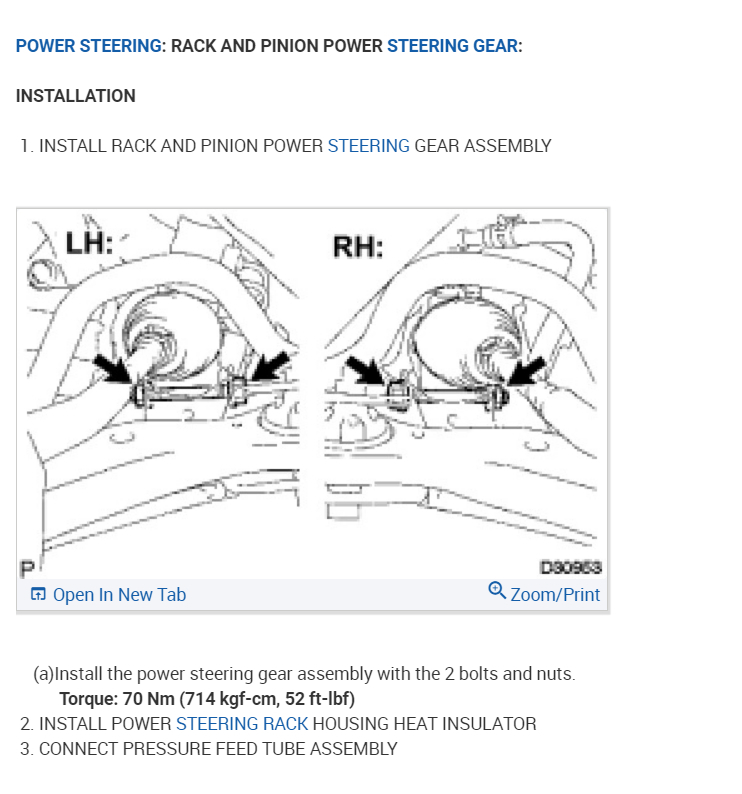

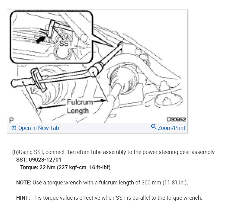

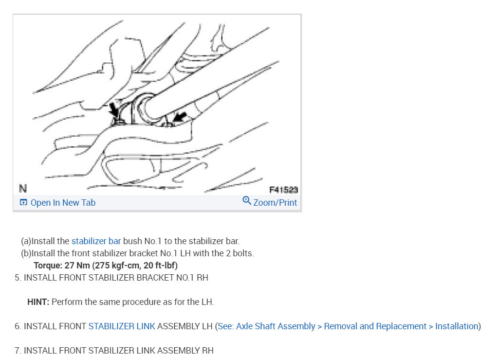

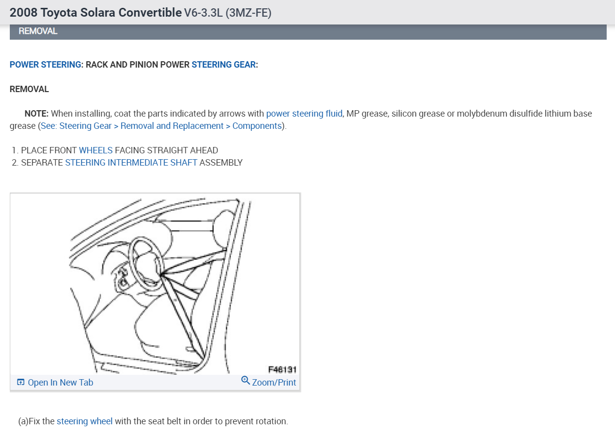

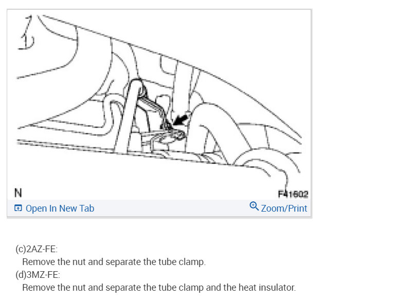

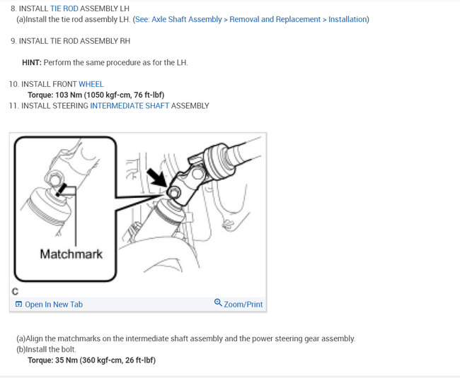

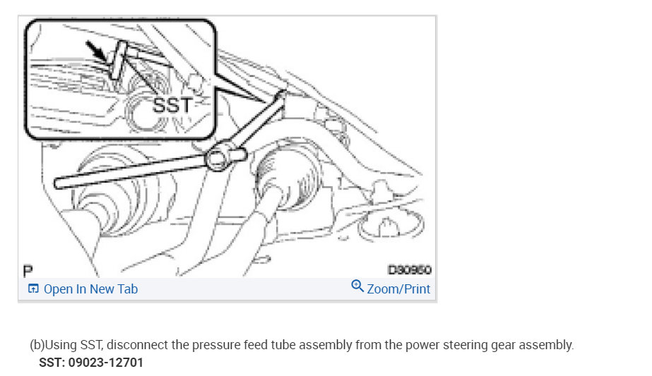

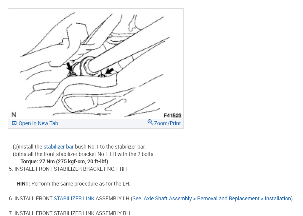

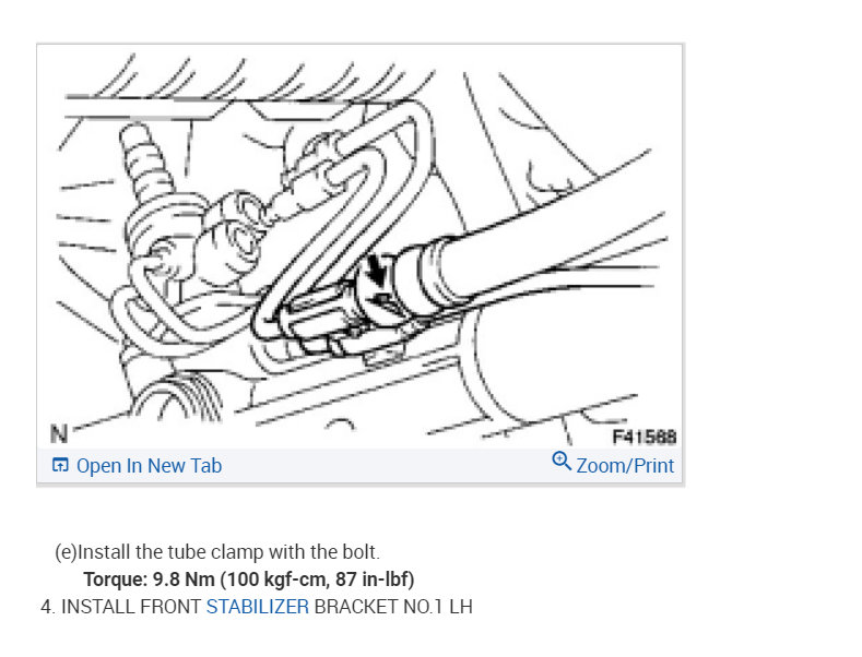

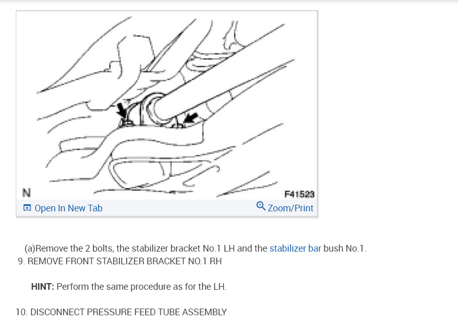

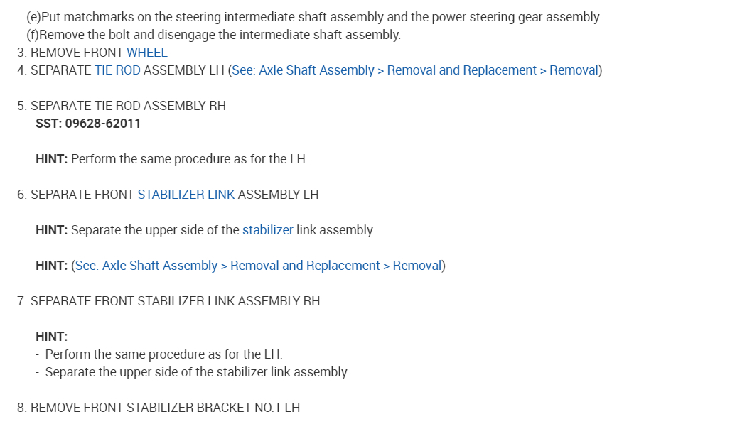

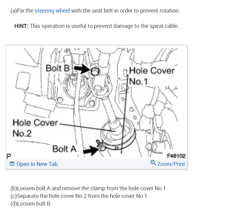

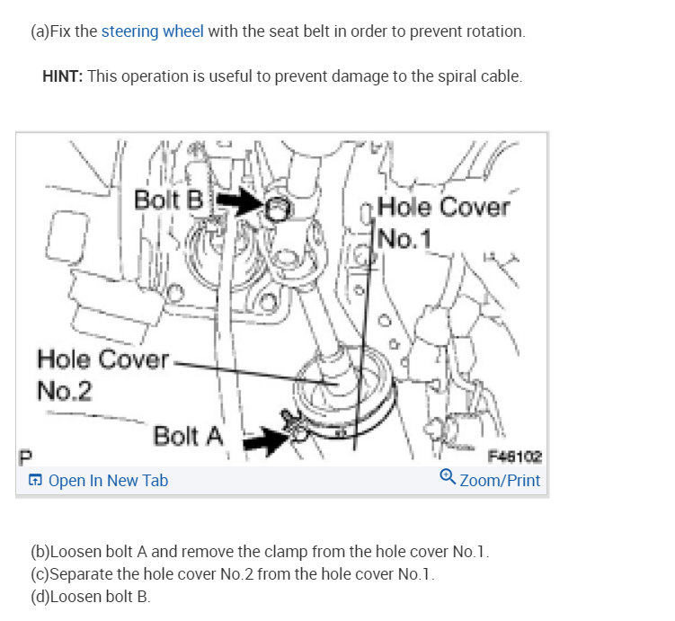

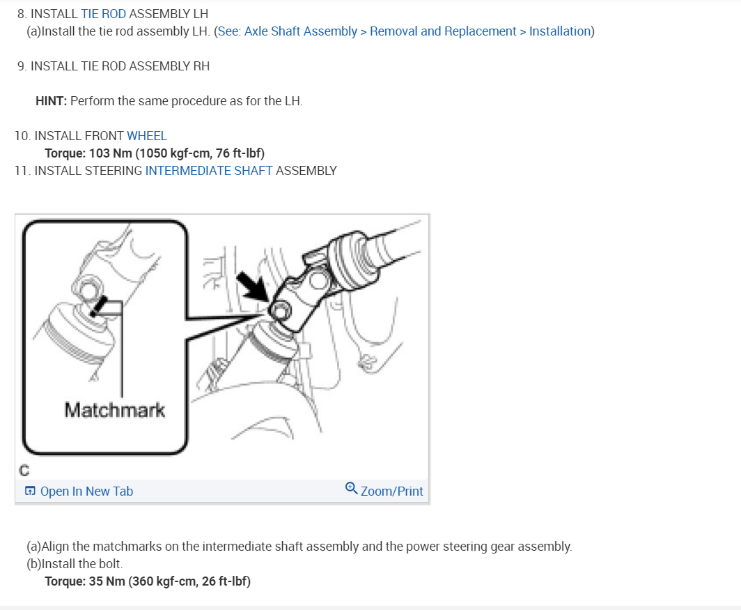

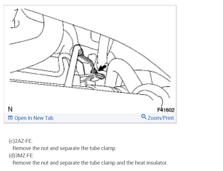

I assume the power steering didn't work before you installed the pump. If so, the rack is bad and needs to be replaced. here is how to change the rack out in the images below. Do not spin the wheel when it is disconnected because you will damage the spiral wire behind the steering wheel. Also, disconnect the battery before you begin, you will need to get the car aligned was the job is completed. Check out the images (below). Let us know what happens and please upload pictures or videos of the problem.
