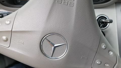

Sending video. when I turn the wheel, it kicks back the opposite way. Whether I'm driving fast or slow or even when I'm parking. Thank you for getting back to me.
Jun 5, 2020 at 9:36 AM
okay, that helps with getting me on the same page as you. Just to confirm you have owned this vehicle for a little while and have felt this get worse or did this happen all of a sudden?
I suspect the power steering pump is the issue or the steering gear. Depending to the answers above we can possibly start with checking the pressure in the system. However, let's take it one step at a time because I don't want to go off in the wrong direction. Thanks
