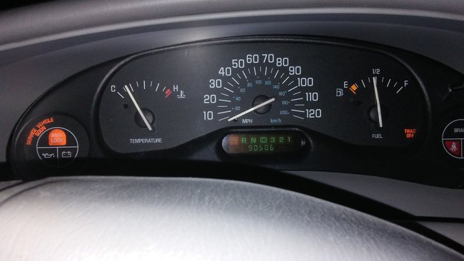

Would that also cause my service vehicle (not engine) abs and antilock lights to be lit on my dash
Feb 16, 2017 at 10:13 PM
EGUNS80
  • 85 POSTS
Sorry Trac off not abs
Feb 16, 2017 at 10:14 PM
MHPAUTOS
  • 31,937 POSTS
A cv would proberbly not cause that, best to get a scan done and post any codes
